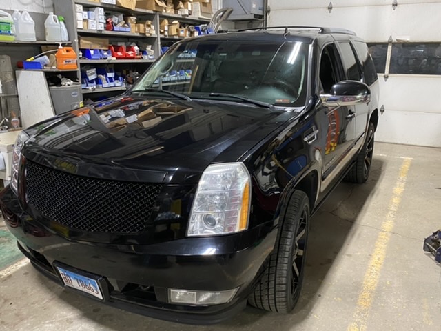

Vinyl is the way I did it

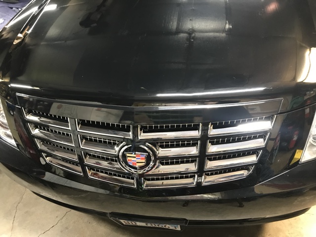

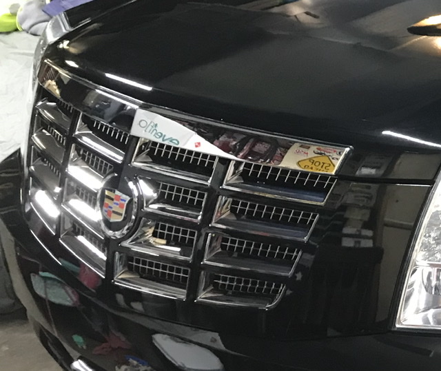

I use Vivid brand, seems to work best for me. Shrinks and stretches nice. Knifeless tape is the best way to trim it in when making cuts on vehicle. Plenty of videos showing how it works. Here’s a couple pics when I did the side moldings.
Snowbound
Jim
Nov 23, 2016
1,058
2,496
Chicagoland (Lockport)
They also sell a transparent vinyl for blacking out taillights which I used for the center high mounted brake light.
You can buy tool kits off Amazon that work really well. Doesn’t take any fancy tools. I use 70% isopropyl alcohol and water mix 60/40 to clean the parts first and a cheap $10 HF heat gun. Doesn’t take much heat to get the vinyl to do what you want it to do. When you get into some complex curves and corners it takes a little more practice but that is all learned from mistakes and practice. The hitch cover was one that tested my patients but I got it eventually. I don’t have a picture of it completed for some reason but you can see how this was a tedious job getting the vinyl to stretch and shrink where I needed it.
Just take your time and buy more vinyl than what you need because you may end up screwing up and starting over or you may find more things you want to wrap.
