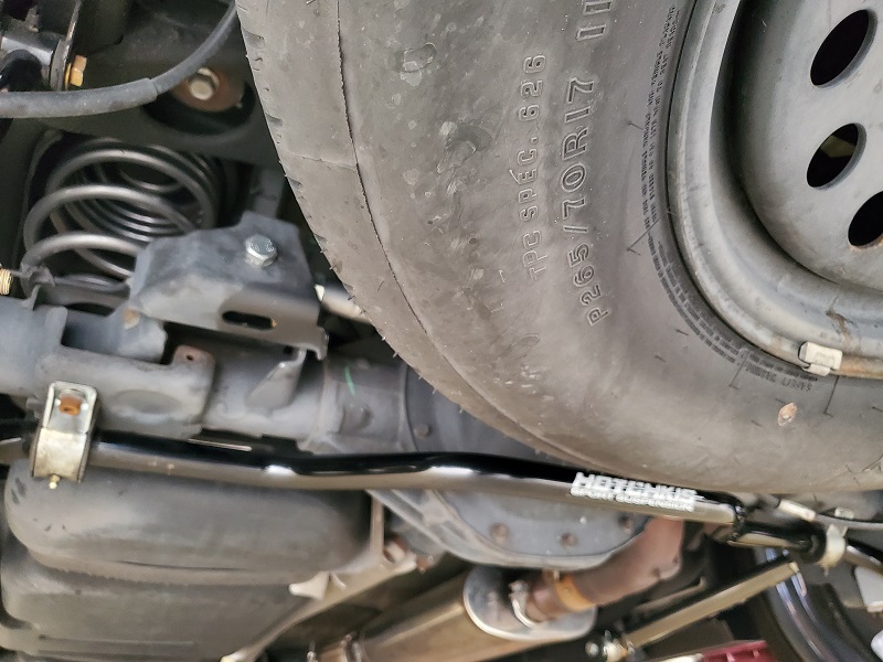

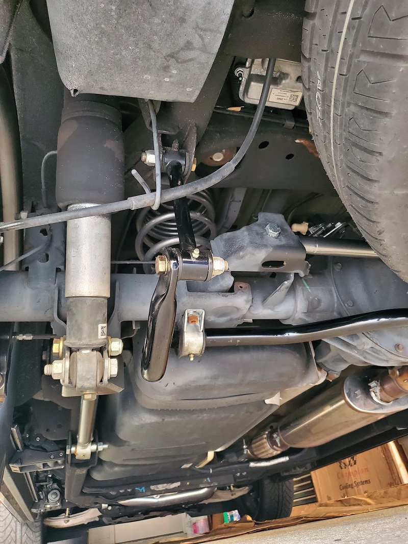

I don't remember now but I want to say end links did not come with the kit. It's been over a year since I purchased and installed it. You might want to call Hotchkis or Summit to confirm what comes with it.
I am very pleased with both the Hotchkis sway bars and Spohn components.
View attachment 231043 View attachment 231044
Any touque specs or just tighten with lock tight
Staggered 02
Jul 5, 2019
672
1,556
Tighten with loctite should be fine. I've installed Hotchkis sway bars on ! half a dozen vehicles 4 of which I still own with no issues.
