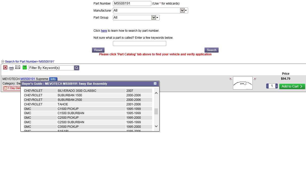

front 36mm $143
for 2500 so (maybe) front 36.2mm $94
fitment guide says it fits 00-06 1500 silverado which is the same as any other 1500 gmt800

Thanks for the responses. I saw both of those. The picture of the Mevotech you linked to looks nothing like our swaybars. If you look at the interchange part number, it matches a Chevy Astro with RWD. If you look up other pictures of Astro swaybars, they match that picture. So there is a mistake somewhere, honestly don’t know where. Is there a chance an Astro swaybar fits our trucks? They are different sizes, so it seems unlikely. The Dorman unit fits 2wd 1500 pickup trucks, which is different from 4wd pickup trucks and all SUV’s. Don’t know about the 2500 trucks. In any case it is a different shape than ours- it doesn’t seem likely it would fit but I have never tried or seen one in person. I might have to bite the bullet and talk myself into coughing up the $$ for an aftermarket set....
30,706
48,357
can't always rely on photos of sway bars online, they tend to just throw a picture of whatever they feel like on and then usually a disclaimer somewhere stating the photo may not match the actual item, cheaper on rock auto anyway.
according to rockauto 1500 & 2500 sway bars crossover, rock auto tends to not always list all compatible vehicles, for whatever reason.....
