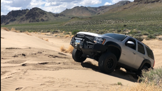

I don't think you will get 37's in there without doing some cutting. I am running a 4 inch lift with 35's and with a steel front bumper I have plenty of clearance on the front and the rear only rubs when I hit large drops while turning.
I stuck with a 4 inch lift to keep things simple and I still wanted good street manors since it is my daily driver as well as my overlander. For what you are doing a 4 inch lift should be enough. The Rancho 4 inch lift I have works great and the RS7000 suspension is very smooth even when running 70 mph plus in the desert. I love getting this thing airborne and it still feels solid. Off road it does very well and it has lifted a wheel off the ground more than once. It has been to Rubicon, all over Moab and in the deserts of Az and of course all over Nevada
Mine is the farthest thing from a Tahoe street queen you will ever see. It gets dirty and has a lot of Nevada pin stripes on it from the trees and bushes and even a few dings here and there...
The down side... Rancho stopped making this lift kit for these since not enough people want to lift them...
