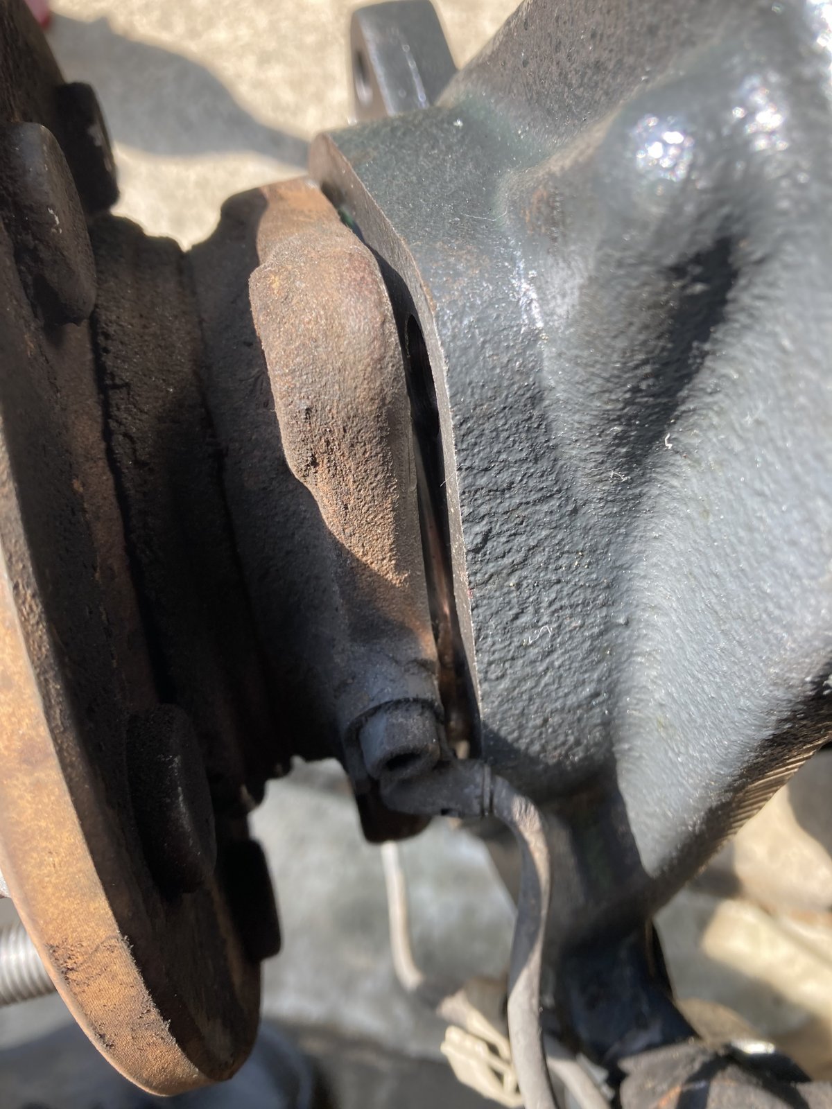

Another problem I had installing these was mine were not clearanced for the speed sensor and I had to grind notches in the damn things which pssd me off. I have yet to hear anybody else having to do this on their installs.
You also have to cut the ball joint studs down and even then there is barely enough clearance to clear the wheel if you are running 17”. I also just noticed last night during an inspection I have a slight rub mark on of the CV boots from the upper nut.
