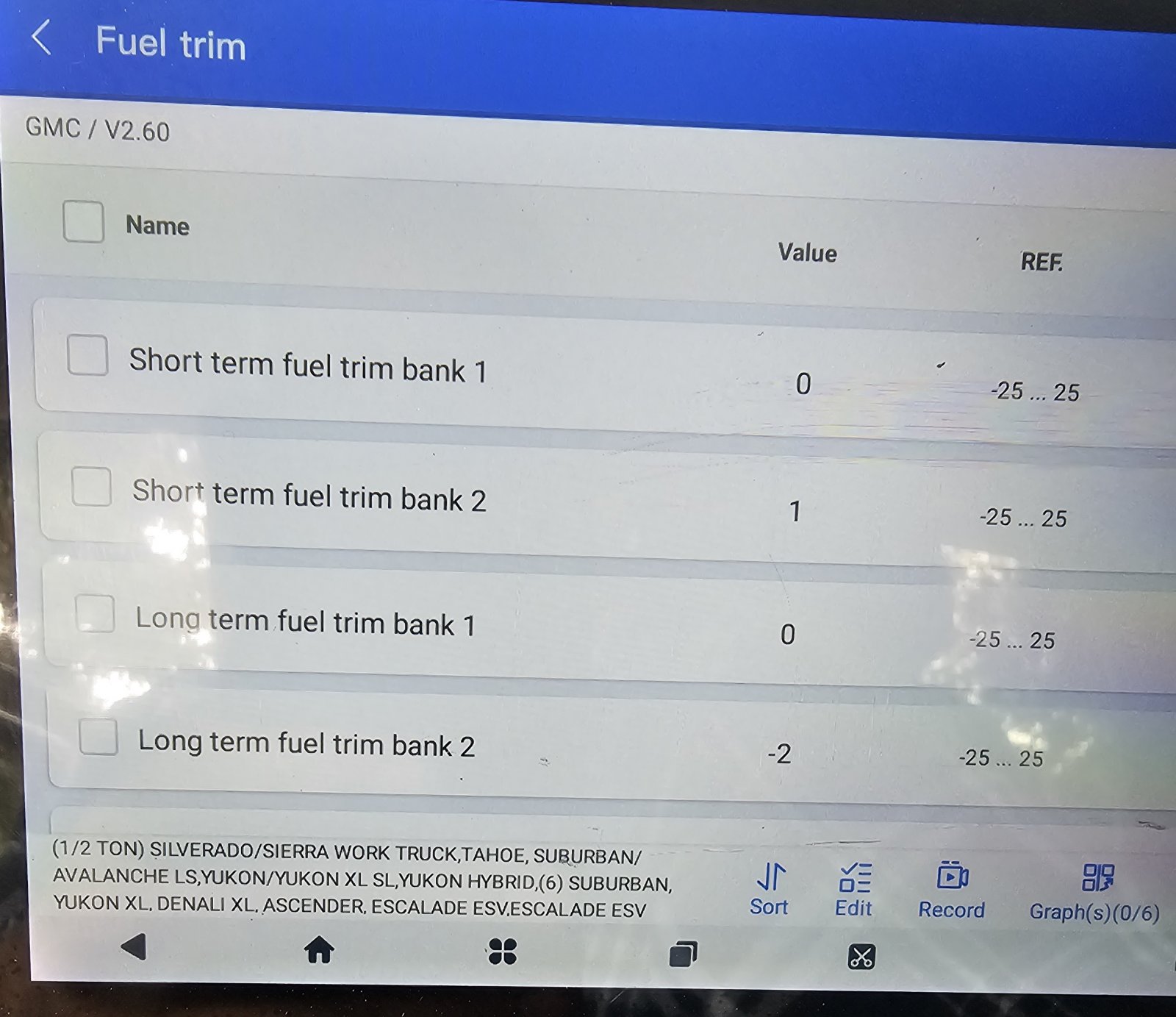

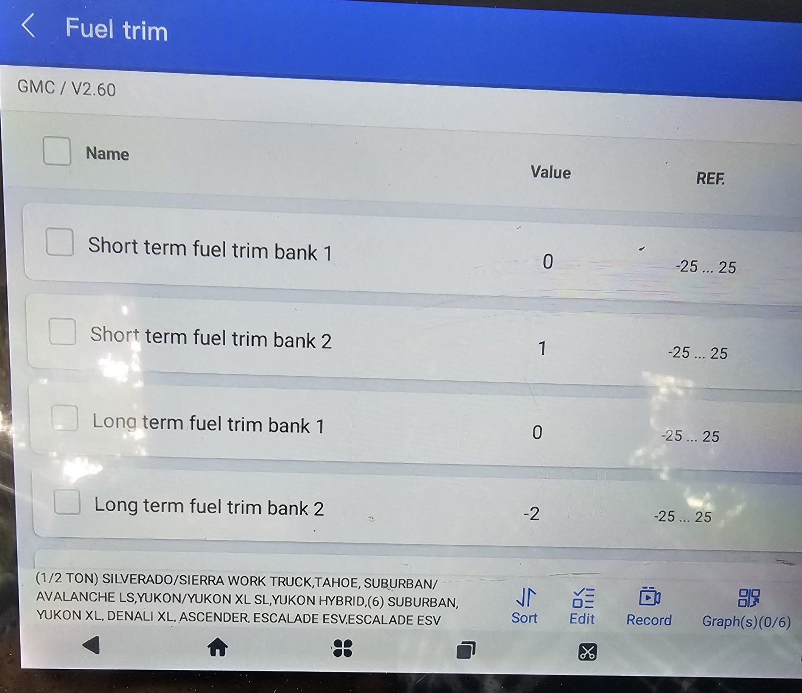

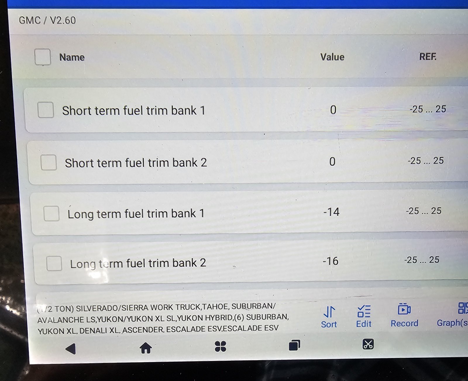

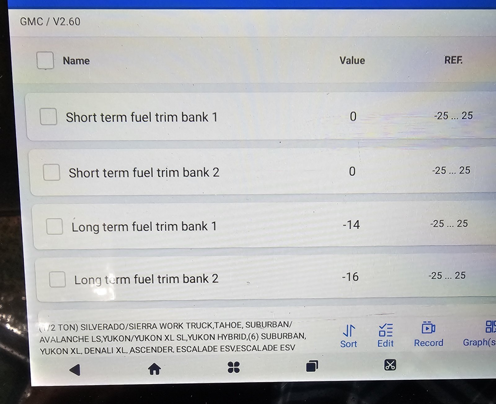

Here are the fuel trims before the intake gaskets were changed.
And after the gaskets were changed. Drove it about 15 miles and this is idling in driveway after drive. During the drive, they did not very much that i saw. So success!

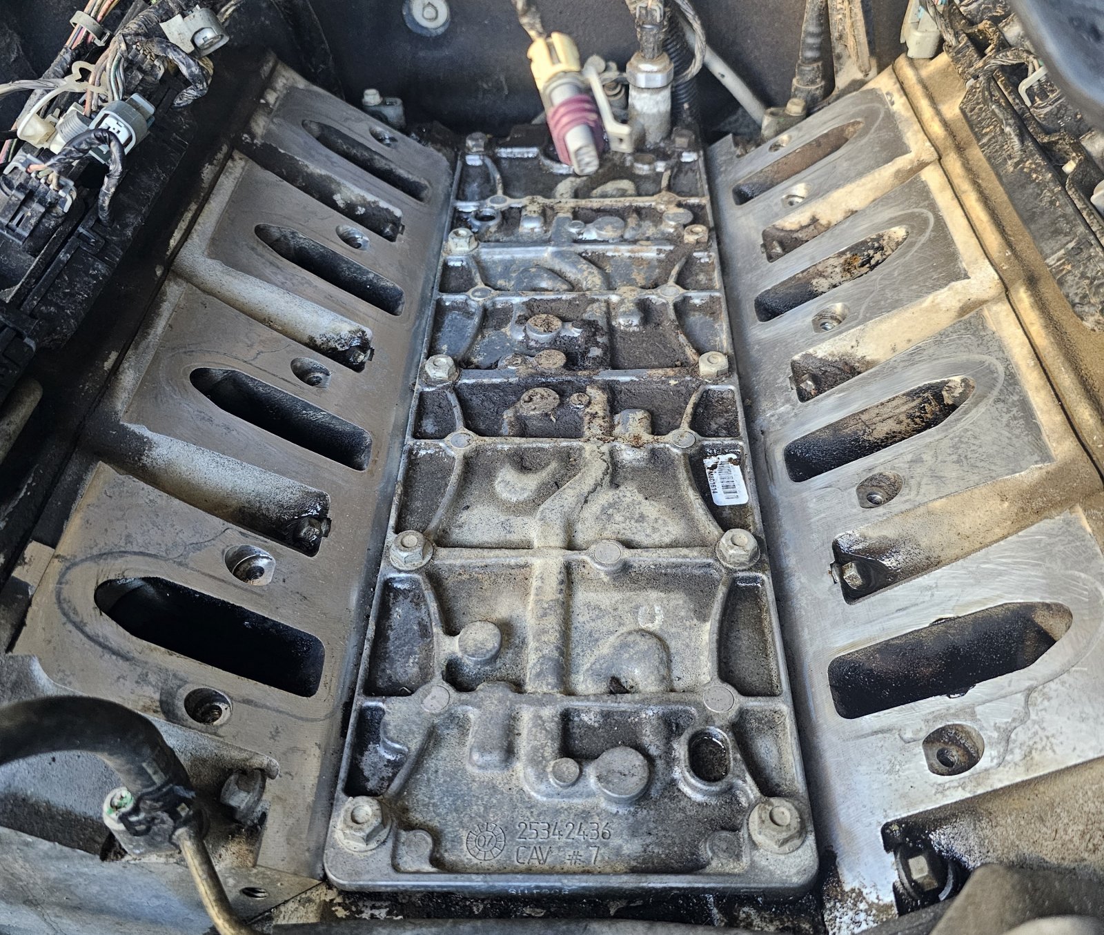

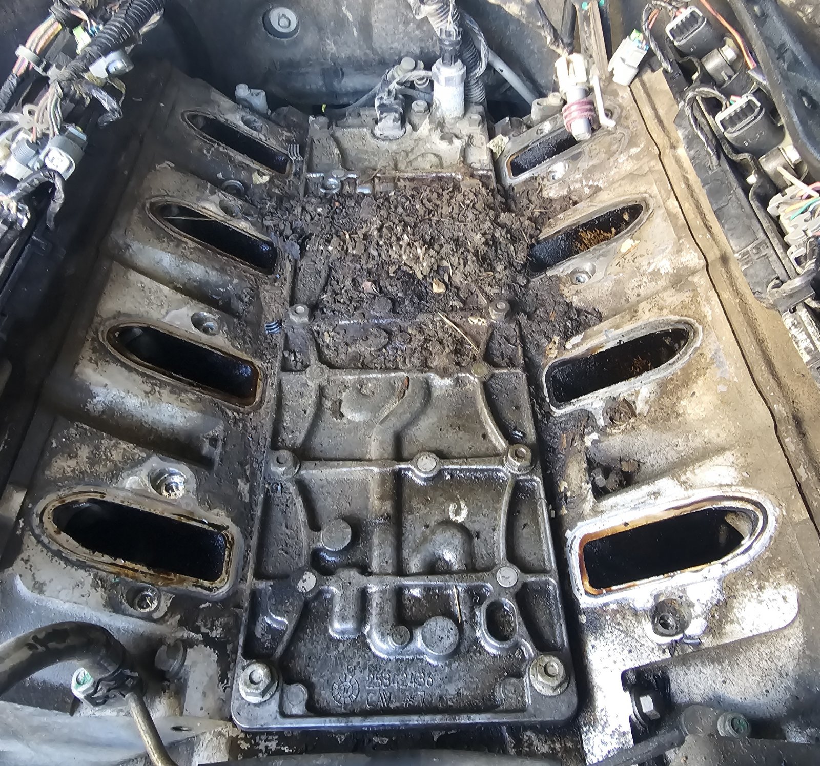

After removing intake.
Ready to install intake

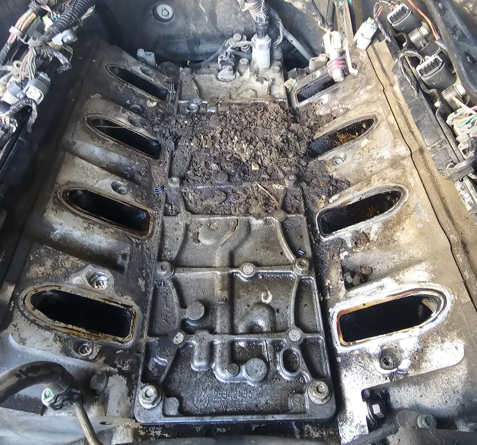

And finally,

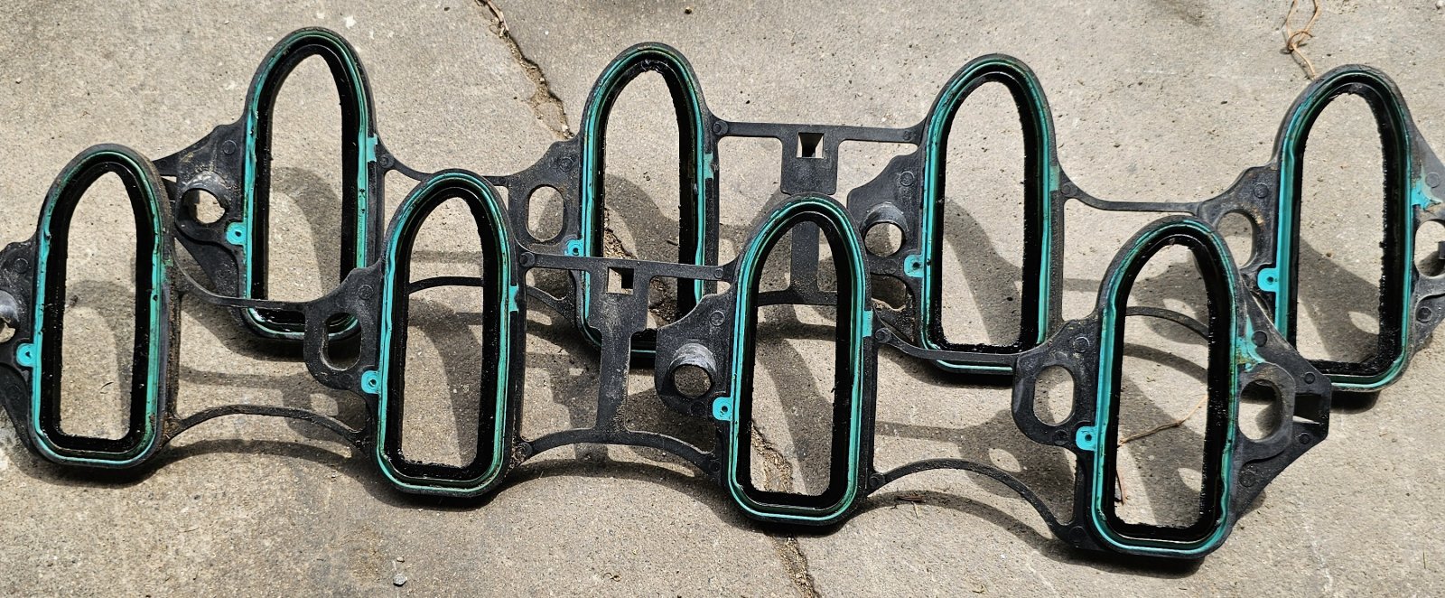

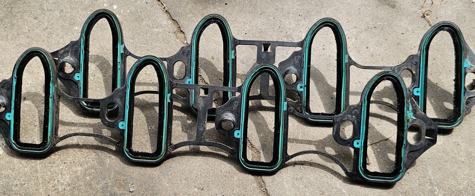

the old gaskets.

I could not find a used MAS at the wrecking yard to try so i took the MAS off my car and installed on the friend's Yukon and mine read exactly the same as his.
So i have to assume they both are good. Leads me to believe his MAS is not a problem.
His Yukon is running GREAT now, but i don't know if this has cured the randomly dying problem.
Could have been a totally different issue, meaning he originally had two separate issues.
I have not experienced the dying issue but will drive it some more today and tomorrow.

And finally,View attachment 464282 the old gaskets.
Intake gasket does look messed up.
But the ECU was subtracting fuel (-25) because it was getting too much fuel, not enough air.

I don't really understand the whole way it works, but unmetered air will cause negative fuel trims. Seems backward, i know, but the proof is in the readings.
The ECU was subtracting -14 and -16. The 25 you see is not the reading
That’s bad. Like damn.

Looked kinda like the rear foam dam was all melted and disintegrated. It all cleaned up good enough, but i was not trying to get it sparkling clean.
Unmetered air causes a lean condition, and the ECU ADDS fuel (positive fuel trims) to compensate. Negative fuel trims means the ECU is taking away fuel, which is a rich condition.
EDIT: I can't remember if disconnecting the battery will reset the LT fuel trims on these engines, but that could also be. Obviously they'll constantly recalculate over time.
SpareParts
SpareParts
Sep 17, 2023
2,113
4,805
North Idaho
Right.
But as you can see above the fuel trims were -14 and -16 in the pic earlier. After changing the obviously bad intake gaskets, the trims are near 0.
The fuel trims were reset both STFT and LTFT before firing it up and have driven it around 30 miles or so, it will stay near what the trims are now im sure.
Is what i think was happening was because of the intake gaskets leaking it was causing the MAF to underreport. Reading was 4.7 g/s(ish) at hot idle. Too low causing the ECU to take away fuel.
After gasket change, MAF is reporting 5.3 g/s(ish)More accurate and about what it should be at hot idle.
