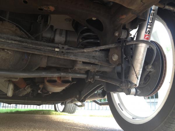

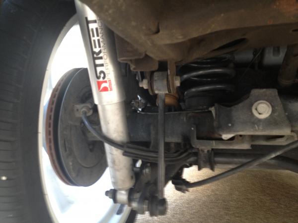

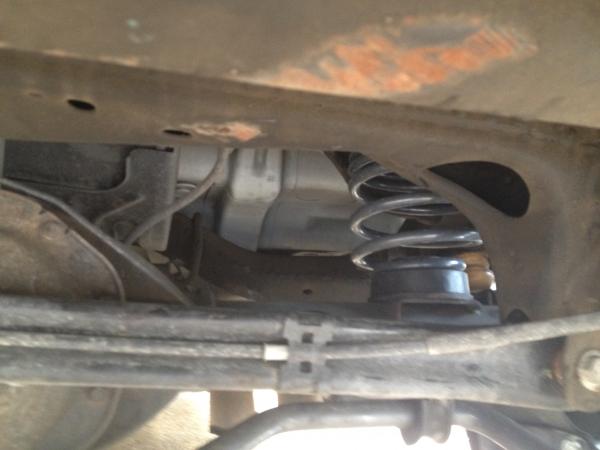

thats the thing i have the spacer installed....
here ill get a picture of under the truck...

Can't really tell but it looks like you're riding on the bump stops and your driver side spring is not seated properly. I'm also willing to bet those swaybar links are hating life right about now and will probably bend or break in the near future.
When you go back to install the endlink kit, trim the bump stops. That might help.

well those are the belltech bumpstops..... idk if they get any shorter i think theyll compress enough to hit the frame..
so maybe ill finish up the kit and get back to you guys...
and maybe cut the bump stop after that...
EDIT: cut the bump stops now if i go over an intersection i get a real loud clunk.. luckily I have spare belltech bumpstops WOOO
