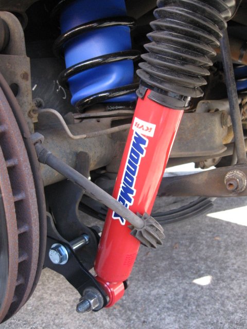

I just installed the MonoMax shocks on my 2001 Tahoe. Like them so far. Been about a month. They got rid of my death wooble, Smooth ride and handles good. The MonoMaxx shocks are made and designed for trucks. Got a great deal from Rock Auto and got a rebate too. Oh and the best part is they are cheaper than the KYB's and others.
