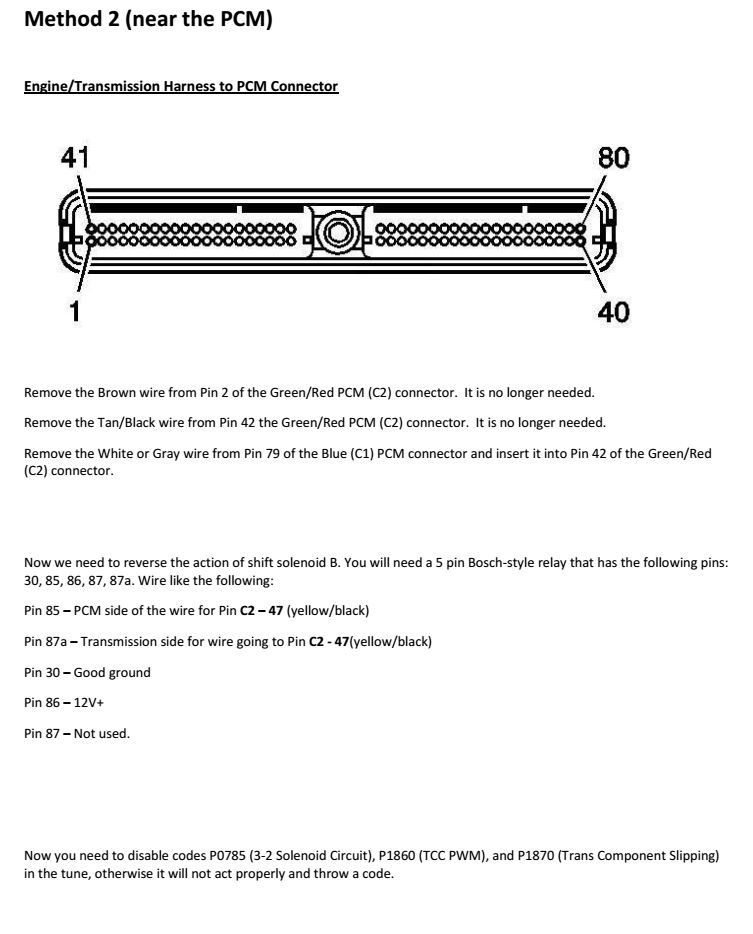

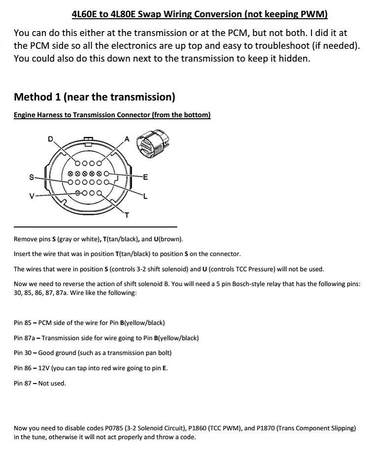

Here is the wiring info you will need...
http://www.performancetrucks.net/forums/gm-drivetrain-suspension-22/4l60e-4l80e-wiring-swap-413157/.

This might be helpful.
