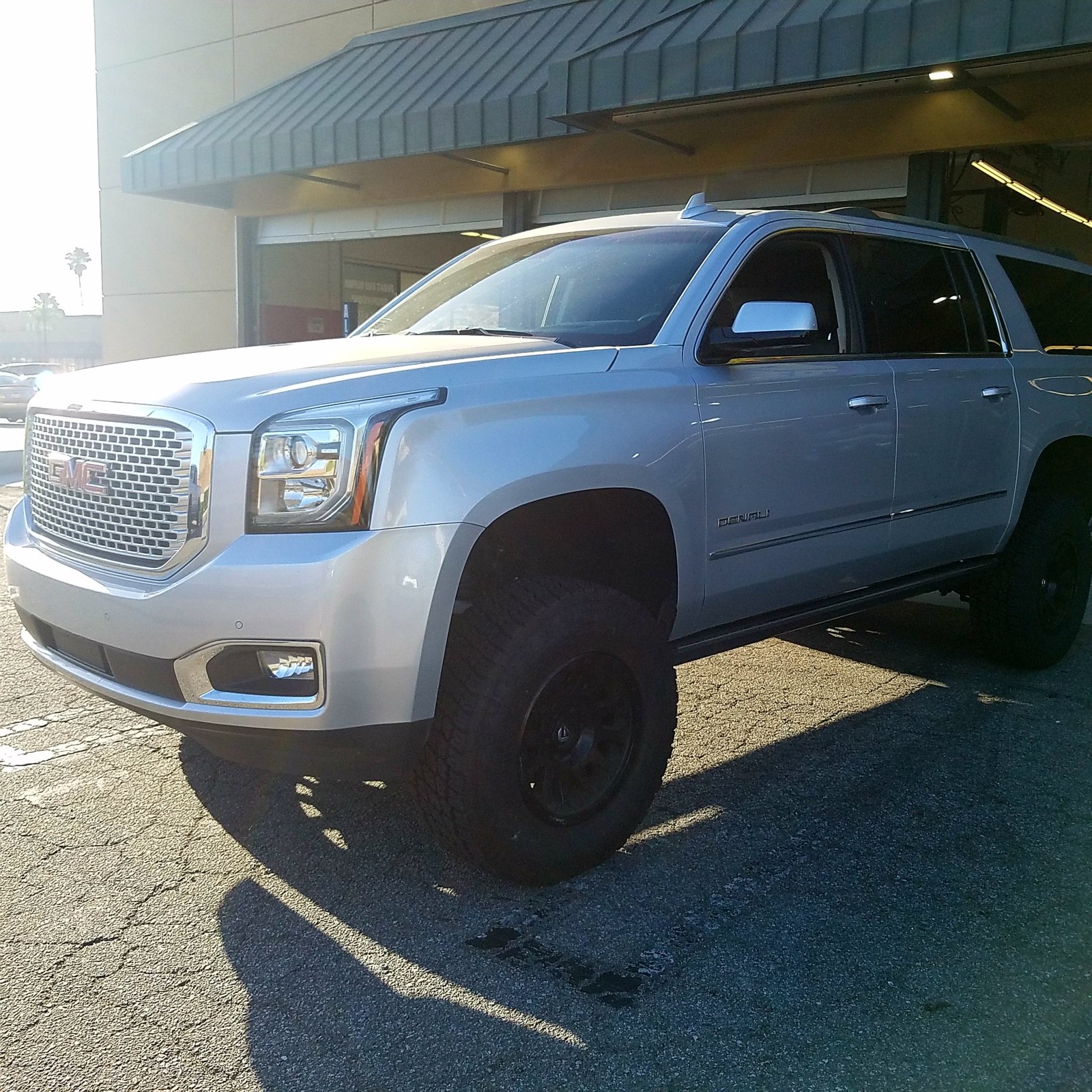

just lifted my 2016 yukon denali 6 inch kit from fabtech today with 295 70 18 i went up exactly 8 inchs now the kit it bigger then 6 inchs call fabtech they will explain, I had the budget 4 inch lift from fabtech I hated that it only have 3 inchs of lift now I love the way it looks stay tuned will upload more pictures soon
Adam10532
May 29, 2017
141
52
with my 18x9 fuel vector wheel +1mm offset i just had to trim the corner of the airdam and no rubbing
