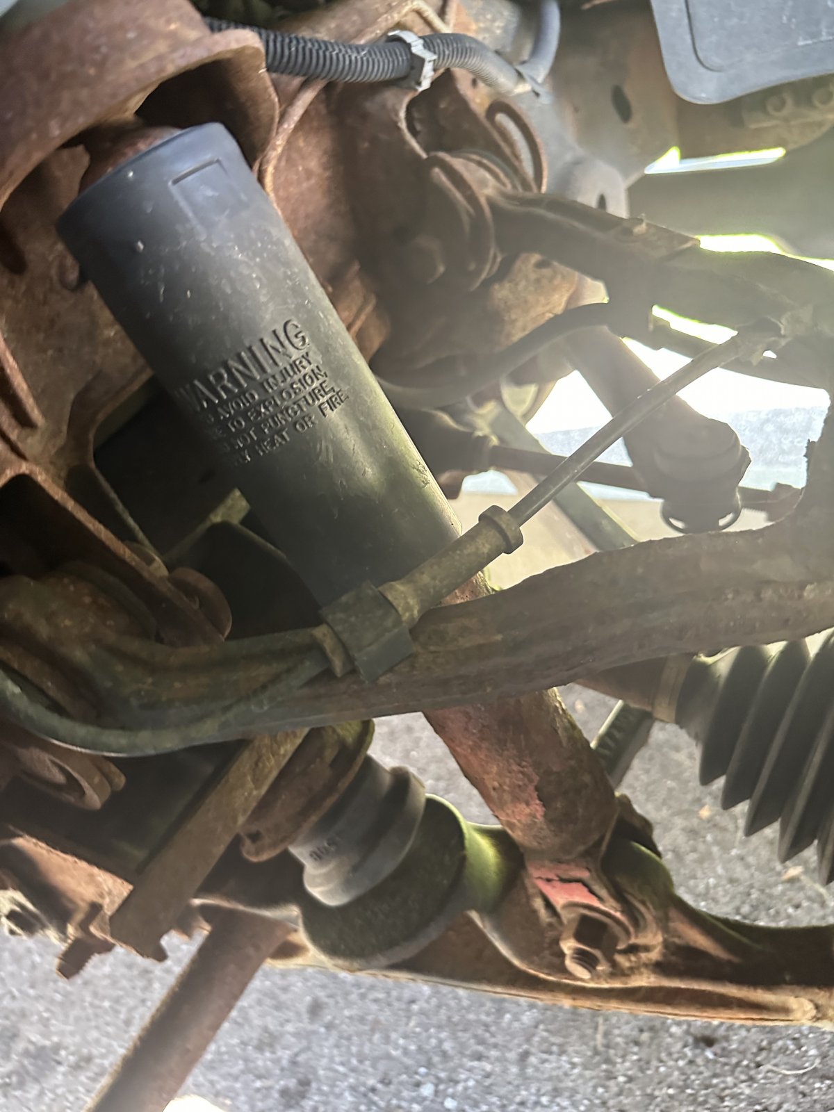

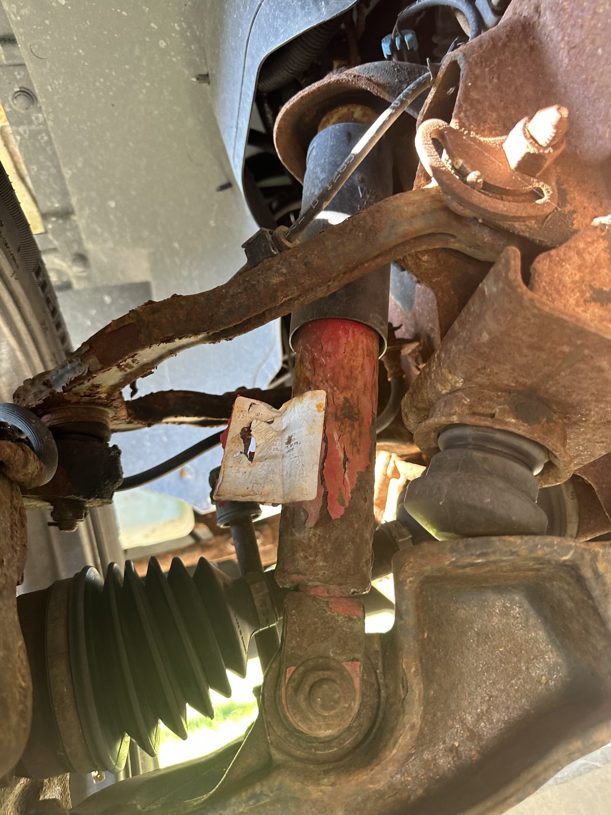

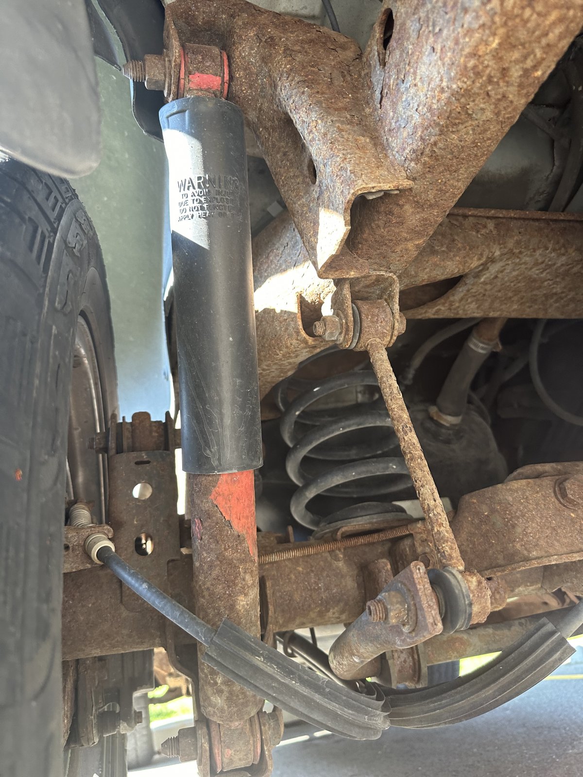

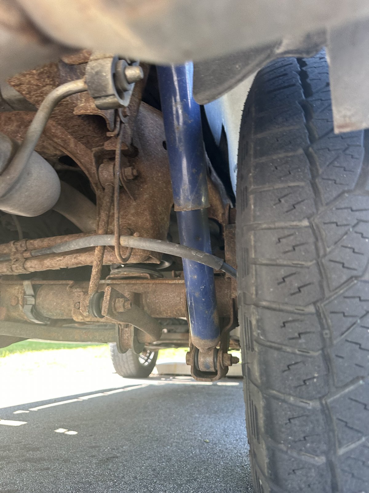

Here are some pics
Front drivers, rear drivers, rear passanger, front passanger

I doubt it will rub if it does you could probably just crank your stock torsion keys up to get another inch or two but may result in a rougher ride that’s why it’s better to get leveling keys and leave them uncranked.
Those 13 piece kits are usually Detroit eBay or cheap PoS kits and if you plan to keep this thing for a long time I’d opt for ac delco or kryptonite suspension parts (kryptonite being the best I’ve used on these trucks)
It’s expensive but a one and done type deal

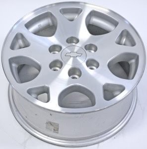

Also if your looking for “snowflakes” for those tires they don’t make smaller then a 20” snowflake rim unless your talking about the snowflake looking rim that comes on the colorados which I believe are 17”-18” rims
On the 99-06 all my buddy’s ran 35/12.50 mud tires on stock rims and still barly rubbed with lift keys if anything I think they would rub on the control arms more unless a small wheel spacer is used (1/4” or so) which isn’t no big deal
Other rub spot is the inner cab corner which you would do the NorCal mod to gain Clarence
Again I highly doubt the 33” tires will give you any issues all my crowd would run 35s and my one buddy we were able to fit 22x14” wheels on 33/12.50 tires with a leveling kit and a body lift and it cleared full lock all day long
Again front end parts if your keeping it go with kryptonite if not expect to be changing it again in no time…

The snowflakes I’m talking about are the 17” snowflakes that came on the nbs Tahoe, suburban Z71 models as pictured here
