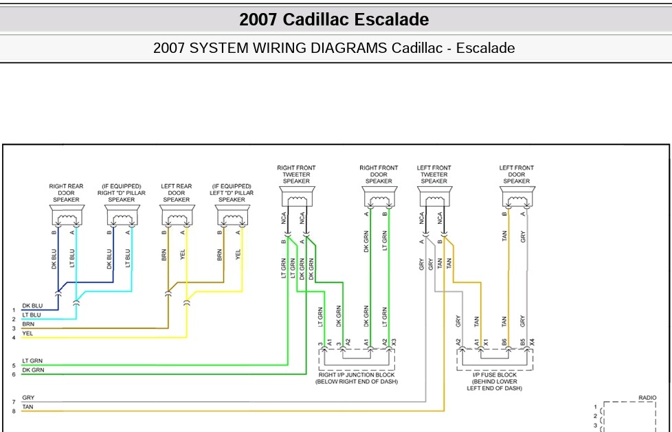

anyone have an idea on where the speaker wire leads split, between door and pillars? for both frontdoor/a-pillar and rear door/d-pillar pairs?
I bought a new set of components and if I could I want to keep the stock wiring and hook up crossovers to where ever this wire split happens.
kbuskill
Mar 11, 2017
5,825
9,836
NE. FL.
It looks like the front speakers wiring splits at the end of the dash board. If you look there is a panel on each end that pops off.
The rear wiring doesn't specify so my guess would be maybe under the carpet somewhere.
