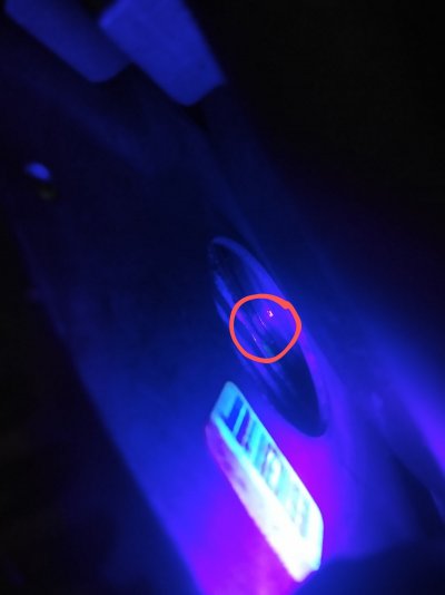

Put some dye in the oil, take it for a spin, then crawl under with a black SUV light. I struggled to find mine. Started replacing everything from the top, down: valley cover gasket, camshaft sensor, confirmed the oil pressure sensor wasn't leaking (and I had already replaced the oil pan gasket.) I'm a Gen III BTW.
It wasn't until I added the dye, and even then it was hard to see.

I found a photo I took on my old laptop. I just emailed it to myself. I will post it. Maybe it will help you where to check...hang tight.
Edit: here it is. I believe I had to rotate the flexplate so I could shine my light through the flexplate holes. It still didn't really come out clear on the photo...

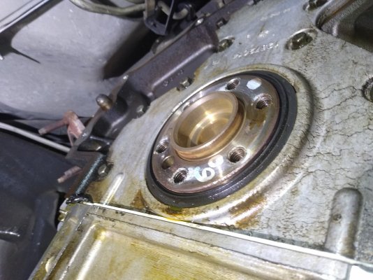

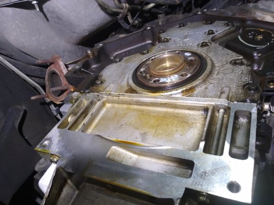

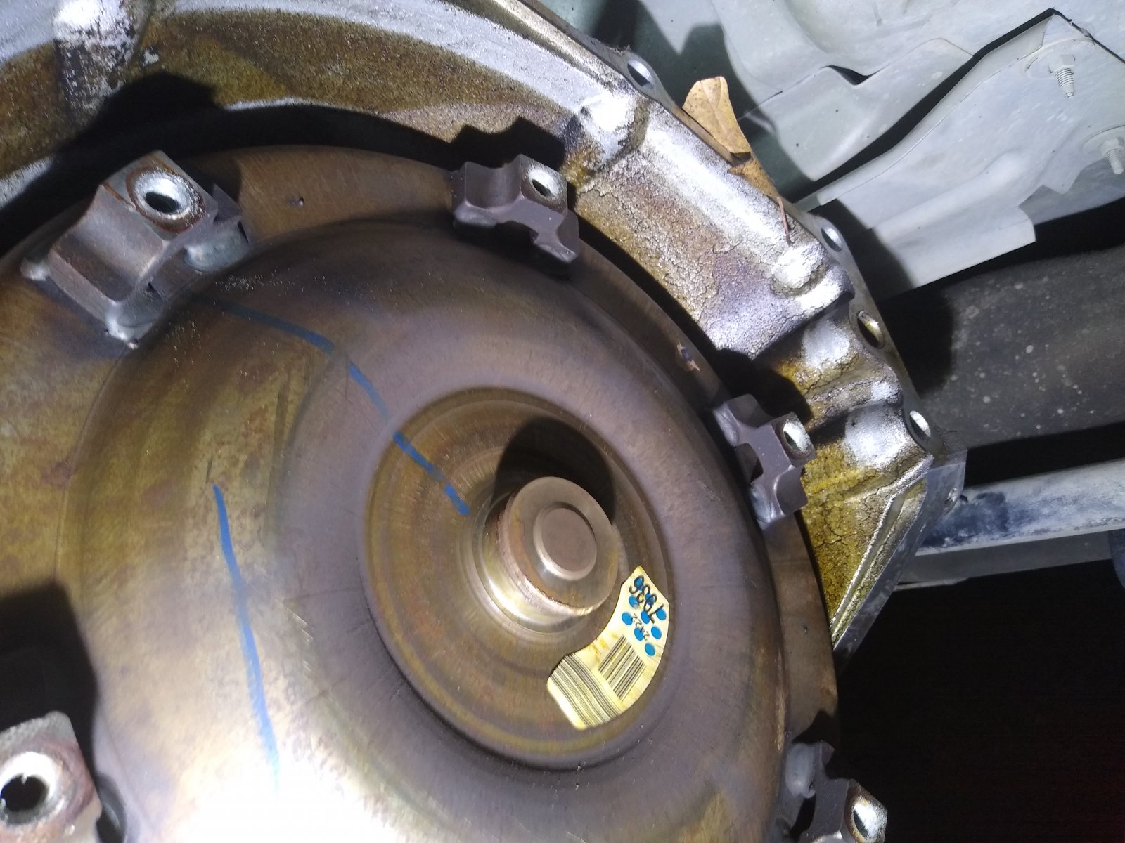

I found more photos after I had removed the transmission and flexplate...
To clarify, I called it the "rear main seal" (RMS.) I guess it's technically the crankshaft flange seal. The RMS cover has a metal-clad gasket, which usually is not the culprit. I refer to both gaskets/seals as "RMS" since the kit has both pieces.
