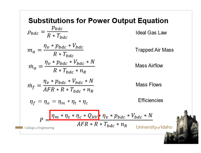

https://view.officeapps.live.com/op/view.aspx?src=https%3A%2F%2Fwww.webpages.uidaho.edu%2Fmindworks%2FIC_Engines%2FLectures%2FLecture%252007%2520-%2520Relationships%2520Between%2520Parameters.pptx&wdOrigin=BROWSELINK
See equation on slide 4.
nv is VE, Vbdc is engine displacement, AFR is air/fuel ratio.
For the power required to execute part load manuever, it is same because it is essentially the same mass.
The difference is engine displacement. The argument at hand is if the 6.2 can do this at higher AFR vs 5.3.
Based on that equation, if you assume VE is constant, the 6.2 can have higher AFR and make same power because the Vbdc term is increased.
So moving the mass up an incline, or into headwind, or tip in acceleration, for instance, the 6.2 can reach the required P on lhs of equation at higher AFR than 5.3 assuming throttle position is constant.
But, if 5.3 increases Ve via throttle, it can reach the required power. However throttle position and AFR are linked together inversely. So the 5.3 has to move to a lower BSFC area on its BMEP vs BSFC curve. This is in rel world represented by the fuel tables and shift schedule.
So the smaller engine will have a harder time keeping fuel consumption minimized in part-load conditions.
This is my point.

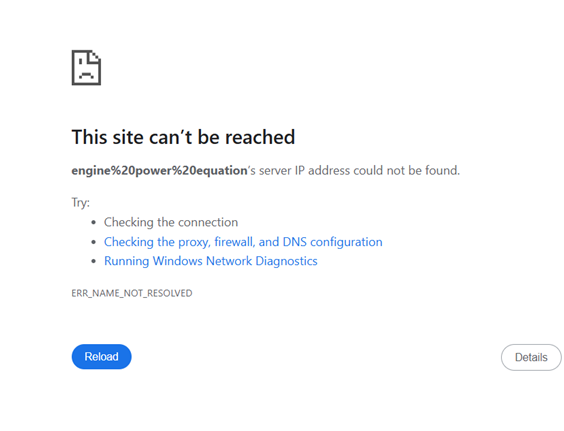

OMG are you a moron. Throttle position alone does not, repeat not, decide what the AFR is all by itself, the PCM and its ability to change the amount of fuel delivered gets a vote too in what the afr is .
You can have the same afr at just about any throttle position if the tuner decides that's what they what. And the factory calibrations have it as lean as they can safely get away with for CAFE standard / catalytic reasons.
Yeah during tip -in throttle they PCM commands more fuel, otherwise the engine would bog (basically the PCM is performing the same function as a carburetor accelerator pump did back in the olden days), but the OEMs want that AFR back to as lean as they can get it, as quickly as they can get it, for those all important fuel mileage and catalytic converter longevity reasons, so it doesn't stay rich for long.

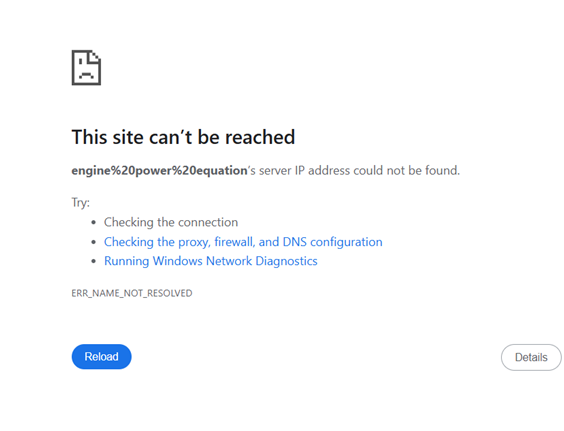

And BTW, your link doesn't work.

Link fixed.
Let me summarize.
Power = efficiency factors x Heating value of fuel x VE x displacement x rpm/(afr x constants).
So a 5.3 makes less power than a 6.2 at the same afr.
slide 4.
This is a rearranged formula from Heywood text on combustion engines.

I think maybe when you fixed the link you directed it to the wrong paper. Because nowhere in the paper you linked (the paper done by the EPA titled "Characterizing Factors Influencing SI Engine Transient Fuel Consumption for Vehicle Simulation in ALPHA"), does it ever even mention the term air-fuel ratio in it,,, anywhere , not even ctrl+f could find that term in the downloaded pdf, so its not like I skimmed over it.
Here's a copy past of the slide 4
blanchard7684
Senior Member
Dec 23, 2024
442
379
This link below is what I was referencing. slide 4.
One of the many links I've provided.

And just as I suspected, you are in fact interperting it wrong.
Here's the slide four you think proves what you're talking about. That bottom equation for power does have afr in it, but notice where that comes from (see red boxes in equation above it).

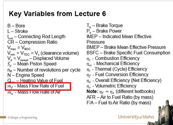

Now lets look at the definition of terms slide in that same presentation;
So, that AFR input is part of how the mass flowrate of fuel is determined,,,pretty sure I've mentioned earlier that power comes from the fuel,,, your eureka moment equation is using AFR to determine how much fuel has been added.

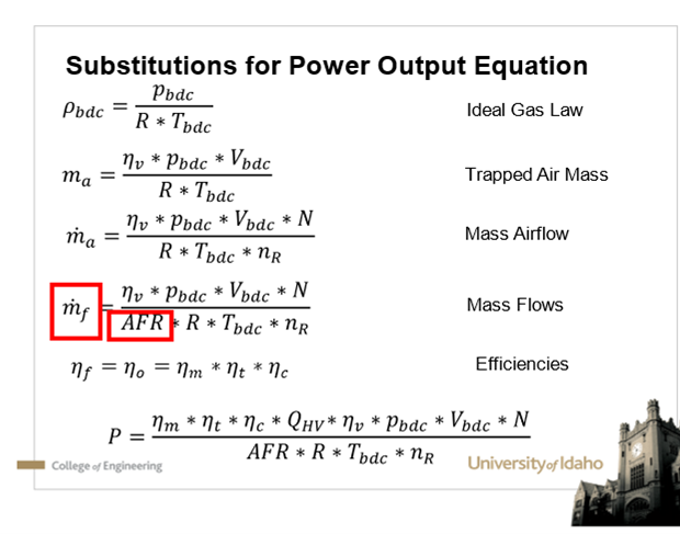

UM, no , not even close.
Lets review. Your linked power equation shows that power is equal to a bunch of efficiencies (slide of terms coming up if needed) and fuel flow.
The red box terms in the the numerator of the the mass flowrate of fuel equation are in the numerator of the power equation, and the blue boxed terms in the denominator of the mass fuel flowrate equation and in the denotator of the power equation.
For ease of reference, lets compare the terms in the red and blue colored boxes to the other respective colored box,,, spoiler alert,,they're the same.
So that leaves these terms in the numerator of the power equation( that you linked).
So lets examine what those remaining terms in that numerator are again;
Its a bunch of efficiency terms and another fuel term,,,so your power equation says power is equal to the various efficiencies, times a fuel heating term, times fuel mass flowrate.
So, if you change any one of the terms in either the red or blue boxes, you also change the mass flowrate of fuel,,,you know fuel,,,where the power comes from.
Antonm
Apr 2, 2024
539
625
“Just”?
There are many other terms, not just afr.
Afr is of course mass of air divided by mass of fuel.
A fuel mixture ( afr) is required to make combustion occur. It isn’t just the fuel. The air oxidizes the fuel and this happens at the right pressure, temp, and mixing.
This is a valid rearrangement of terms to show how power depends on afr and displacement ( other variables too)
If you are maintaining a given power level (like say that 70 hp cruising example) and change any of the terms in either the red or blue boxes above, then you are changing fuel mass flowrate.
Easy example, take P=X/Y, if you're not changing P (its steady at 70 hp cruising) and you move Y down, then X will have to also come down proportionally to maintain P at the set value.
Lets substitute some easy numbers in there to further demonstrate. Lets say 0.5 = 10/20,,, if we change the 20 in the denominator to 10 by itself ,the equation would no longer be true, so the 10 in the numerator would have to change proportionally (to 5 in this case) to keep the equation true, and equal to a value of 0.5.
I should really be charging you for the math tutoring.
