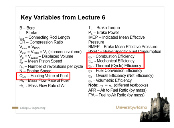

Lets show that you're wrong (again), it two separate ways (again). First lets use your own equations (because, I mean you brought them up, so you must think they're correct/ meaningful and wouldn't jump logic and flip flop like a politician to argue against them after being shown you wrong using), then we'll use a very simple to understand, real world, example that we've all experienced.
Equations first. You are overlooking the fuel terms (you have habit of doing that).
Look-a-there, a fuel rate term (see red boxes), that says if I raise or lower fuel rate, that this value will change. So even If were to leave B2 alone and just change fuel, torque would change,,,,,amazing. And even funnier, in plain English below that is says "Thing to Notice" (also red boxed, so maybe you'll notice this time),

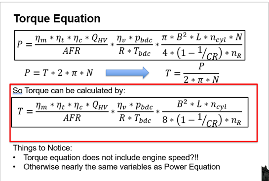

Torque is proportional to SQUARE of bore size.
This is an insurmountable technical fact that can't be overcome by concocting a Boyle's law tautology.
The 5.3 is making less torque at a given rpm. This makes less power at same rpm. Same afr in both engines.

There is an "insurmountable technical fact" that you can't read and don't understand what your own equations are telling you.
Not only did you miss the fuel term, you even missed the big statement that says "Things to Notice". Like did you really think that when an engine is at given "X" speed that it will always be making a "Y" amount of power?
The truth of something isn't proportional to the square of word count.
Power is torque times rpm.
Torque is proportional to square of bore size.
Torque equation doesn't have rpm in it.
6.2 will make more torque than 5.3 at same afr.
Therefore 6.2 will make more torque and hence more power than 5.3 at same afr.
I've simplified it as far as I can.
You are flailing around sticking to "fuel terms" , "efficiencies" , bizzare Boyle's law thought experiments, and "all engines make same power if they are below wot" arguments...
It is nonsense at this point.
You have typed alot of words to justify the unjustifiable. You have created your own "end zone" and keep spiking the rhetorical football. This is a grandiose and delusional self-made tautology.
You can not overcome the squared term for bore size.
We are done here.

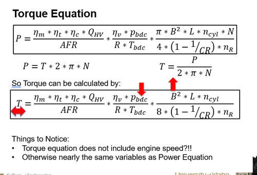

If I' understanding you right, you think at the below referenced torque equation proves that as you say "6.2 will make more torque than 5.3 at same afr."
But, like the clueless guy you are , you failed (again) to recognize that the equation you are using has a term for Pressure at bottom dead center.
And as we've already discussed and proven, if a 5.3 and a 6.2 take in the same quantity of air, the the pressure a BTC will be higher in the 5.3 (that's the whole jist of the scientific law you think doesn't work for some strange reason).
So lets look at how the terms would change (in your own equation) if you inject the same amount of fuel (which requires the same amount of air to maintain the same afr) in a larger bore engine .
Look a that, torque stays the same, wow.
For torque to go up , then pressure a BTC would have to stay the same (or go up), which would mean more air is in the cylinder than compared to the 5.3, which would require more fuel to maintain the same afr,,,,, and so,,, wow, more fuel would cause torque to go up,,,, its like power comes from the fuel or something.

You still don't understand / can't see what the equation you're trying to use is telling you.
Pressure varies linearly with volume. And power and torque vary linearly with pressure. Bore size does not.
You still can't get over the square term for bore size.
Your example above says that a change in a variable that is valued with an exponent of 1 is the same change as a variable that is valued with an exponent of 2.
This is so mathematically illiterate that continuing the discussion is in the realm of psychotic.
