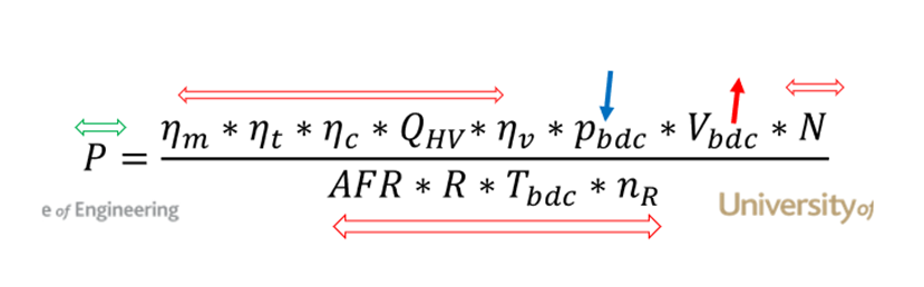

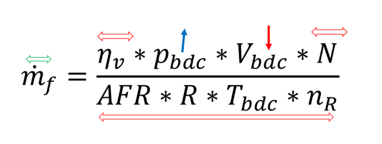

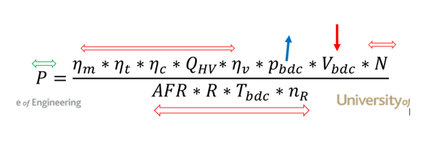

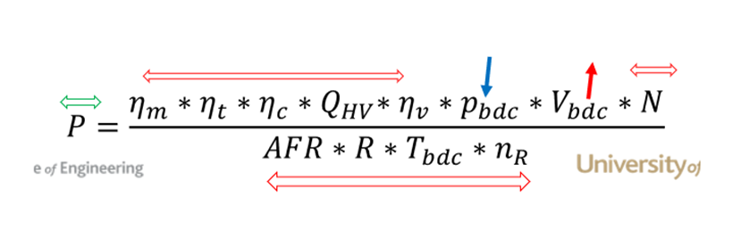

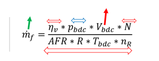

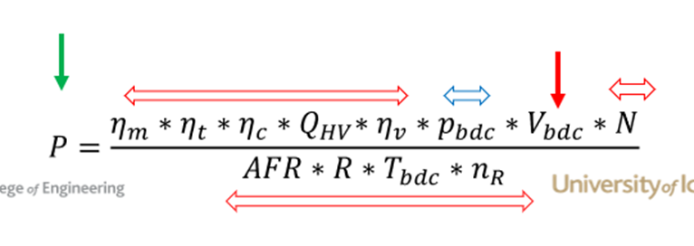

Lets look at what your own equations have to say about pressure at bottom dead center (I'm going to assume you believe them because you posted them.
First lets look a the power, , but do remember that the power equation has the fuel flowrate equation directly carried forward into it (remember the blue and red boxed terms earlier)
So what happens to power if only displacement is lowered, but Press at bdc doesn't change.
Holly crap, power would go down (so the vehicle would start slowing down).
Now why is power going down I wonder,,,
Oh, its because fuel flow is going down.
So assuming its possible for both a 6.2 and a 5.3 Tahoe to drive down the road, side by side, with both doing 70mph next to each other, then they have to maintain the same cursing power output.
So it ends up looking like this in reality, with pressure at bottom dead center going up when you trap the volume of air needed to burn the same amount of fuel in that smaller cylinder ( of course the revers is also true if you wanted to start with the smaller engine and go to the larger one)
We need power to remain constant between the two engine so both vehicles maintain the same velocity (i.e.. both driving down the road at 70mph).
And BTW, fuel flow will be the same as well.
The value of this pressure change a bottom dead center changes could be shown with p1*v1=p2*v2, but since you recanted/ edited your agreement to that basic equation, I just went with the equations you posted (assuming you agree with them), to illustrate the same point.
So I assume now you'll flip- flop to an efficiency or something to try an explain how your ridiculous assertions could have even a grain of truth to them.

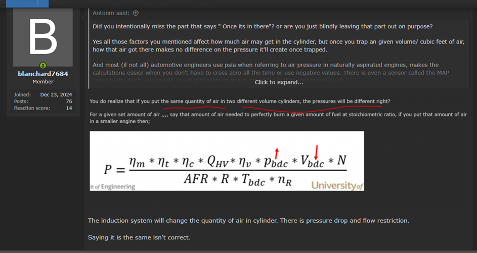

You literally contradict yourself in the same post only a few sentences apart.
You say above "If I take 5.3 L at a specified pressure , it will also have a specific mass. Then if I put this into a 6.2 L container, the pressure will decrease by Boyle’s law."
So you acknowledge that if you put the same volume of air in different size cylinder the pressure will be different (you even wrote this, see above).
Then you seem to acknowledge that its takes a given mass of air to burn a given mass of fuel at stochiometric. Since both the 5.3 and 6.2 make the same part throttle power at cruising speeds , then they would need that same mass of air to that.
But even though you say you understand it takes the same mass of air, and that different size cylinders will have different pressures if the have the same mass of air trapped in them,,,, but you till don't seem to understand how pressure at bdc could be different,,, do you really not see the contradiction in you own statements/ your own logic here?
You can not discount the effect of acoustic design on the different induction systems.
It will alter pressure at bottom dead center.
Which negates your Boyle's law concept.

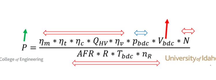

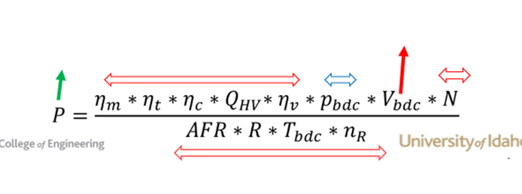

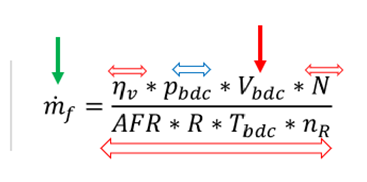

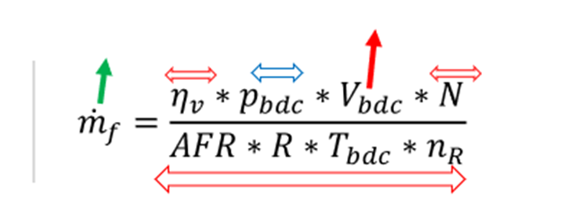

If you Increase displacement, but want to maintain the same part throttle cruising power output, then pressure at bottom dead center will go down (because you trapped the same volume of air in lager cylinder and Boyles suggestion say so).
Lets see that in your own equations;
Now, lets see what happens if you take in more air in that larger cylinder, (because taking in more air in that larger cylinder is THE ONLY WAY pressure at bottom dead cylinder could remain the same).
Oh look, power goes up (we don't want power to go up because they we be accelerating vice maintaining our cruising speed but ahhh its going up).
Wonder why power went up;
Oh, its because fuel flow went up, that's why power is going up.
Now repeat with me,,,,
-power comes from the fuel
-to burn that fuel we need air.
-to make the same power in two engine with the same efficiencies, we have to burn the same amount of fuel.
-to burn the same amount of fuel at the same afr, we need the same mass of air.
-Boyles law is a law and not a suggestion, so if we trap the same mass of air in two different size cylinders the pressures will be different in those cylinders, even though both cylinders contain the same amount of air.
Less displacement increases pressure at BDC, so power goes up...because Boyle's law says so.

No I got ya...to increase cylinder pressure, to increase power, or maintain power, you must reduce displacement.
I'll be sure to try this on my next project car.
I'm sure it will work great.
Now you're trying to hopeless spin crap because you know you've been proven wrong, (several times so far) and are tying yet again to grasp at straws by taking things out of context.
Look again and see if I said anything even remotely like that stupid statement of yours above ,,, please quote that.
I got it
Don't worry. I'm already shopping for a smaller displacement platform.
Comedian is your future calling.
Yet another thing you're pulling out of your dumb ***, please quote where I said anything even remotely like that.
Are you perhaps color blind and can't see the directional arrows I put on your own equations ,or are you just to stupid to understand them?
You apparently think you're smarter than Robert Boyle (the creator of Boyle's law) or think he and the entire scientific community for the last few hundred years have gotten in wrong, because in your mind you've disproven this law in a forum posting.
