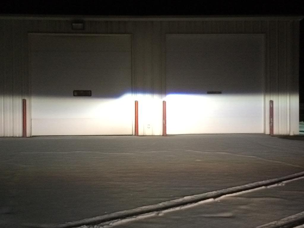

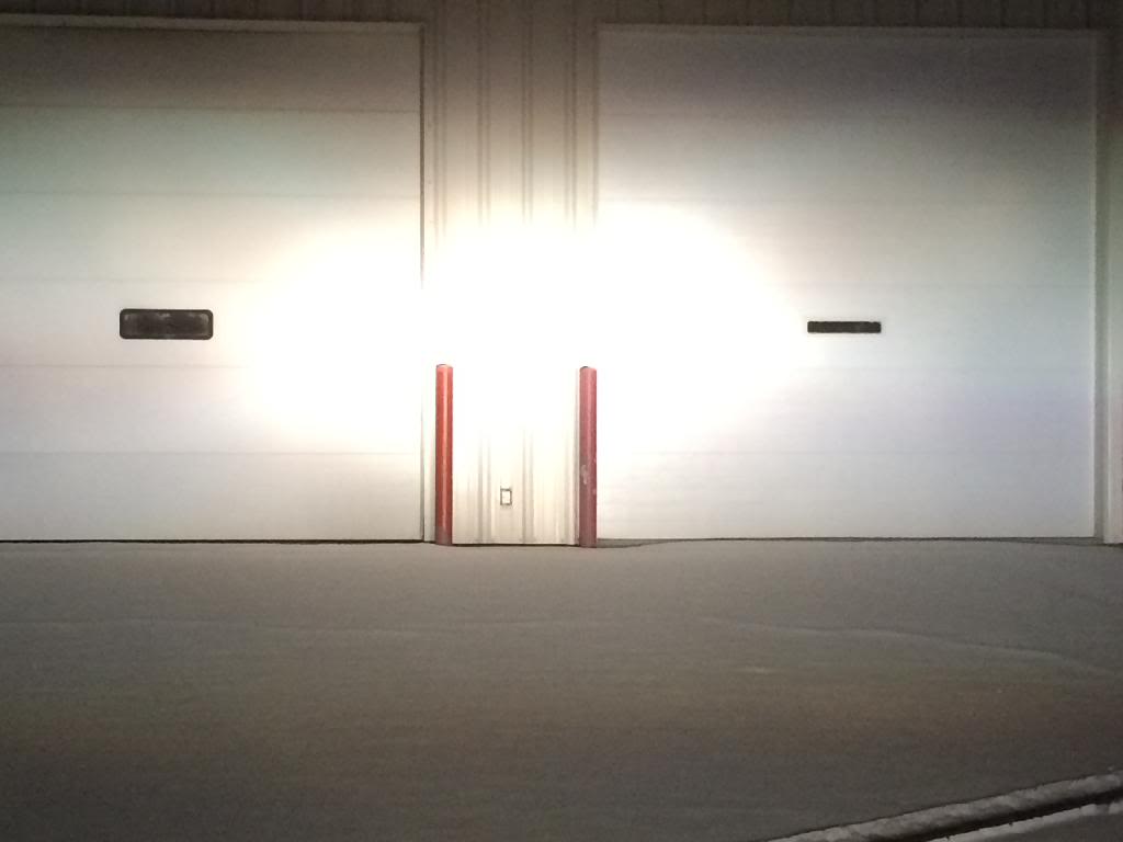

Below is a pic of my retrofit output pics....cutoff
High beam (silverstar ultra) with bi-xenon
I'm using Mini H1s 5000K XB35 bulbs and 35watt ballasts
