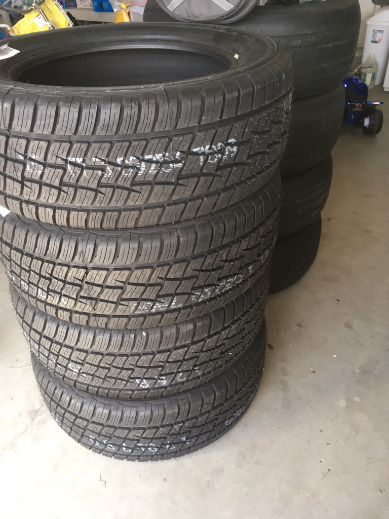

275/55/20s showed up, they look huge even thought that’s what was previously on it lol
