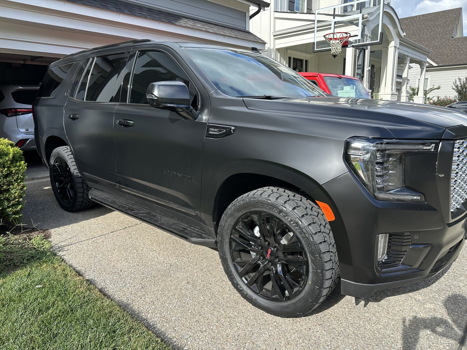

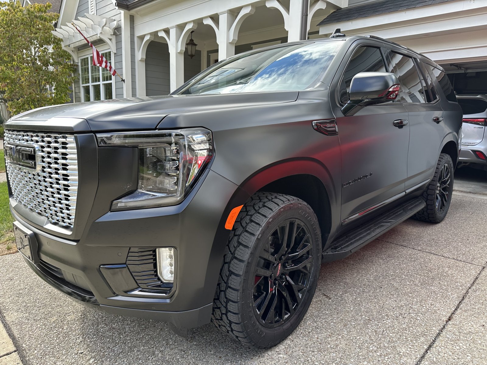

I run 305/50x20 on my 07 Denali, and I don't believe that you would have any rubbing with the 305/45x22 on a stock wheel.

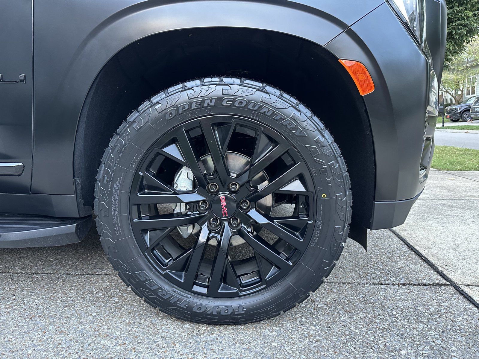

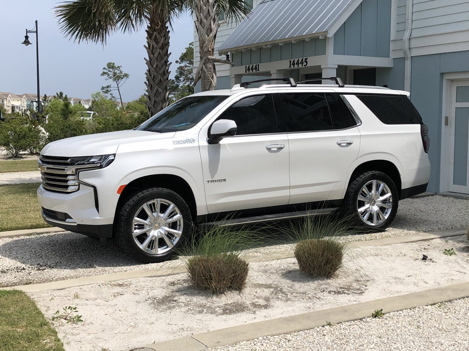

I put 305/45/22 toyo open country at3’s on my wifes high country. They fit perfectly with no rubbing with no level, although i did level it an inch and a half later on.
Also, one thing to consider, most 305/45’s are xl-rated tires, not the e-rated truck tires like most of the 285/50 and 285/55’s. I would think the e-rated may ride a bit more harsh…maybe not though.

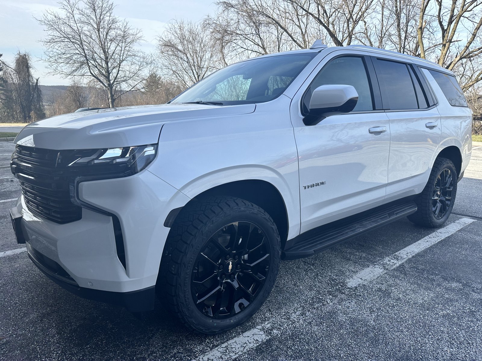

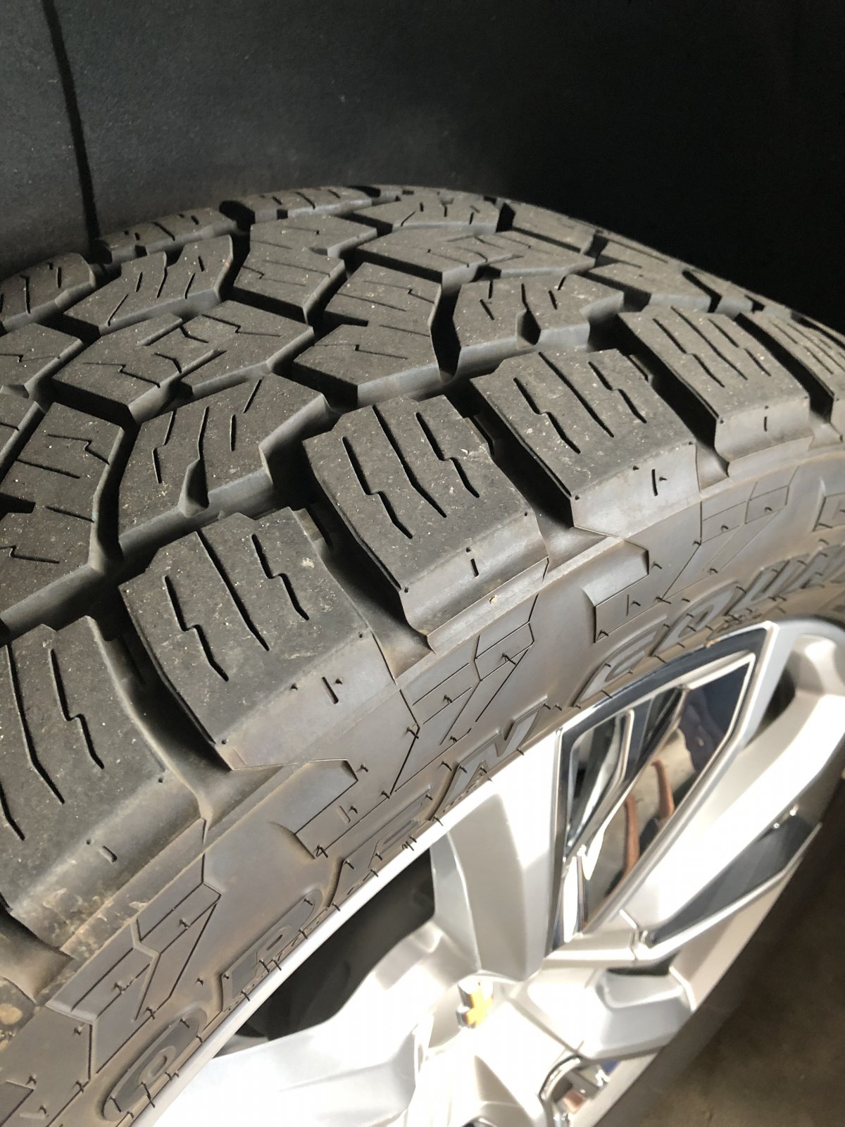

Just got some 305/45r22 recon grapplers delivered. Will post pics when I get them mounted on Monday.
