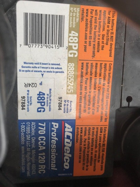

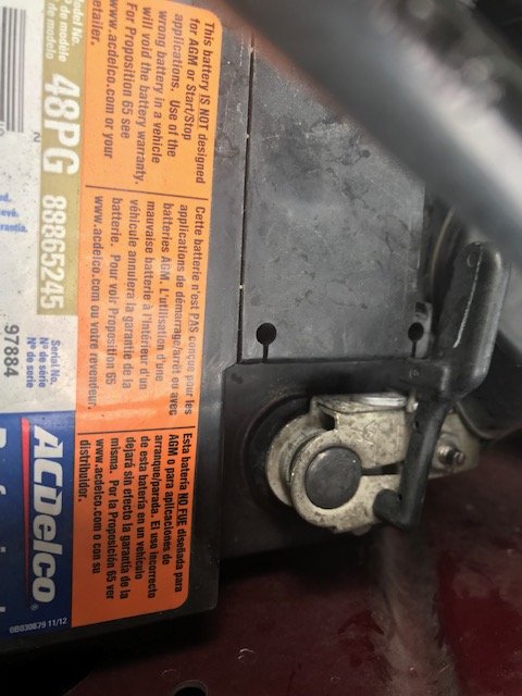

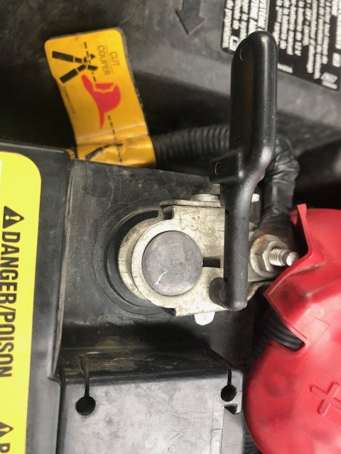

In preparation for colder weather and just for peace of mind. I just took my 09 tahoe Hybrid over to my local auto parts and they tested the battery. it tested GOOD. Looking at the stamp on top I see P024R and per an internet search the first and second numbers (02) indicates the month and the third number (4) indicates the year? The R indicates the plant it was made at. I think it was manufactured in February 2014 at plant R wherever that is and is quickly approaching the 5 year old mark? Here are a couple of pics let me know what you guys think...............

I’m thinking of replacing it with an Optima yellow top or red top. Does anyone have a model number and a suggestion as to whether I should use the yellow or the red?
I run a yellow D34 or 35 (can't remember). Their site now lists a H6 for my HOE but I don't know anyone who's used it yet????
