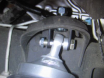

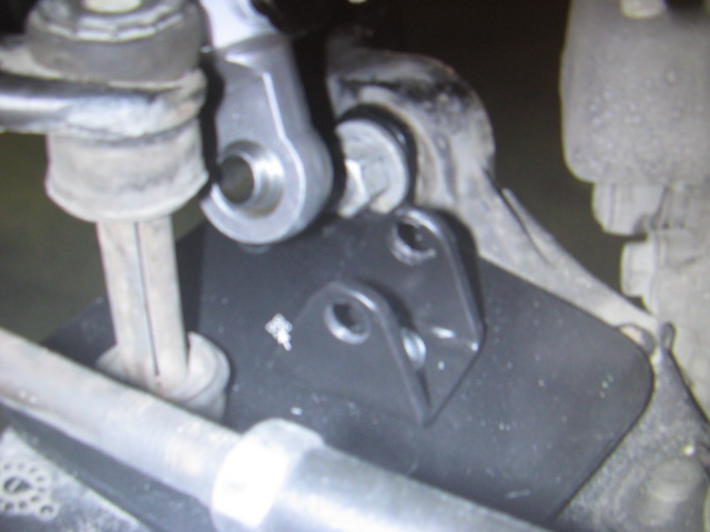

I was on the RideTech site tonight, and there airbag/shock setup for the Yukon mounts to the stock upper shock mount with no extra reinforcing bracket. either the upper OEM mounts are very strong or, they haven't had any issues yet.
Amongst my research there are a couple people that have no reinforcement on the upper perch. Sure atomic can chime in on his experience.
Looks like they use the Eye to Stud Adapter to mount to the upper, which to me is not a reinforcement, but not straight to frame either. So that could help.
Interesting bottom bracket they use.

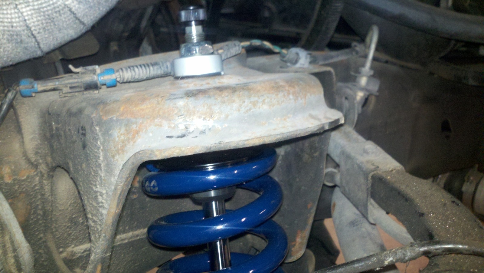

Here is ridetech coil overs on a truck. Wonder what mount is on the top of this one?
I tgink this is the right solution for the upper wear you could face
I have seen plenty of people that do nut use any type of upper reinforcement, but how much do you trust that part? They all seem hesitant about it, which is why I made the upper mounts anyway. You dont have to use my uppers if you want to switch to coilovers.
