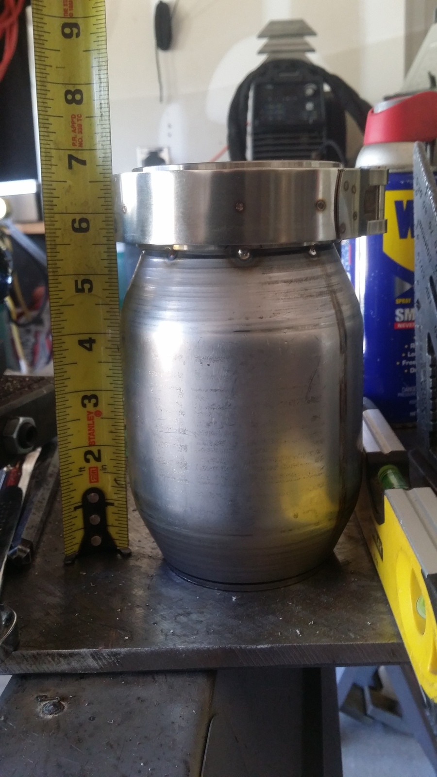

I'm planning on going with Speeds LTs as well but, will keep cats. Bought some v-bands and cut down a 2.5" in/out Maggy spun cat and cut it down to 3" in/out to make is as compact as possible. I forget how big it was at first but its about 6" long now with a v-band welded on.
