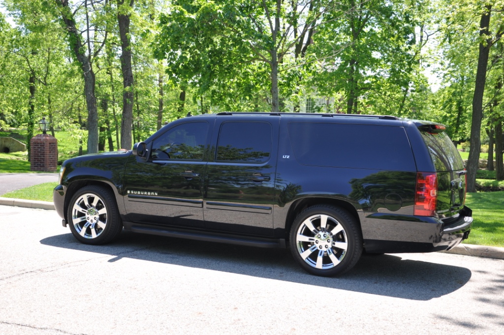

Great looking truck - pics on level ground please!! Have you adjusted you links yet? (If so, shorter or longer)

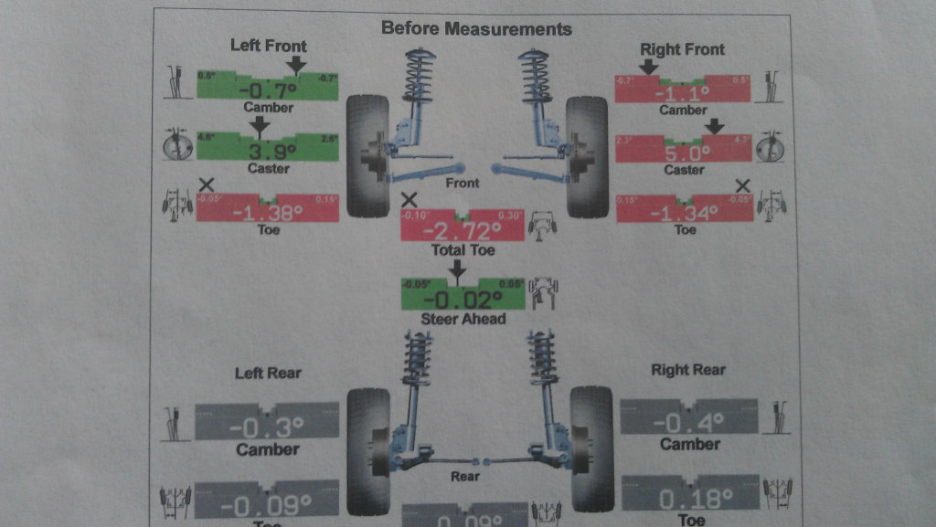

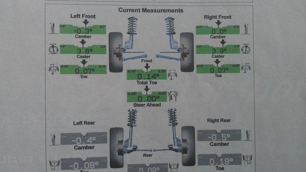

Thanks! I just got the alignment done today and WOW... it was seriously off. I knew it was off but didn't even realize it was possible to be off as much as it was. Everything is great now with the ride and handling.

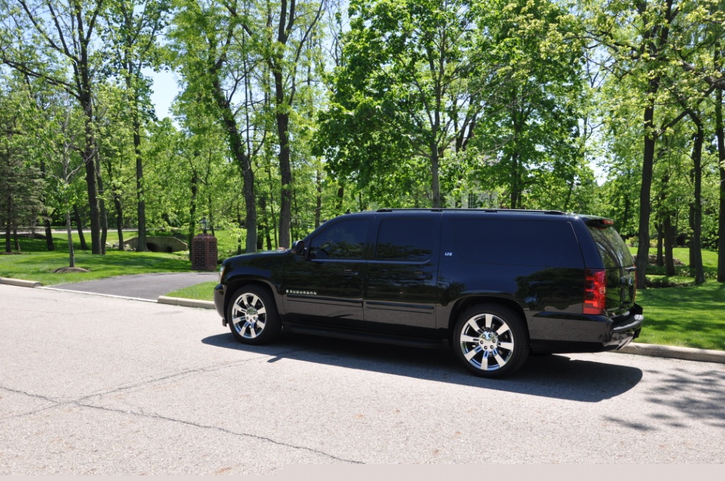

Here are some pics from today after the alignment was completed...
And here are the alignment specs...
Before... LOL...
After... much better...

Very nice man!!! Definitely looking forward to doing this with mine tomorrow. I'll be getting mine aligned next week. That looks incredible :waytogo:
