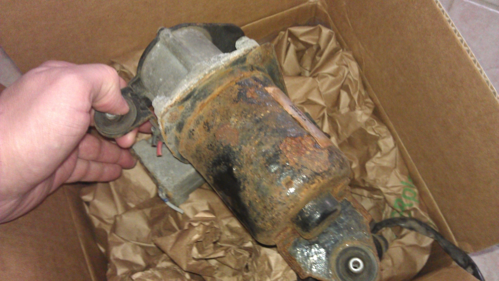

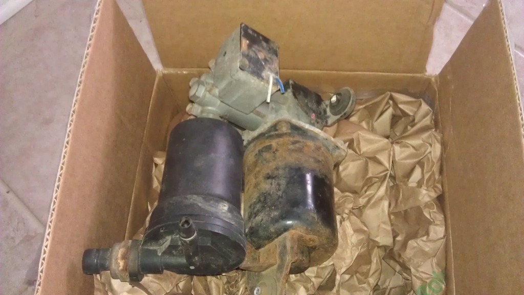

I flew home early today so had a chance to swap out the compressor and air dryer. Wasn't too difficult and now everything works. I'll be honest... I can't tell you the last time I heard the compressor actually run. Regardless, The truck didn't raise much higher in the rear from the precious pictures. I'll get some photos and measurements asap. After I haul some mulch this weekend I may shorten the autoride links but only a slight bit as it's not too bad right now.

BTW... here's the old busted-arse compressor
