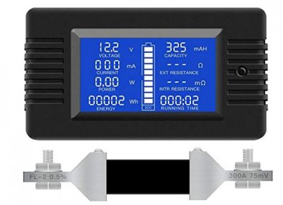

Son's amp clamp was the same way, not sensitive enough. So I got one of these and wired the shunt into the negative battery connection.
https://www.amazon.com/gp/product/B...2TZZBEHYNES5VB7Z&pd_rd_w=1UnYQ&pd_rd_wg=Jjr8g
Before that I had a DVOM connected inline while doing some testing but of course I can't start the truck with that in there. I caught it drawing 1.5a (asleep) and killed the radio circuit to get it back down. This way I can monitor it while I'm able to run it, and will be extending the wires this weekend to get it into the cab. I don't think it will be permanent, it's kind of frankenstein-ish at the battery but should be okay for a couple of months or until I figure out what part of the radio system is causing it. Could be the Kenwood or the PAC SWC box, I guess. Or a wiring issue, but I was pretty cautious when I installed it. I did manage to update the firmware on the Kenwood.
Currently (pun intended) it's drawing between 21 and 24ma at rest. Everything goes to sleep pretty fast, easily within a minute.

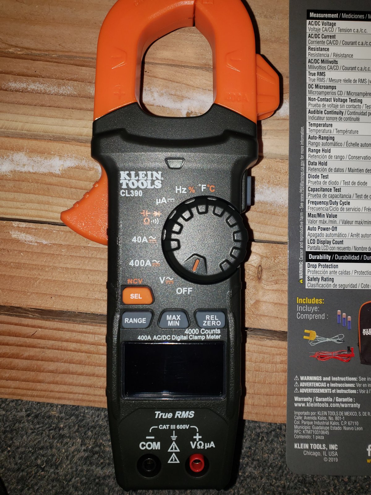

Fless- I do like the looks of your new meter- that split ring clamp looks easy!

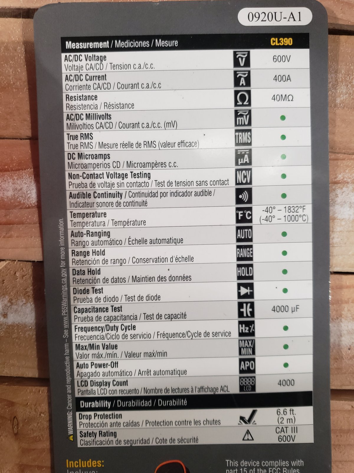

I've got the Klein Tools meter like the one above as well. I got it to measure current going to my trailer brakes, but was also using it to chase leaking current. It was sensitive enough for me to observe that my Tahoe continues to use curren
The clamp probably wont read DC mA but the leads will lol
I have one of these Klein Tools as well. it was sensitive enough for me to see that my Tahoe continued to draw current for about 15-20 minutes after shutting it off and locking the doors, after which the current draw dropped. I cant remember the exact current values though, but it should be sensitive enough to see something major.
When testing circuits for current draw, as soon as you open a door it will activate the computer again and you will have to wait another 20 minutes. If you pull the courtesy lights fuse, that should disable the triggering by the door and you should be able to attach your clamp meter, open the door and one by one, remove each fuse in turn to see what is drawing current. The hood may also draw current when open too when checking engine bay circuits.
