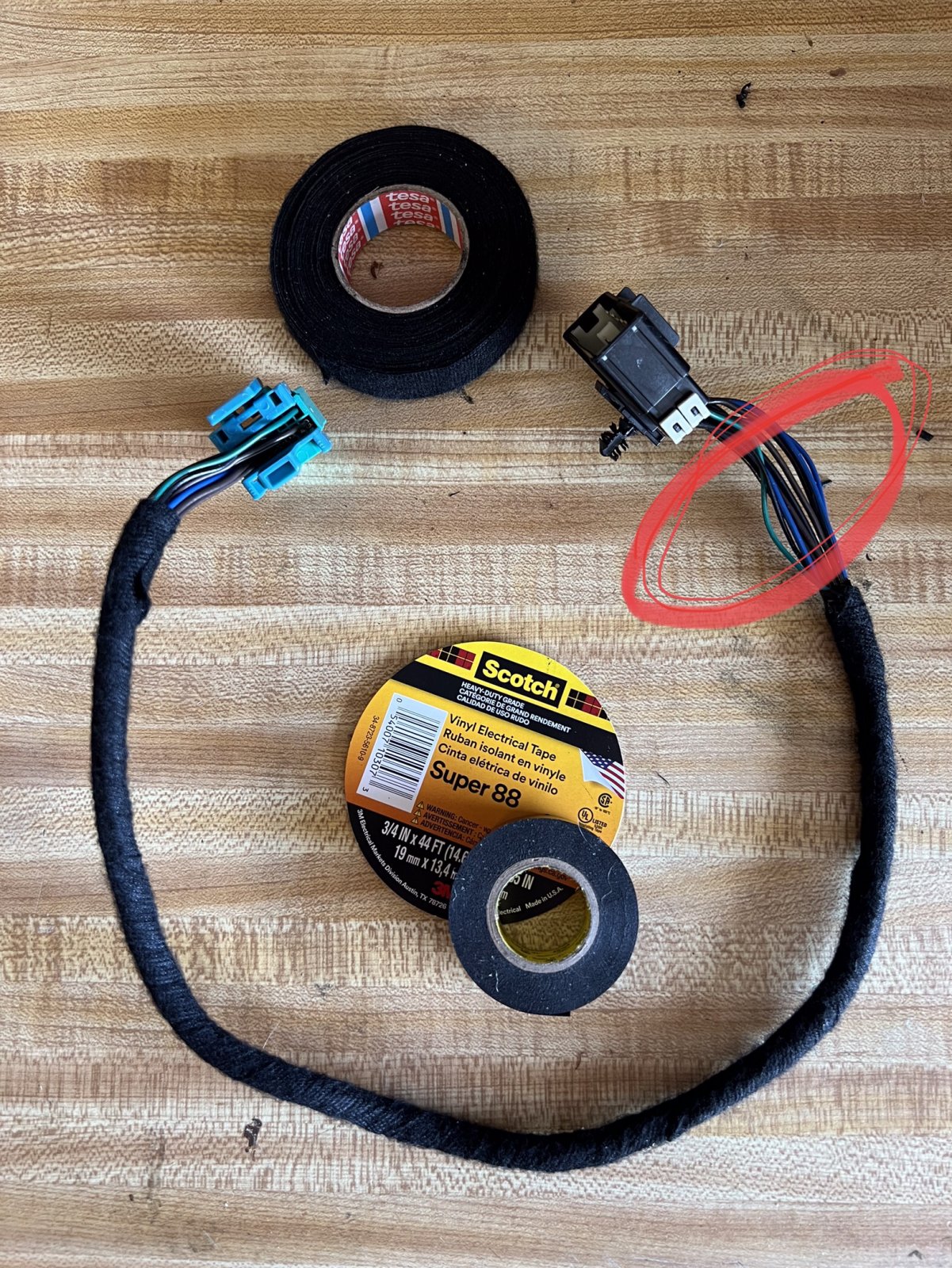

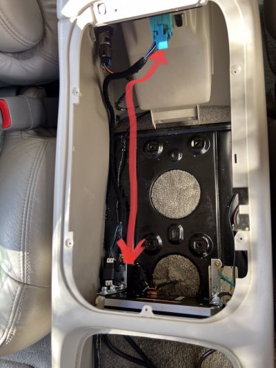

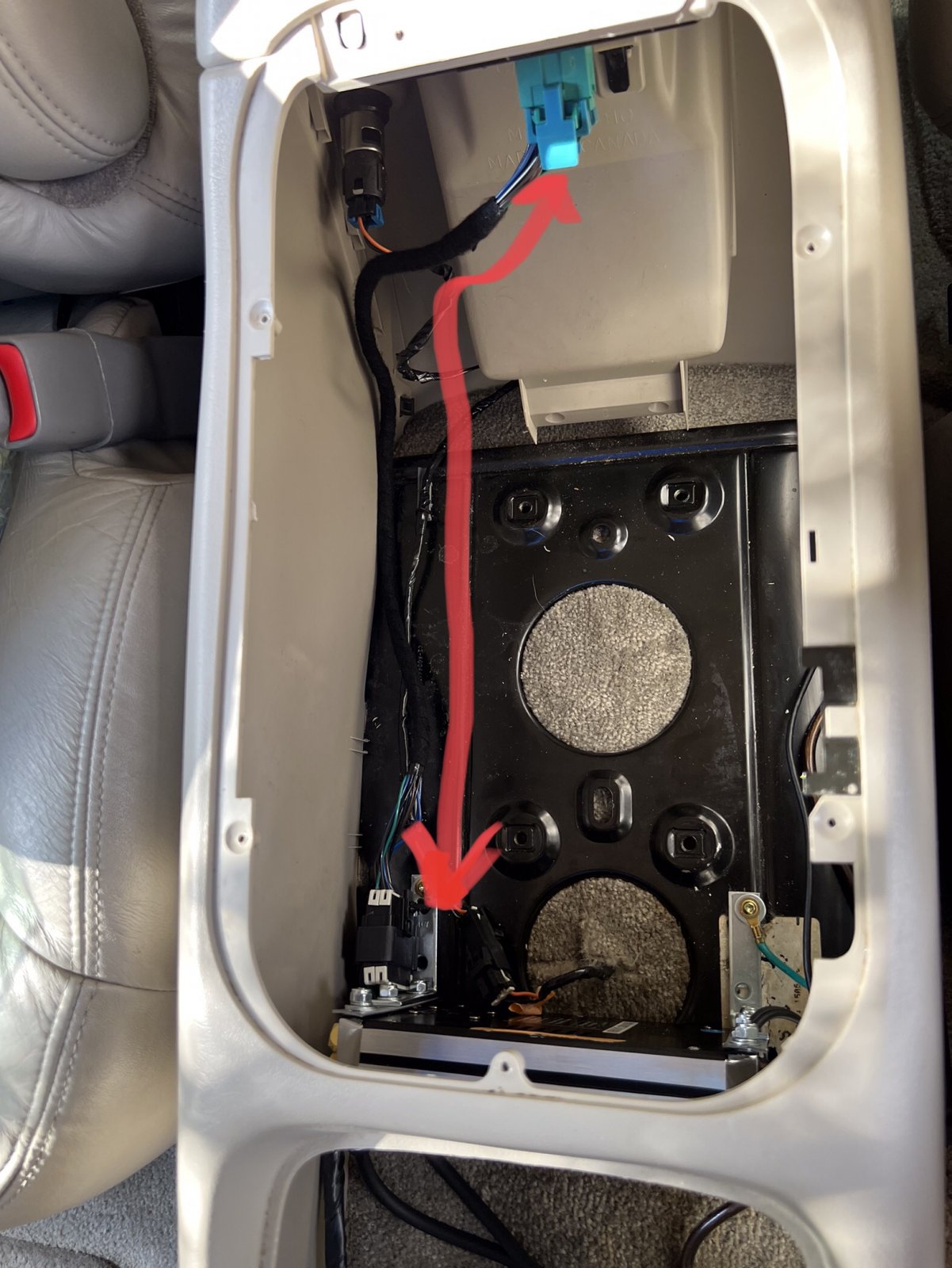

Update | Ignore everything below here if you have 6” X 2” rear seat personal audio audio headphone player without rear HVAC controls at the aft end of the center console. Keep it intact. Don’t replace it with a cubby. The head unit feeds this panel with rear audio channel signal UPSTREAM OF THE OEM AMP, and in series with the OEM amp. So if you break this cable (pics below) you lose rear audio in the rear doors and rear pillars, and subwoofer. Don’t ask me how I know this.
Deep in my brain I thought about this when I was disconnecting the rear seat personal audio player, but it should have been obvious when I saw 2 of each of the same color wires on the connector. Rear audio channel goes INTO the personal audio headphone controller and then COMES BACK OUT and goes to the amp. So this could be a good place to bypass the factory amp for line-level signal for rear channels and subwoofer only from the factory head unit. But I’m still using the adequate factory amp for rear doors and rear pillar ….so I re-wrapped and re-connected the wire bundle under the console box and fortunately my rear audio channel is working again.
Some pics added so you’ll see what I should have seen.

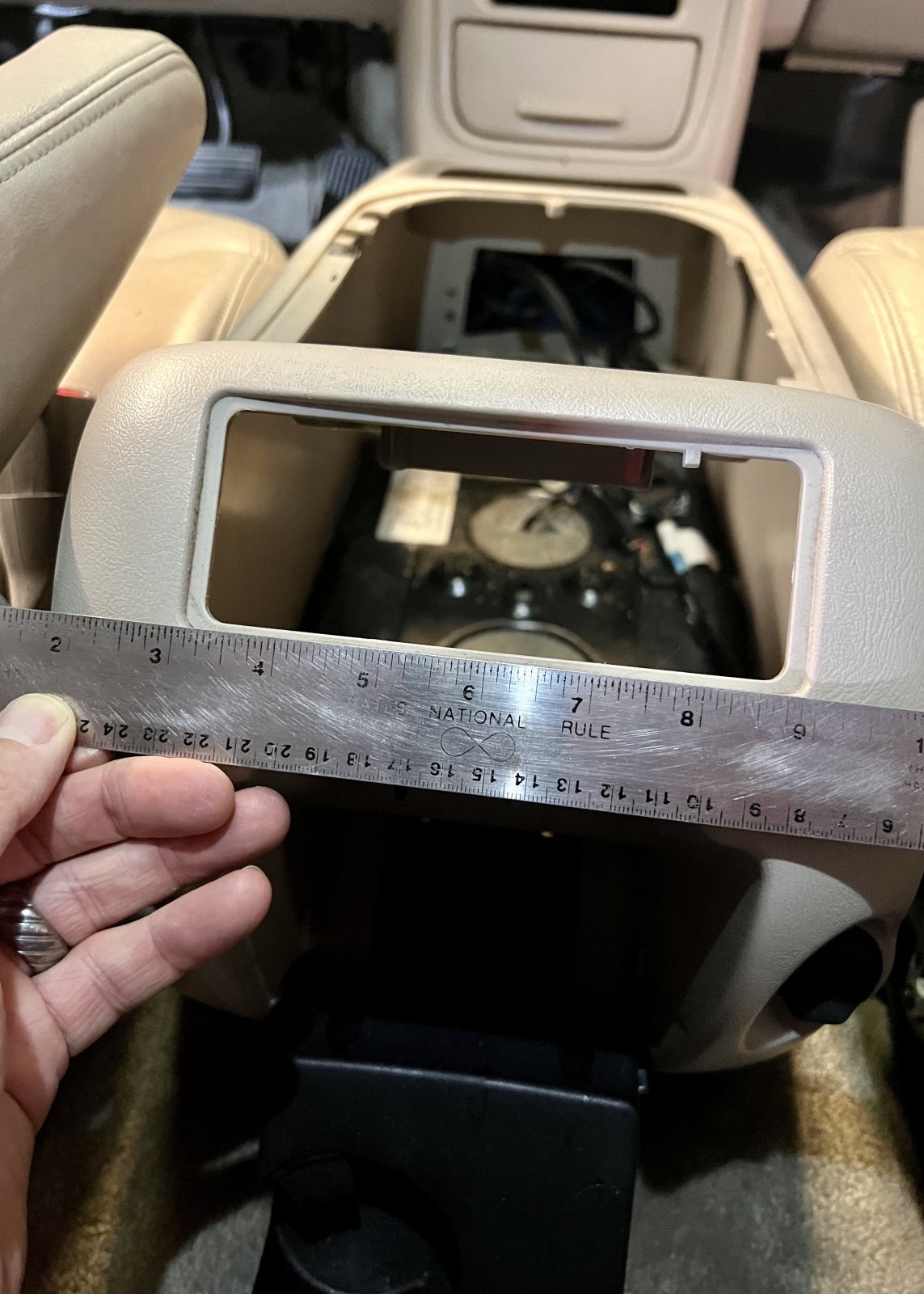

I found a cubby for the front console cassette player and that turned out great (pic below), but can’t find a cubby for rear audio controls. Will keep looking.
If anyone has a link to a cubby for rear seat audio controls please link, thanks in advance.

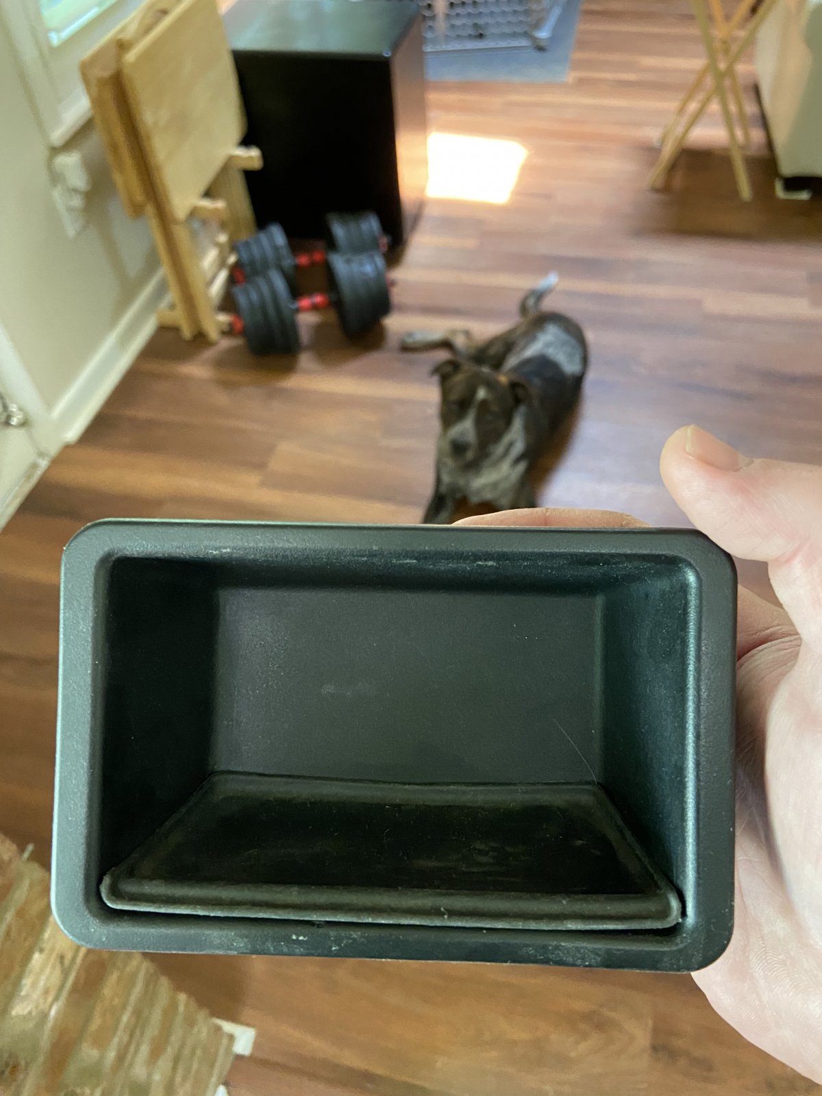

Here are my notes on this, I think they’re pretty tough to find. Best bet is the junkyard:
15070480 or 15189381 not available. Find in 1500 or 2500 silvy (2003/2007)
ETA: I was very fortunate, and bought one from @NoReverseYukon , and it’s pristine. Not sure if he has any left.

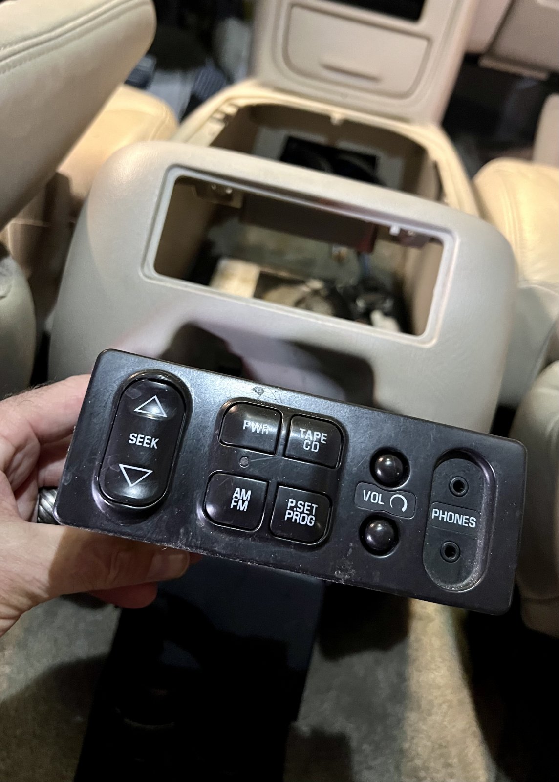

Updated the OP, up top. Don’t disconnect the rear seat personal audio controller. Should have been obvious …. The rear channel audio signal runs thru here on the way to the factory amp. Disconnect this controller and you lose rear channel audio to rear doors, subwoofer and pillars.

I think you can disconnect it, you just need to connect the pins from each connector to close the circuits again. Basically bypassing the audio controls. I remember reading something about that on here before, someone else did it.
