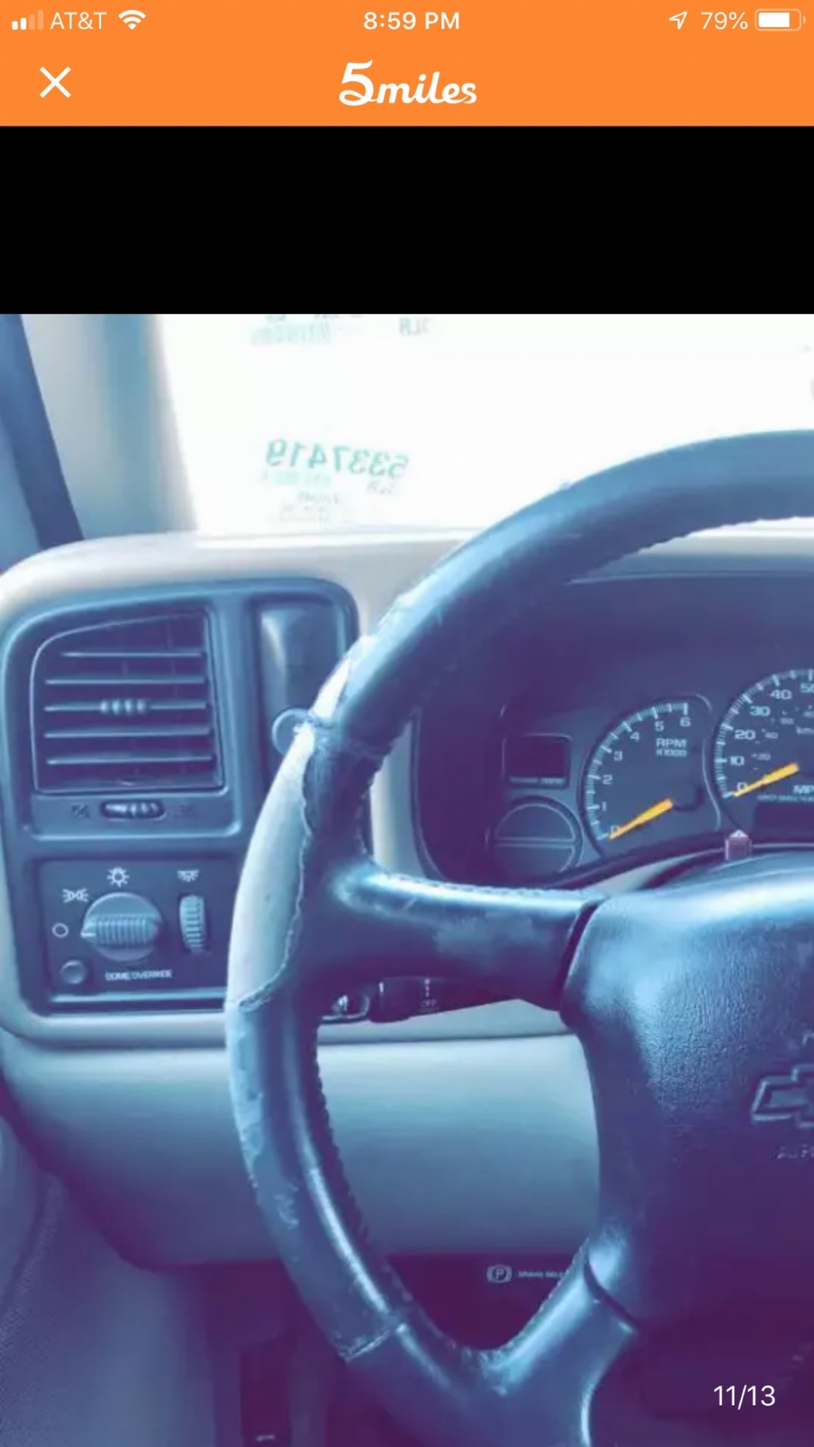

Saw this one, they said it’s a 2500 4wd burban but the dash switch doesn’t look like a 4wd switch, what is it?

Believe that is traction control. I had a 2000 Tahoe back in the day and am pretty sure that’s what it was. We had an 04 a few years later and the button was under the center vent.
Regardless, it’s a 2WD.
Yea that’s what I was thinkin, hard to find a 2500 that’s 4wd
