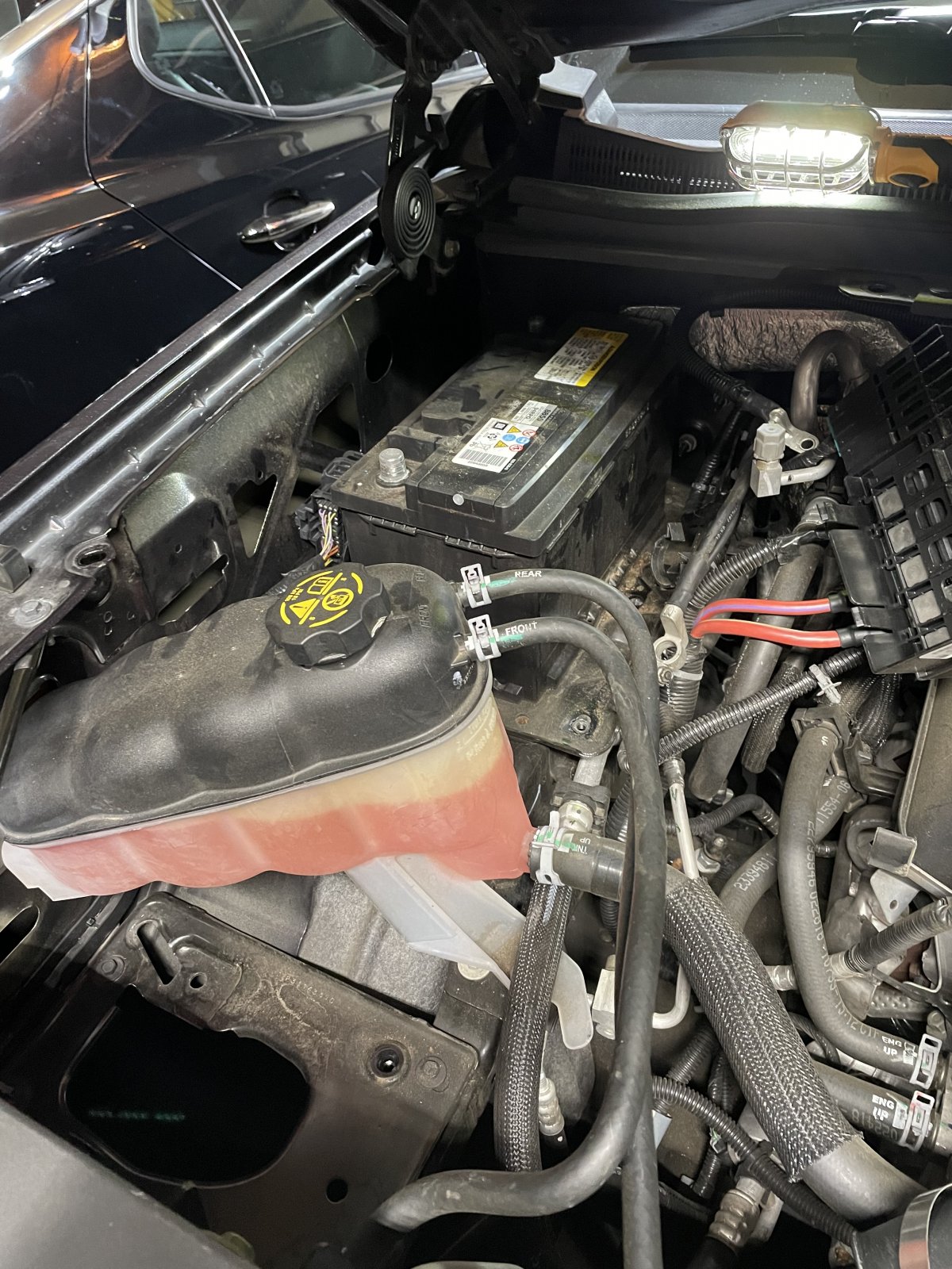

As stated it just pulls up held there by rubber. I had to change my battery so it needed to be remove.
