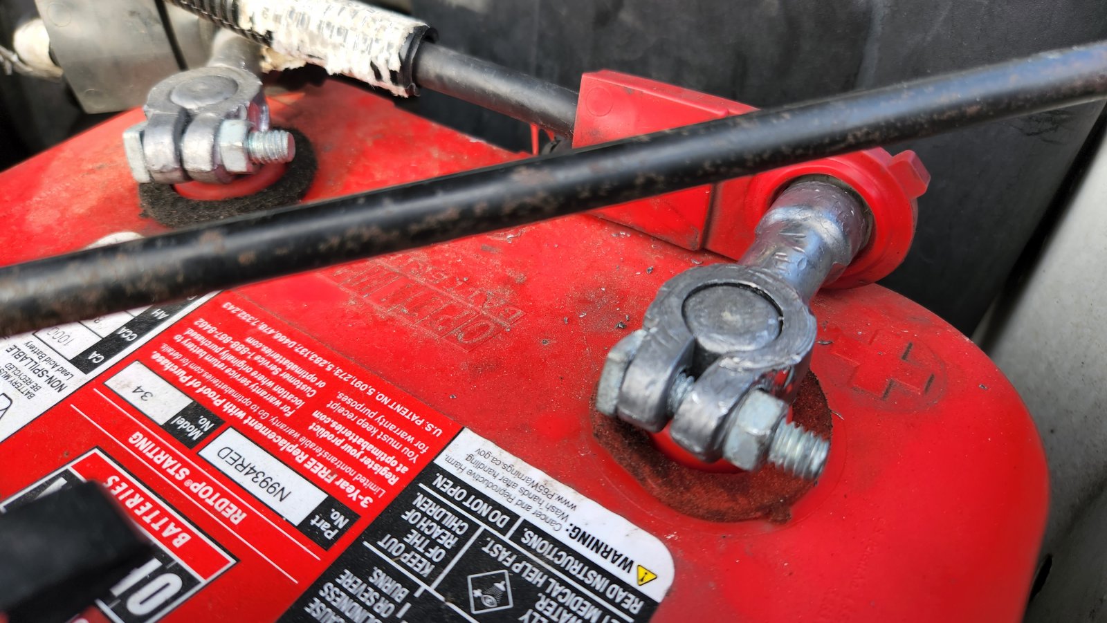

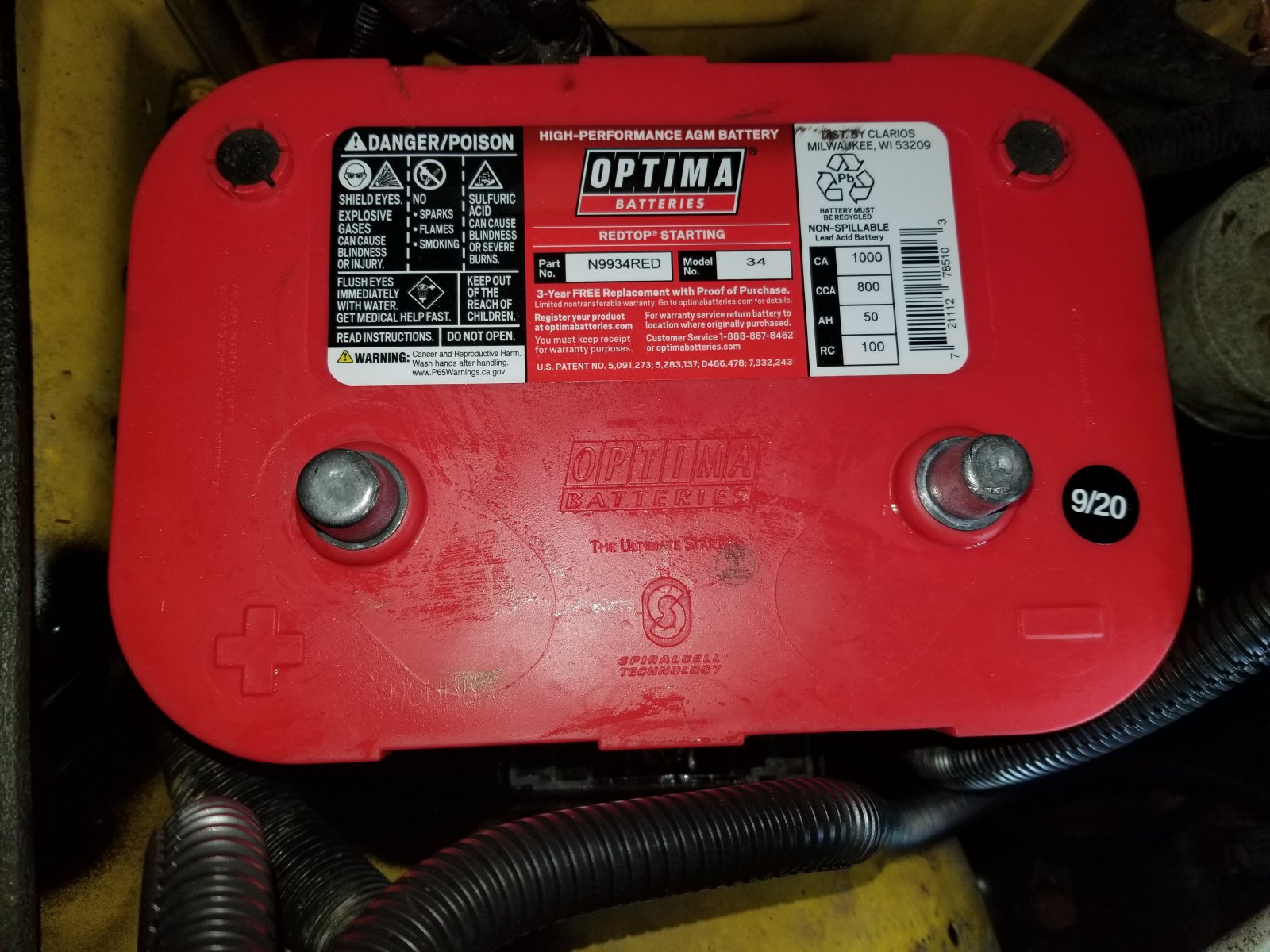

I bought an Optima Red Top AGM from NAPA in October 2020 for the Jeep I had.
Not all Optima Red Tops are the same. There are others with lower CCA ratings, which are less expensive.
I wanted high CCA and this one had 800 CCA.
It was only 18 months old when I had to ditch the Jeep and the battery that was coming with the Tahoe looked older, so I swapped them out.
The battery in the Tahoe was also an Optima Red top. It looked a little smaller in dimensions, felt a little lethargic on starts, but was still cranking.
I was shocked when I pulled the old one out of the Tahoe to find a mfg. sticker date of 2009!
I would say that battery owed nothing to anybody!
The Optima I had was a top post, but since I paid $269 for it and was a Group 34 (right size for the Tahoe), I got the top-post adapter clamps and dropped it in.
Extreme hot or extreme cold, this battery cranks over and starts strong under all conditions. VERY happy with it!!
I might not even need another battery before this Tahoe gives up the ghost or I get something else, but I would not hesitate to get another high CCA Optima Red Top again.
3 Year Full Replacement Warranty
1000 Cranking Amps
800 CCA
50 AH
Sitting in the Jeep TJ...
With side-post to top-post adapter clamps...
