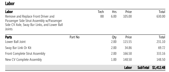

Below is a quote from a shop that was looking at other issues and popped this quote on me...I think they're using MOOG parts but I didn't give them the time of day to discuss (I don't trust them).
Anyways, now that I'm dropping all this money at once I'm trying to figure what I need/don't need. I'd assume at 152k miles I likely need EVERYTHING. That said I'm considering a leveling kit/or small lift depending where we're at on price/value/fun. I've also attached a few pics (not great) from when I was under the vehicle with the mechanic.
Questions: Should I replace the entire front end with lower A arms?

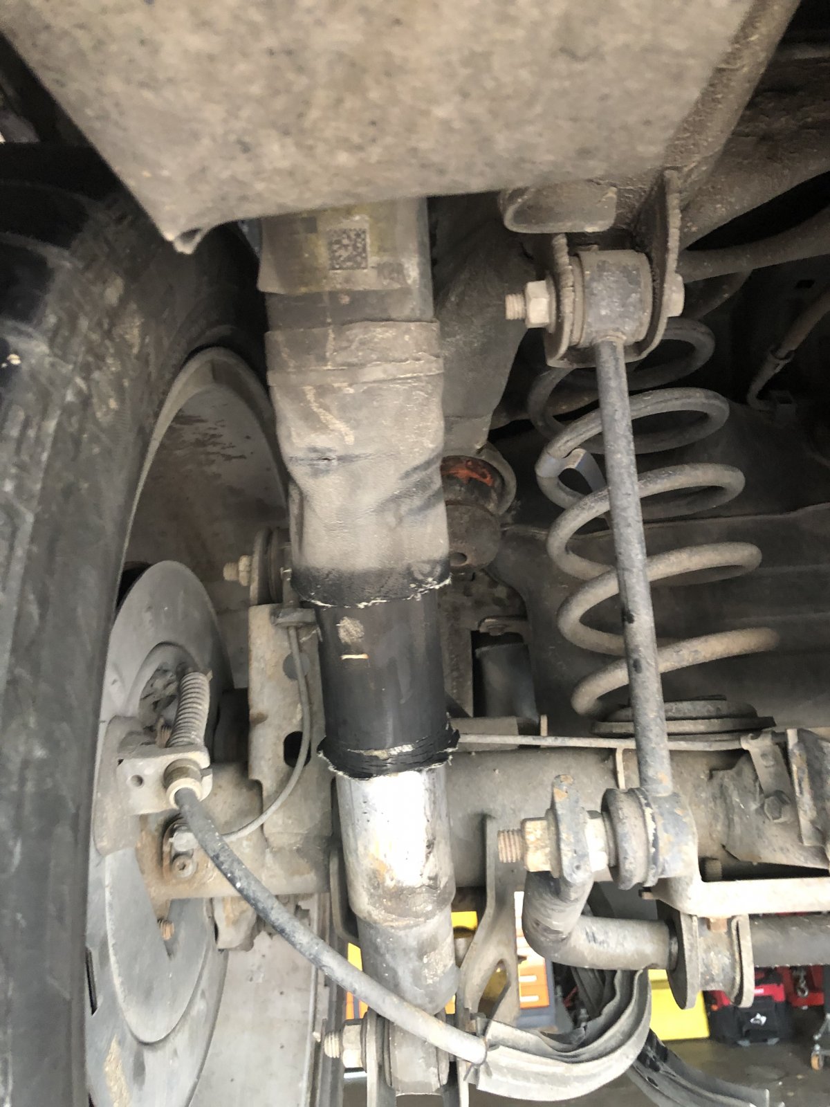

Haven't even started thinking about the rear shocks but apparently they're toast (see pic)

Rock Auto:
ACDelco Professional Complete Control Arm with Ball Joint (45D2471/45D2472) = $75.79 each *
ACDelco Professional Lower Ball Joint (45D2271) = $47.79 Each *
ACDelco Sway Bar Link (88912151) = 10.56 each
ACDelco Complete Strut Assembly (19324406) = $105.99 each
ACDelco GM OE CV Assembly (22789359) = $293.99
Parts above come out to $678.67. So if they use the same or comparable parts, it's not out of line.
Now let's look at the labor:
Control Arm Replacement: 3.5 Hours for both sides *
Lower Ball Joint Replacement: 4 Hours for both sides *
Sway Bar Link Replacement: .7 Hours for both sides
Strut Assembly Replacement: 1.9 Hours for both sides
CV Axle Replacement: 2 Hours for one side
Their labor charges are not out of line either.
* = One or the other depending on what estimate refers to.

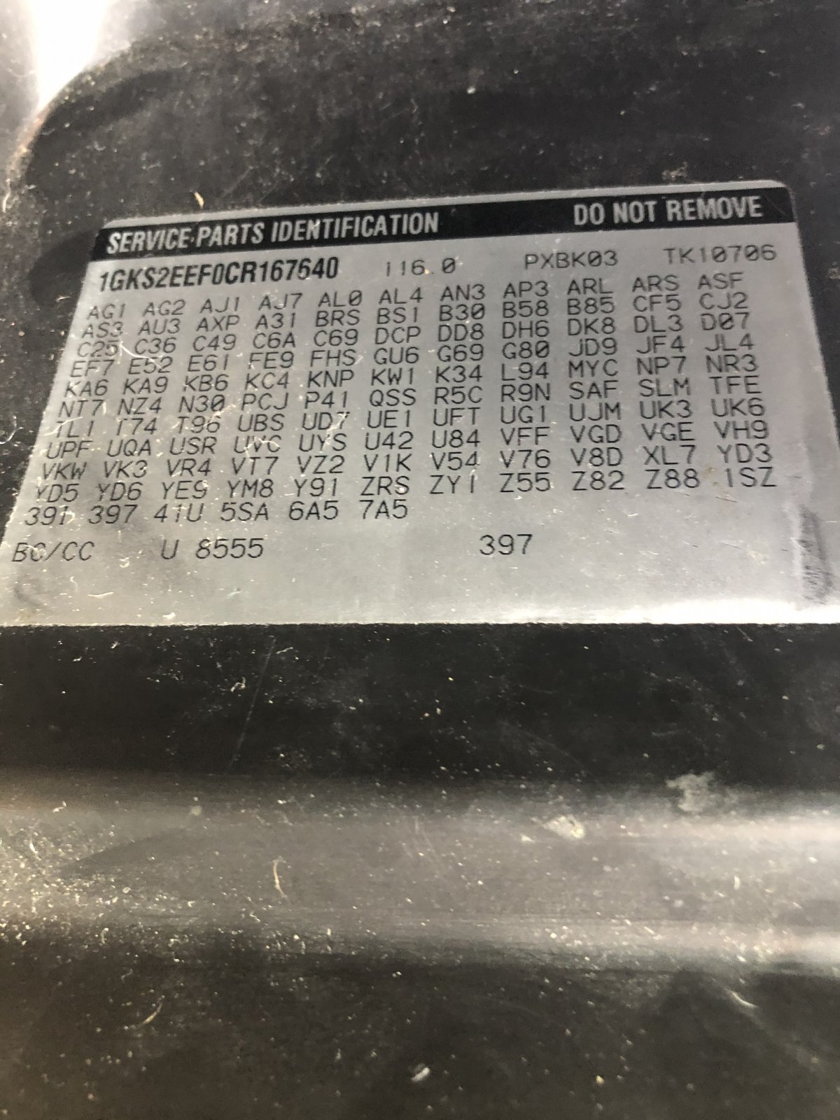

Dang, you gentlemen sure know your stuff! I believe I have the Z55 (pic below).
I prefer to go big or go home but with everything hitting at once, I may have to phase whats necessary in for the time being. It really appears that it's the parts and not the labor on most of this

As your RPO sticker shows, your truck came out of the factory with a Z55 suspension. If you do the suspension work in steps, I suggest that you tackle the rear suspension first. If you are reasonably handy with tools, and you have a basic tool set, and a jack, you could perform the rear suspension upgrade (shocks and compressor) on your own, so the labor would be free. It is a fairly easy job to tackle, and there are plenty of great YouTube videos that will walk you through the process, step by step..
Then, when you are ready to upgrade the front suspension, you could choose to have others perform the work, as it is bit more complex and may require additional tools (like a high capacity set of spring compressors).

Well, if your lower ball joints really are that bad, then replace them and the end links. I forget what was said to be wrong with the CV axle. Definitely need to replace the rear air shocks and possibly the compressor. The front struts can wait.

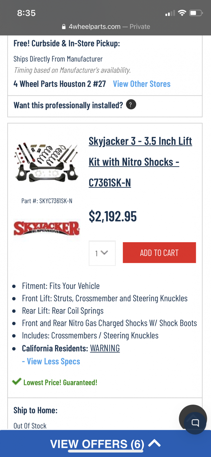

I have yet to make a move on my suspension components. My question is what I should do if I decide to upgrade/lift/level? With everything being TOAST under the vehicle this would be the time to do it-correct?
I was looking into this lift attached? Would this work with Z55 and what would the pros/cons be? I’m not trying to make this a complete toy but I do go off road (nothing crazy just hunting and ranch roads).

Replying on my own post here- I called an off road shop and they said you CANT LIFT an AWD. I'm sure it can be done but I'm not wanting to bypass anything and I'd like to have a comfortable ride.
Anything I should consider before moving forward? I'd like to level it but if that comes at a cost, well that's another story.
Seems like Suspension Max would be who could best advise?
