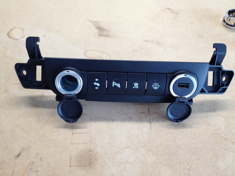

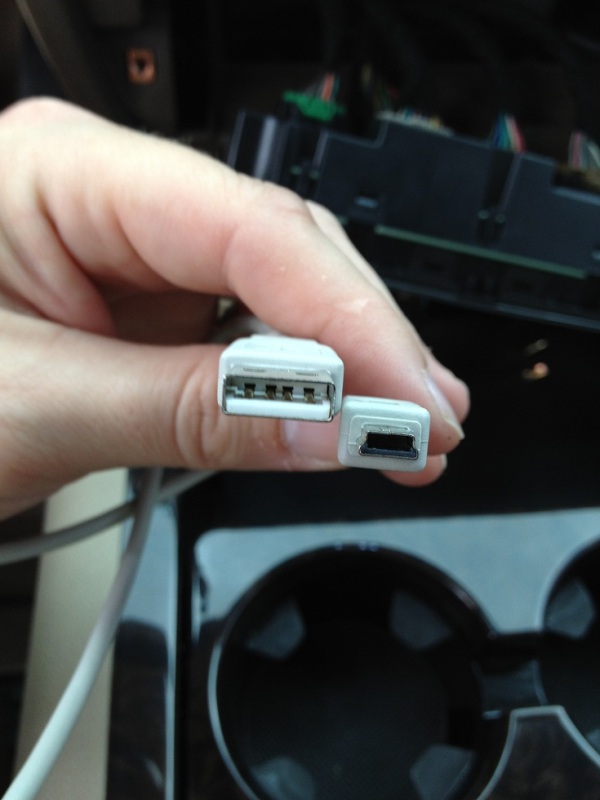

That's what I have to use now that I have my ipad mini. Basically you take the plug out of your car and put the OEM usb plug in there. BEHIND the dash you put the plug back together and that USB charger piece in there.
So you'll get to this point...
and then plug this cable
in to that piece you linked to and the other side to the back of the OEM plug and put it all back together. I took the piece you linked and used electrical tape to make sure it didn't move or come apart behind the dash.

oh ok...makes sense!!! thanks !!
no problem. When I did my iPad mini install, I lost this function. I don't need it for the "storage" or input anymore since I have the mini, but it's nice to charge my phone by just throwing the USB on it instead of having a regular charger or even the piece you linked always sticking out.

Exactly how Nathan said is the simplest way.
