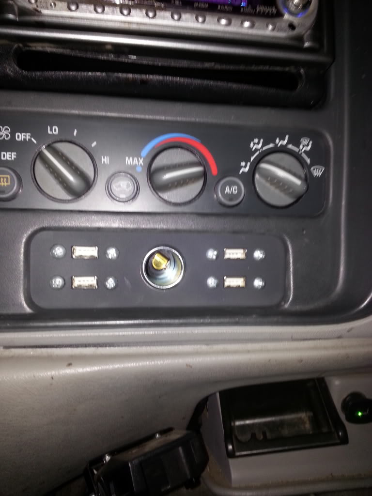

This is on my to do list! I've got a USB port in the center part. Should I be able to use both USB ports? Like add a splitter? Or am I just better off with one?
What you should do is connect a powered USB hub to the cigarette lighter behind the dash (which will be unused anyway), and then run a wire from the radio to the USB hub. Then you will have multiple USB ports, you can have one in the dash and one in your console. If you aren't going to be powering anything significant, you can use any old cheap USB 2.0 hub that is not powered. You will have issues with splitters most likely. Let me know how it works out. The interesting thing is, will your radio support to USB devices? How will it know to switch between them?
