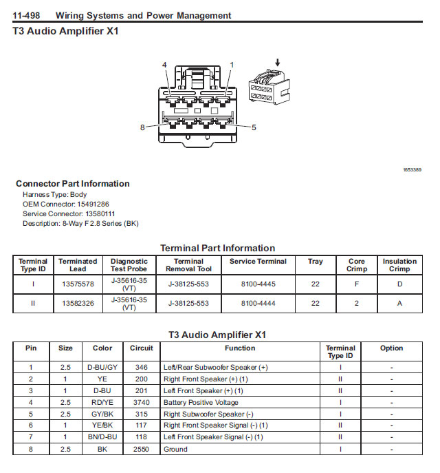

The subwoofer. There is a guy on here that posted the wiring diagram of the factory amp. One thing that is nice with the lc2i is that it will turn on your amp as soon as there is power so you don’t have to run a remote wire all the way to the front for your amp. But some newer amp already have that built to them.

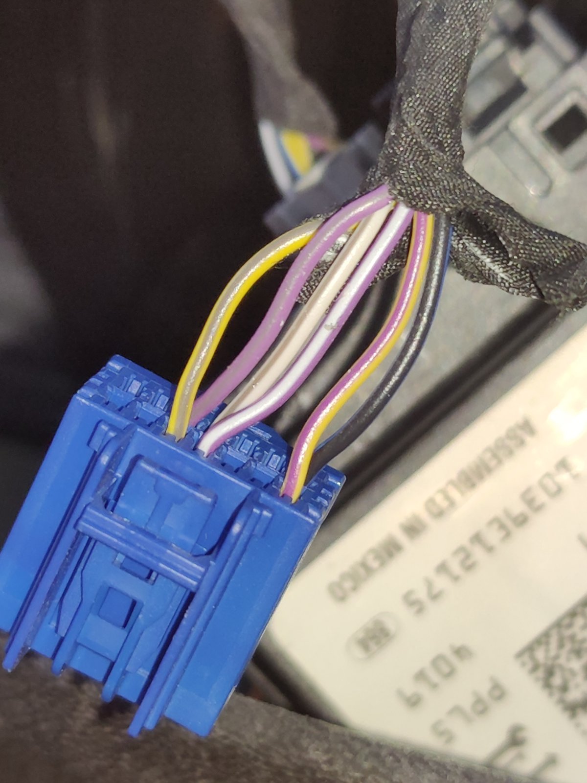

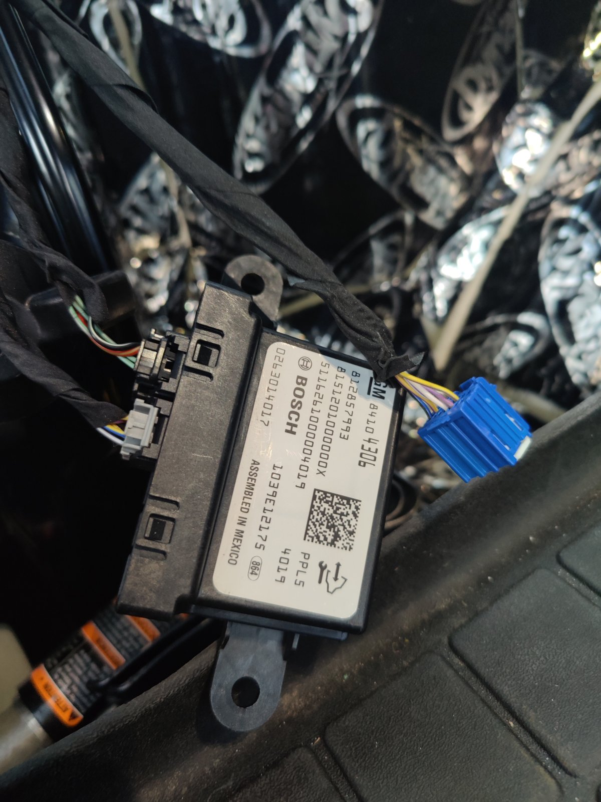

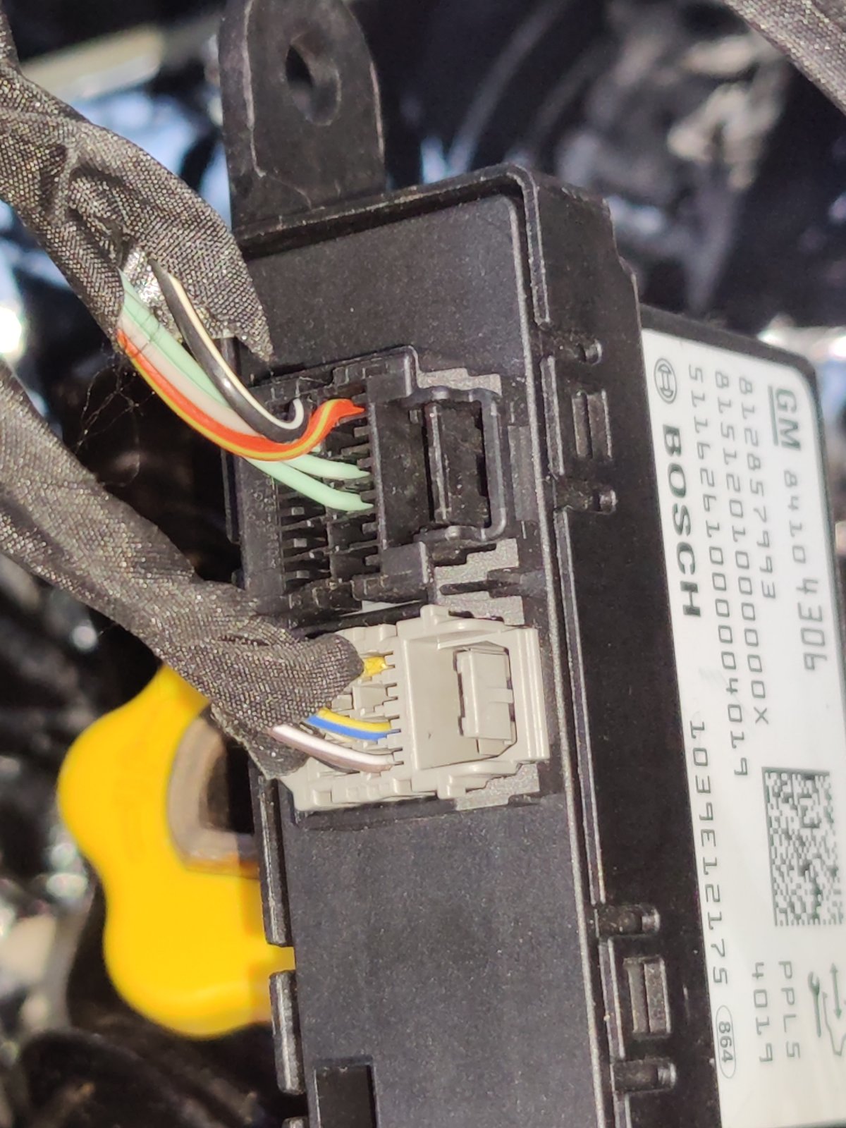

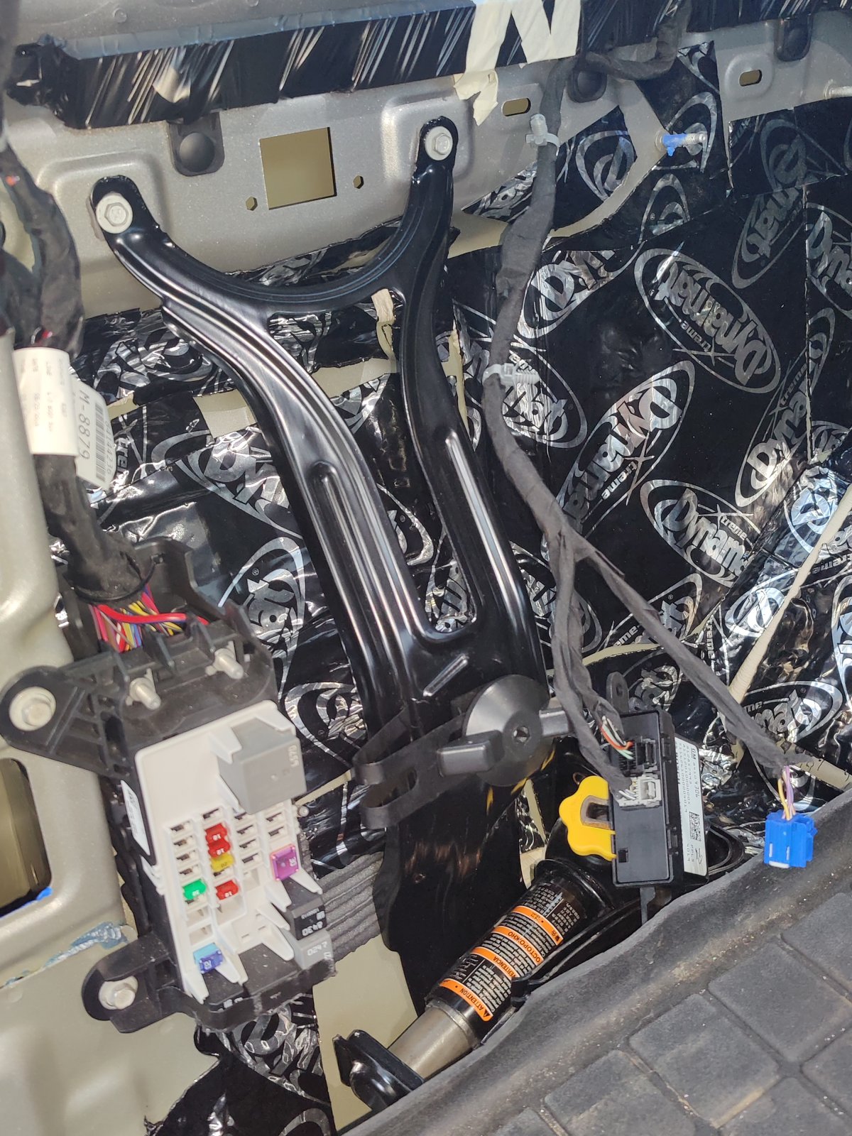

Sorry to have to revive a dead thread but I've been searching the forum looking for an answer and can't find one.
Read thru the thread I am posting in now and also: https://www.tahoeyukonforum.com/thr...-oem-kicker-200w-powered-subwoofer-kit.93525/
'17 burb LS - no amp. There is only 1 module at the back of the truck. Also 1 plug. I used a test light and tried hitting each wire with key on and off and got nothing. The diagram in this thread shows an 8 pin plug but mine is 14 or so it seems.
From this thread or the "Kicker Kit" thread I have been looking for a blue/brown wire. The instructions form the "Kicker" thread talks about wiring for those with the factory Bose amp. But I don't have one to work with. I had originally thought the plug in the pics below was that factory amp harness but I guess its not.
Any help would be appreciated cause I need to hook up my Scoche LOC90 for high to low convert. I just built a custom fiberglass enclosure for a Skar shallow 12 and a Skar amp. Need to button up the wiring for the amp and then just run power and I am good to go. Thanks in advance.
IMG_20210505_190404.jpg IMG_20210505_190525.jpg IMG_20210505_190535.jpg IMG_20210505_190555.jpg
