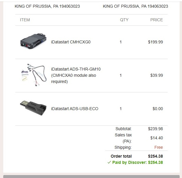

Damn I wish I say this a few days ago. I jumped off a cliff and went with a kit from Crutchfield.

The Crutchfield install was a JOKE. DO NOT GO THAT ROUTE. I am returning that clusterF setup and will be trying the Amazon kit you posted. Stay tuned... :mad::mad::mad::mad:
