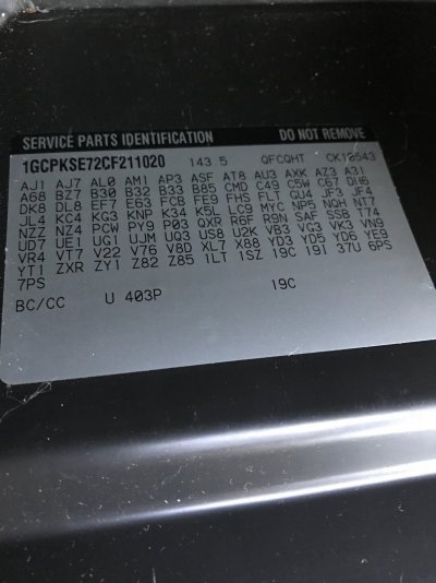

I have done this project on my Tahoe and here is the process and information on installing my mirrors and repairs.
So you have to buy the folding mirrors simple to find they have 2 connectors also has a sticker saying DL3 (you will need the door harness for side mirror turn signals to work, or lazy way is to run a turn single wire to each mirror and find a ground.)
You can go 2 ways.
1. Buy new window switches BOTH driver and passenger and program them to a Vin number that has power folding mirrors.
Part # Driver - 20835553, Old numbers 15906881, 15093440, 20877336, 25783951 (there is a couple others but cant find them)
Part # Passenger - 20835554, 15093445 Old numbers 20877339 (there is a couple others but cant find them)
2. Buy used switches from a power folding mirrors SUV with RPO code DL3. Make sure to get both if buying from a junk yard ask them to send you the RPO code list in the glove box. You can PM me the Vin and I can check it for you if I have time (Holidays). Driver side is easy to spot if it has power folding mirrors. The hard part is finding the passenger side it could have the part numbers listed but be careful they can be used but not programmed for folding mirrors. I would check Ads that list the vin numbers or RPO code sheet or email and ask.

DL3 - OSRV MIRROR W/DRIVER SIDE AUTO DIMMING, PWR FOLD & ADJ, HEAT, TURN SIGNAL (REPLACES STD/PKG MIRROR)
Also it is very common for the plastic gears on the power folding mirrors to break here is a website that selling the gears but in brass or ready to go motors. (recommend the Pre-Attached Gears + 2 Motors)
