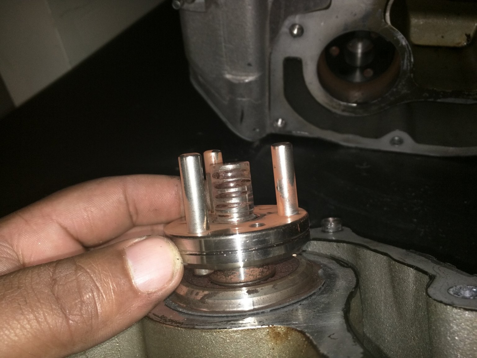

Still still awaiting parts... This is the reason why you have to p change to a solid coupler/isolator

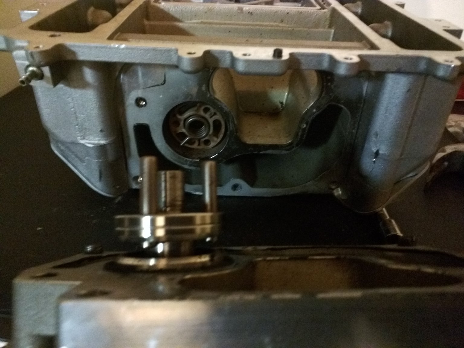

Front snout pulled off of blower and spring coupler/isolator that needs to be removed.

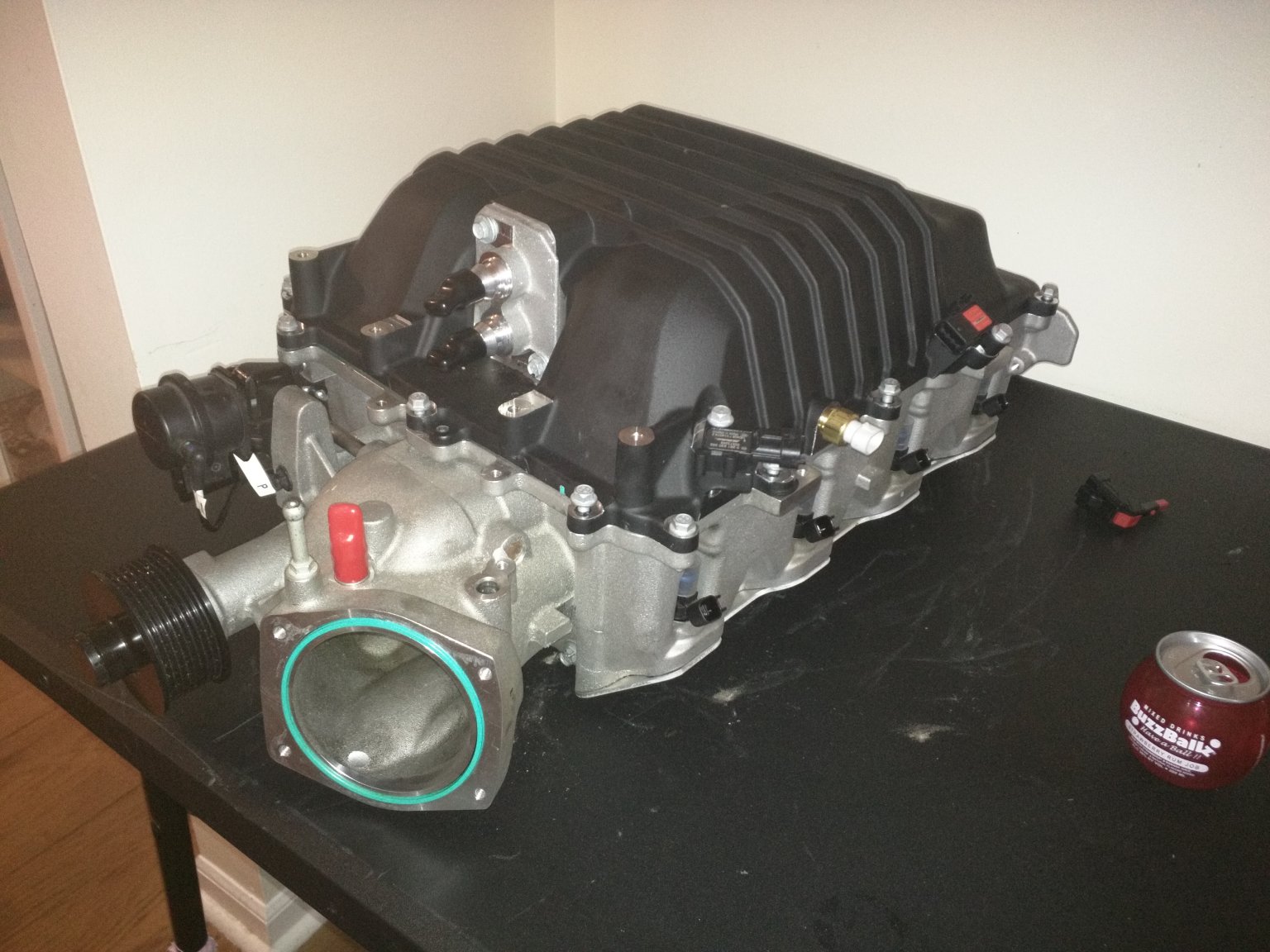

I found this thread after trying to buy your hatch glass and now I've been looking at these blowers. Now I want one! Well, I'm just looking for now and learning. I've been considering a cam swap on my LQ4 but am interested in one of these. Keep us posted on all that's necessary. So far I know I need the blower, lid and lssimple kit. What else ? Also, any idea of HP with this? I have to consider that I have a 4L60E tranny that might not handle it as well as my Denali transfer case. But I can still dream.

Don't forget Injectors, coolant pump, fuel pump, heat exchanger, coolant hoses, coolant reservoir, and a bunch of other odds and ends. Blower are good for at least 400+ up to 700 with supporting mods

that's weird... I wonder if it has something to do with cutting down heat soak / transfer for the LSA? Any other major differences? Curious...
Ninjas... where we tuning eh?
The main differences I believe were that it used a different and better grade aluminum and that wing. I can imagine a denser better aluminum would reduce heat soak but no I dont know about that wing.

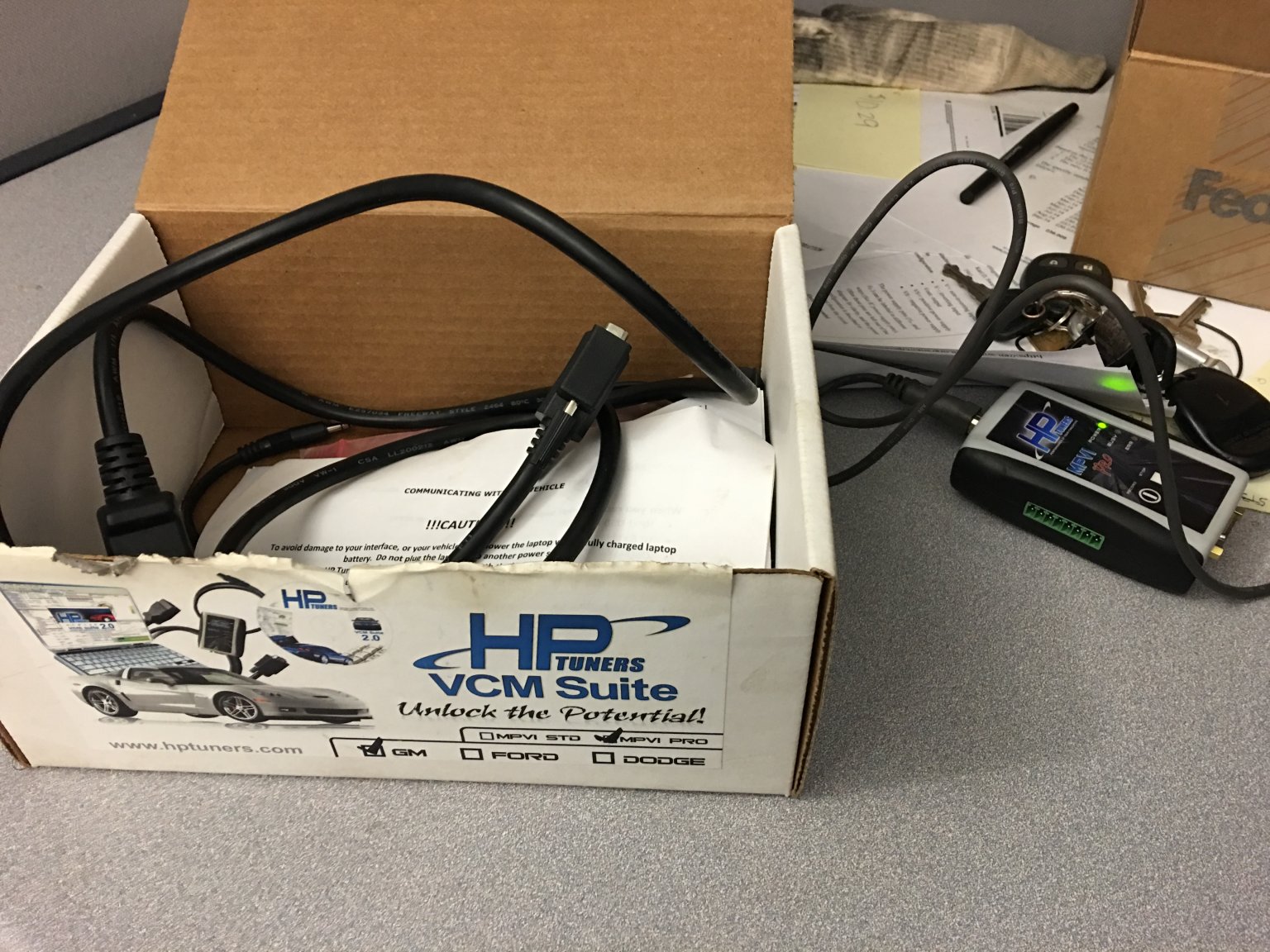

Update** currently looking for hp tuners pro used and have been searching various forums looking for one... Let me know if anyone knows where i can find one. Thnks!!

Updates!! well kinda....Was speaking to a guy locally that has Hp tuners available and im going to meet up with him this afternoon to trade for it. Im completely stoked!! I dont want to give away the details quite yet.... dont want to jinx myself :secret:
