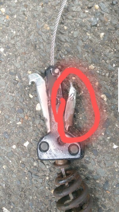

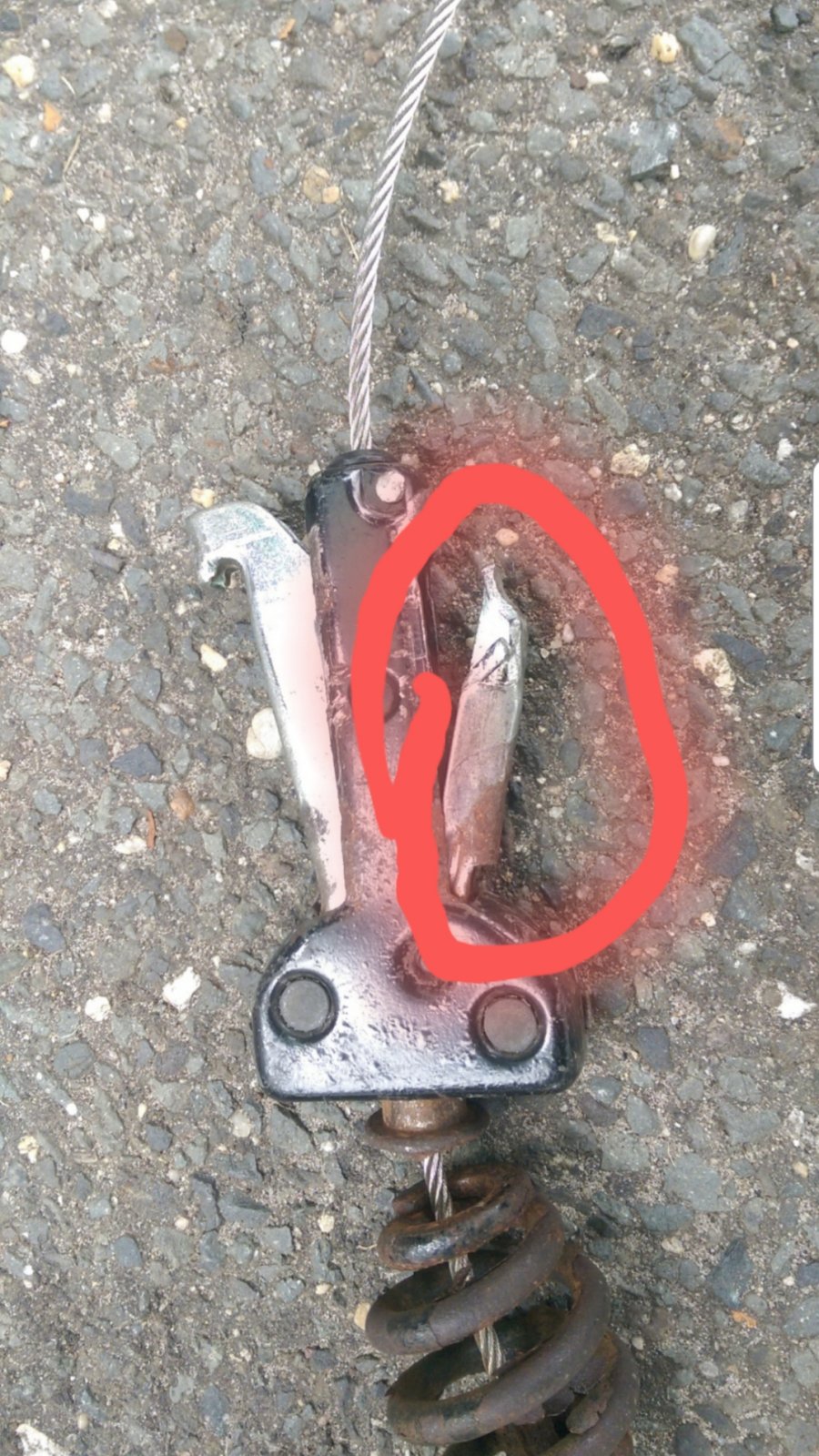

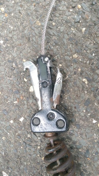

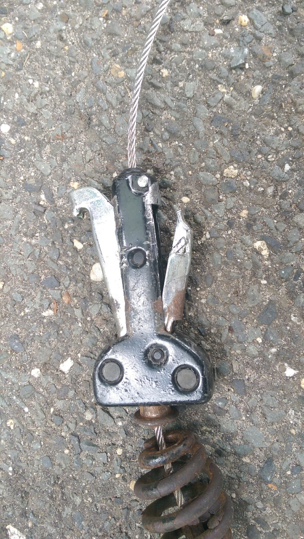

It’s probably already been replaced at some point with the newer design that does not have the secondary latch. In which case it’s probably since rusted again and the winch is jammed.
They don’t cost that much, I’d do whatever destructive method works for you and your toolset and just replace it.
I got my OEM one to release the wheel by bending the flange that flares out in the center of the wheel opening. If you have a die grinder or dremel cut the cable end off. A fire wrench (oxy acetylene) would be even easier.

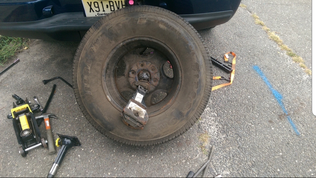

Tony! Where have I seen these pictures before? Let's see.....HHMM...Oh, yeah, I had the same problem. To get the spare tire to unlatch I put a 12 ton bottle jack under the spare tire (centered) and literally lifted the entire rear end of my Yuke 5 inches off the ground before the spare tire unlatched. After which I cut the locking mechanism and haven't had any problems since. Seems to be a recurring problem throughout the years for GMC trucks. Nice pics by the way!! Aloha!!!
