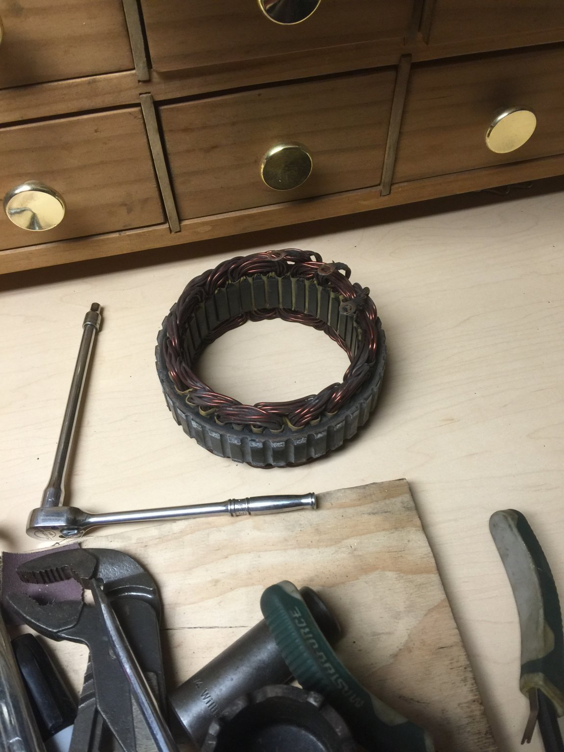

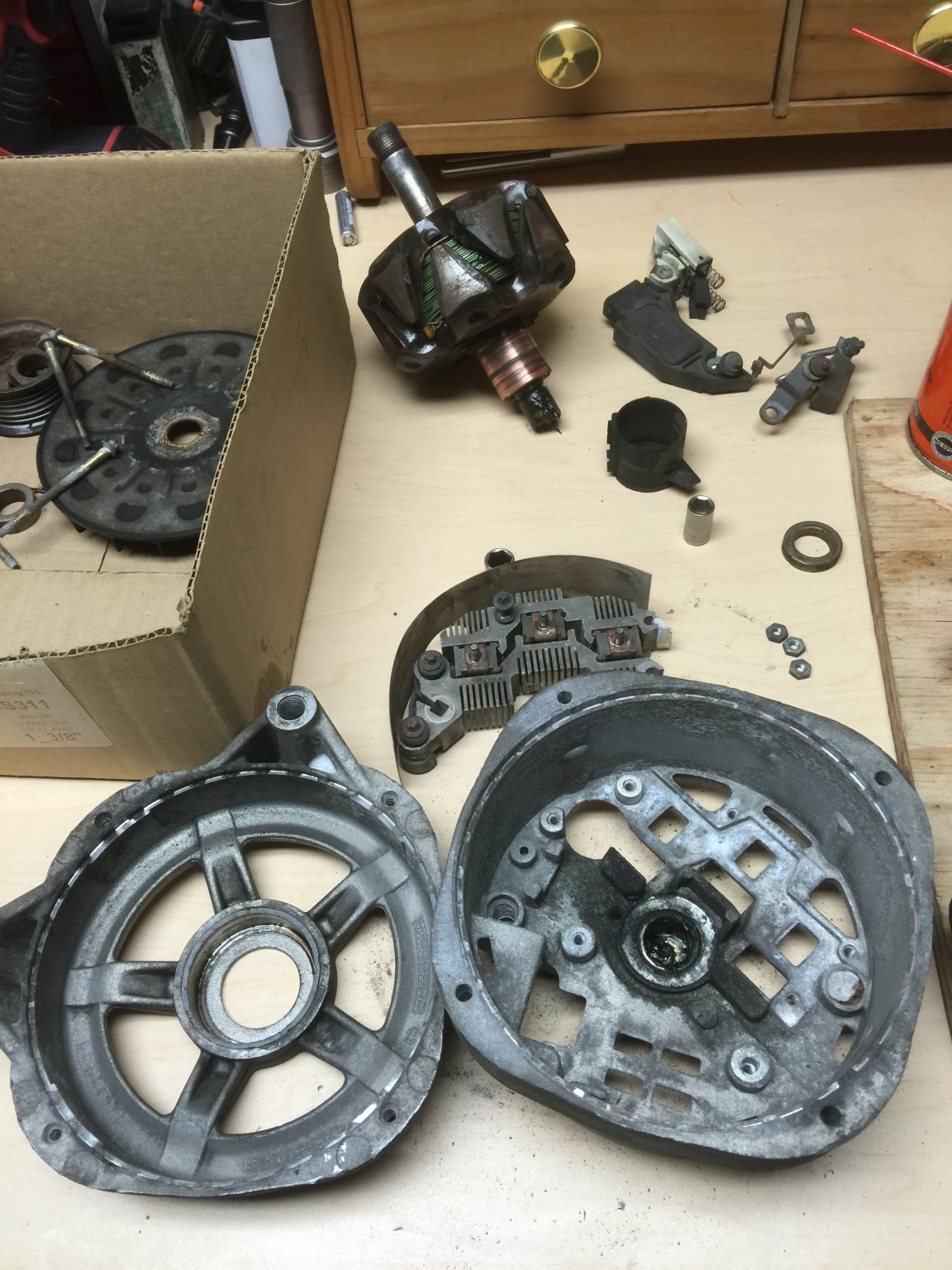

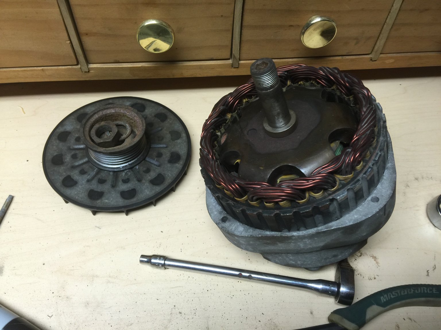

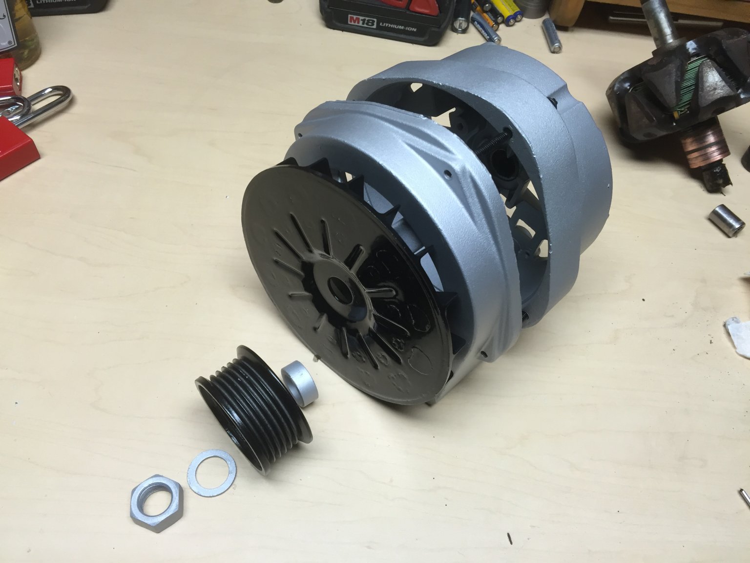

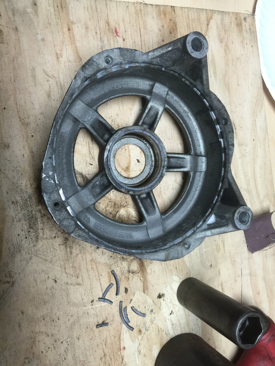

Tuning shop said its gonna be 4 weeks before I can get in there. Screw it, I'm ordering the tuning software and doing it myself. I've been reading everything I can get my hands on, I ordered 2 books on tuning with HP Tuners and watched numerous YouTube videos. In the meantime, I went after this damn squeaking noise. It's not an idler or the tensioner, it's the damn bearing in the alternator. The thing still charges so I refuse to buy a new one. I tore it down, cleaned up the armature and bushings and popped out the front bearing. New one ordered and will be here Wednesday. Also I'm contemplating ordering 1.6 rockers so I can change them when I install my new fabricated valve covers. Gonna order tuning software 2mrw if I don't hear back from my brother. He has done some work for the guy that owns HP tuners and I've actually met him too. He sold my brother his wife's car and I took him to go get it. Guy lives about an hour north of me in Deer Park IL. Had a bad ass Lambo in his garage and a road racer Viper. Dudes like mid 30's and has life by the balls. So anyway, my brother is gonna see if he can get me a deal on software with as many credits as he can get me. Otherwise I'm just gonna go ahead and order the Pro version with 8 credits. He's got until 2mrw to let me know.

Ok, now it's ready for blasting and paint. Might just change the brushes, regulator and diodes while I'm in here. Still be cheaper than buying a new or reman unit.

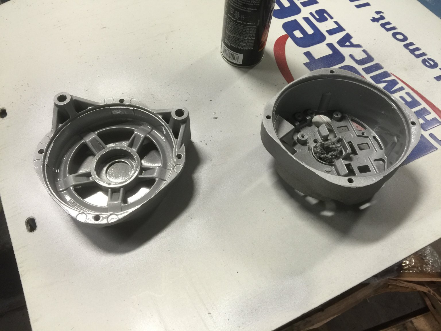

Housings, pulley, spacers, nut, washer, fan and bolts are all painted. Ordered a complete rebuild kit which should be here Friday. Went ahead and ordered tuning software tonight also. Think I'm gonna buy myself a new laptop for tuning and also for my Bendtech Pro software. Something cheap like an Acer.

How much is a rebuild kit? Compared to buying a rebuilt alternate?
$48 shipped for rebuild kit. Bearing showed up but I couldn't find it in me to put old parts back into this thing and only change the bearing. I figure half the cost of a new one and everything is new now besides armature and stator. But this thing charged fine, it was only squeaking. My luck, sure as shit if I changed just the bearing it would stop charging a week later. I'm waiting for software anyway might as well do something.
