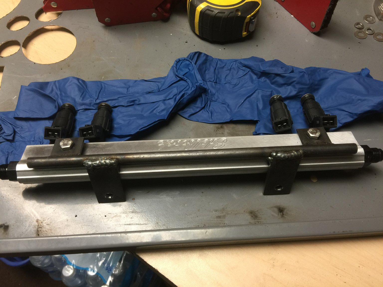

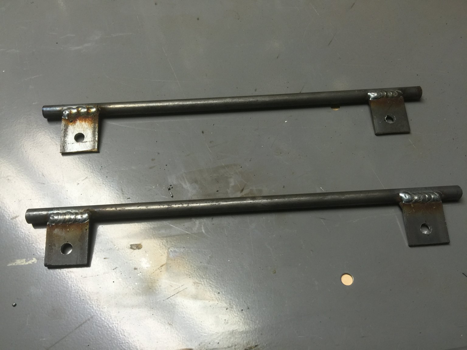

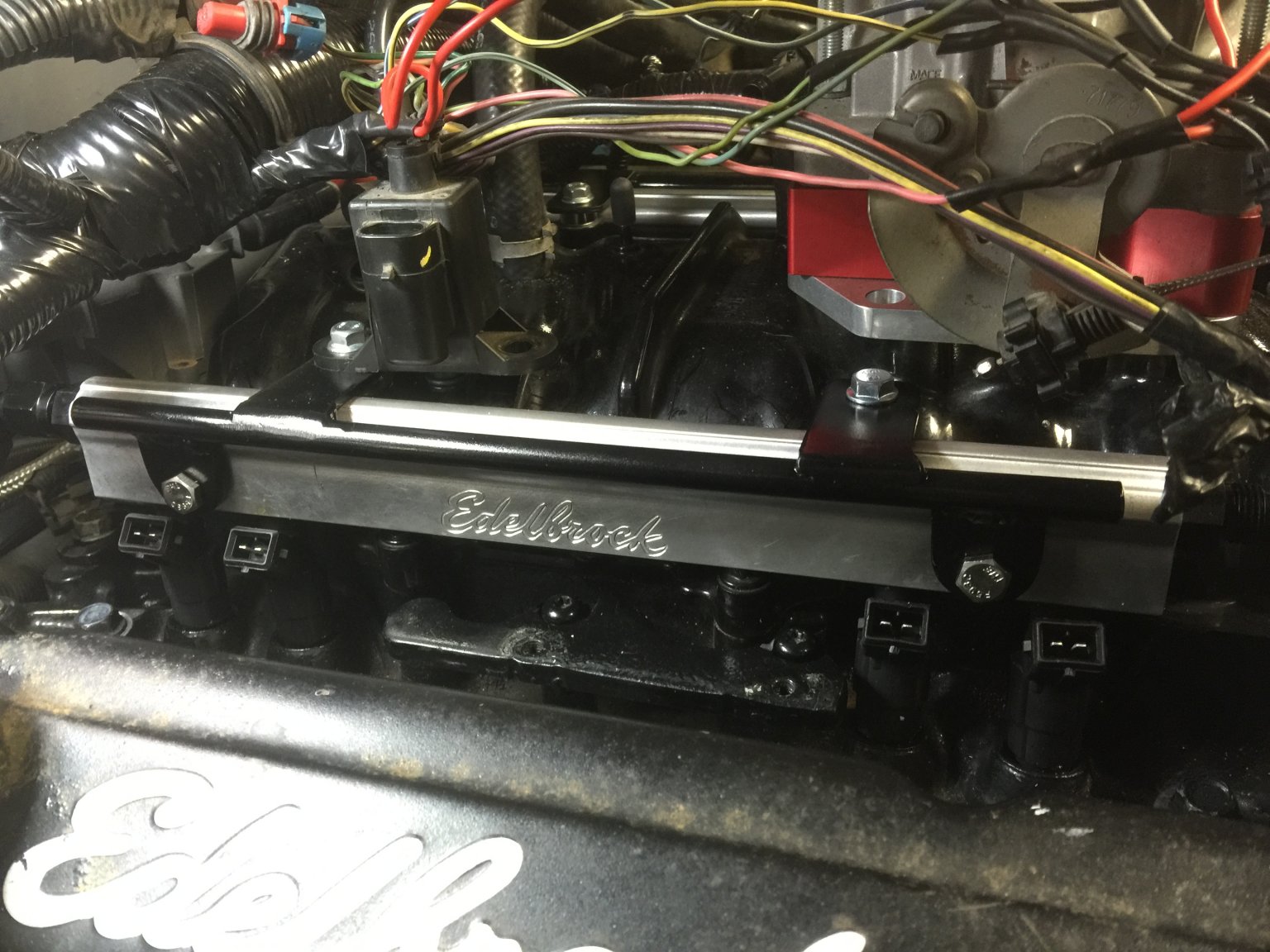

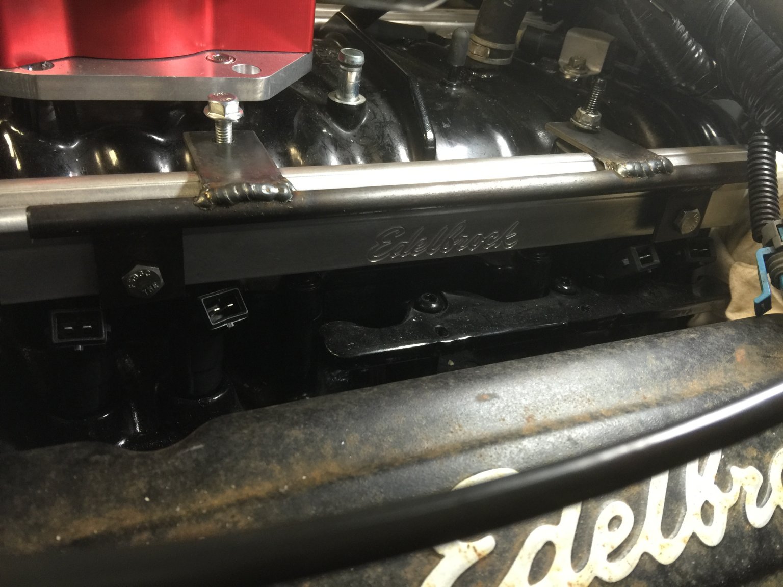

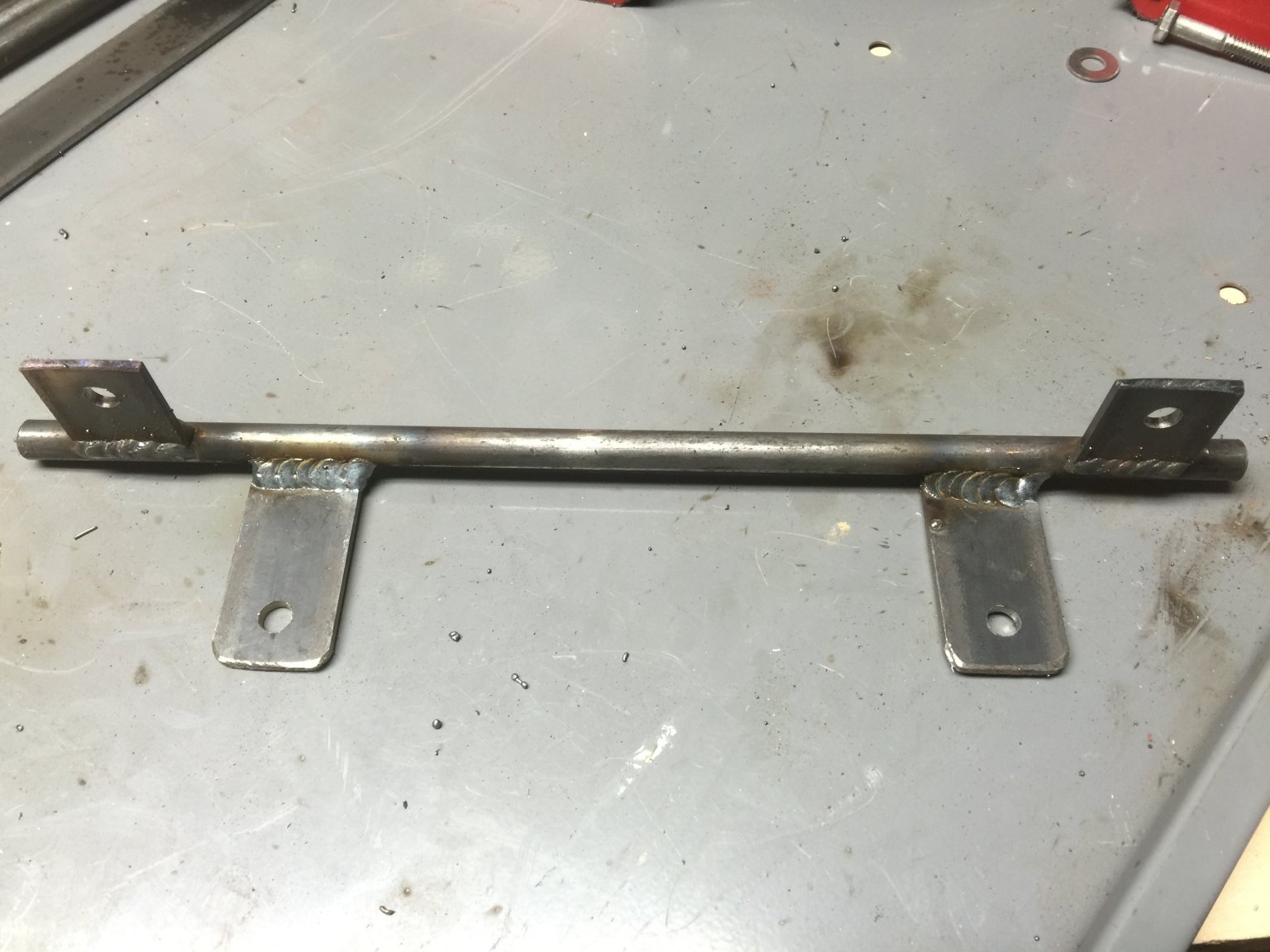

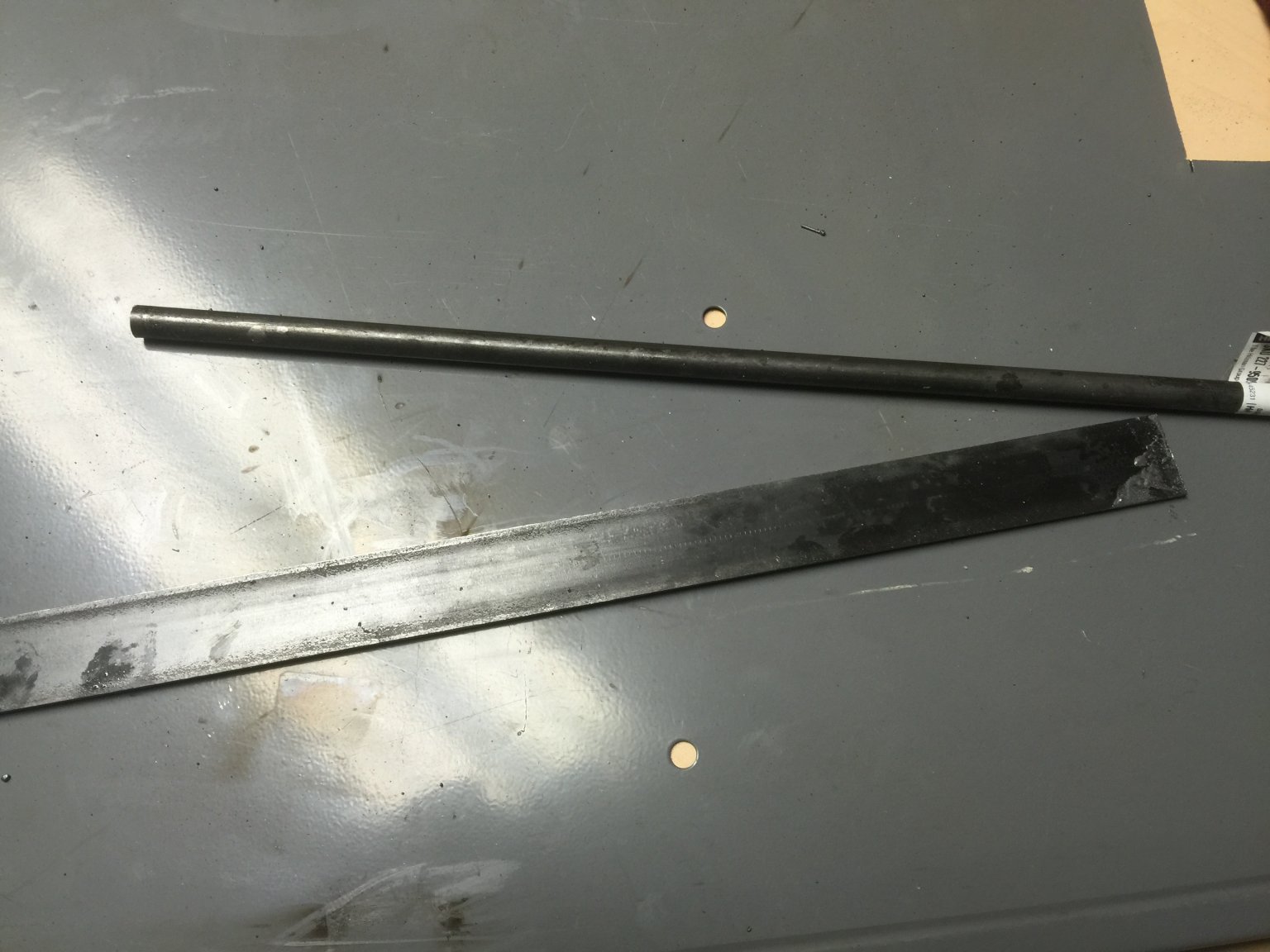

Didn't do much of anything Monday. Came home from work and fell asleep downloading video. Yesterday I worked on getting the fuel rails tightened down. At first I just took some 3/4" rigid pipe clamps and tried holding the rails down just to check for leaks at rails. It just pissed fuel past the injector o-rings. The rails were cocked on the injectors and not completely striaght so I had to remove them once again and came up with a plan to remedy this.
I took some 1"X1/8" flat stock and 3/8" rod. Cut 2 pieces of the 3/8" rod to 11".
Then cut 4 pieces of the flat stock to 1-1/4" and drilled a 1/4" hole in it and welded it to the rod.
That will bolt to the fuel rail. Next I test fit the rails to make them straight and measured for the rod to mounting holes tabs. With the bracket mounted to the rail on the inside, it was really close to the mounting holes on intake. So close that it was actually contacting the mounting hole base and not allowing the rail to lean in toward center enough to get injectors straight so I had to relocate the bracket to the outside of the rail and make tab for mounting hole on intake go over the top of the rail. Pictures are worth a thousand words and this will all make sense when you see it mounted. But anyway, here's what the mounting bracket ended up looking like when finished. Blasting and painting tonight and pics will show it mounted 2mrw.
Definitely not my finest hour but they are fuel rails, shouldn't need much to keep them in place and leak free. Stay tuned.

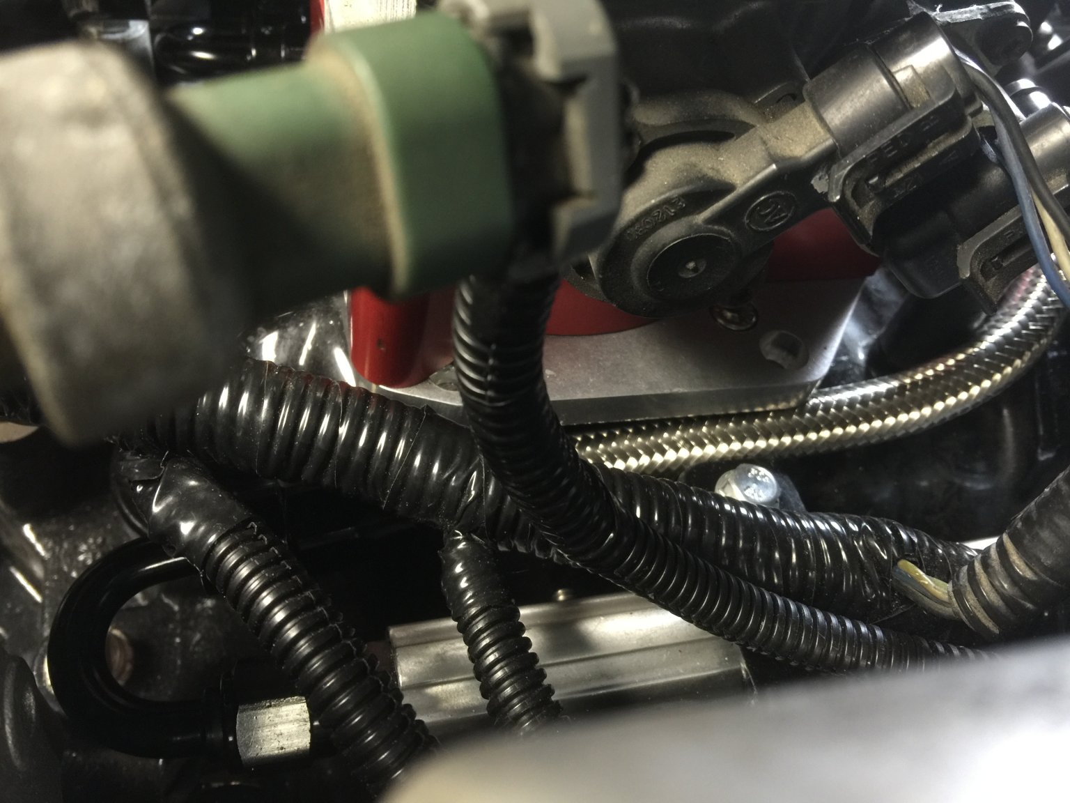

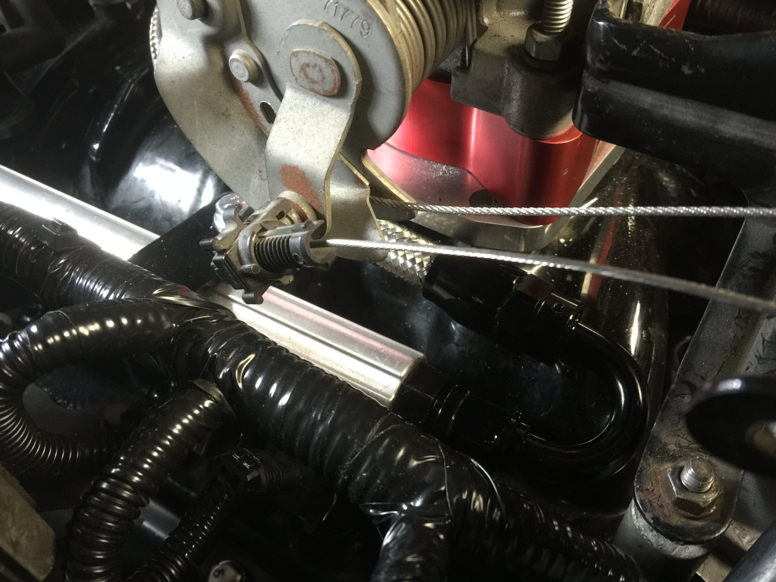

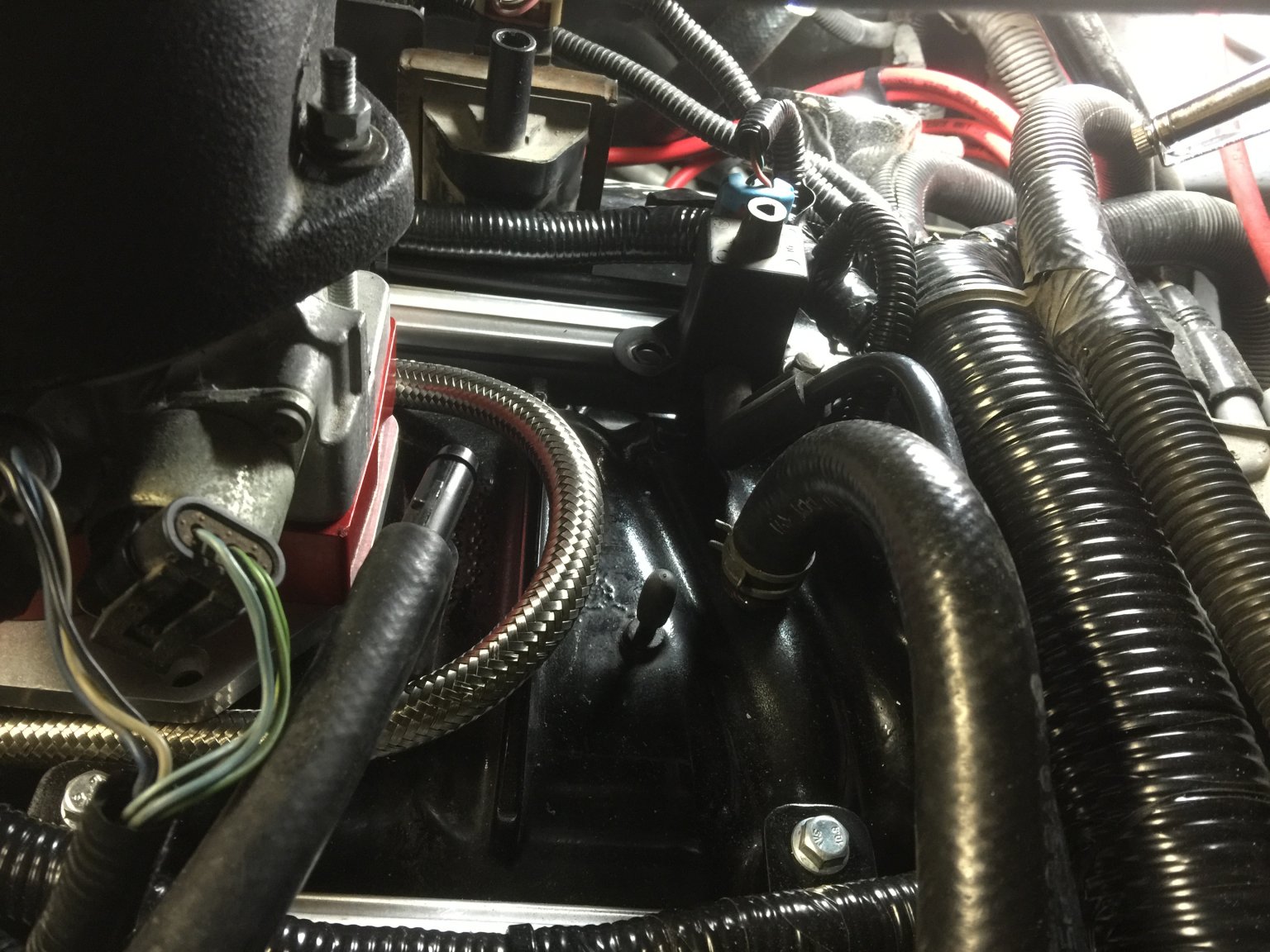

Hose is on and it holds pressure now!! Sweet, glad that's off the list.
Drivers side rail. You can see the 180* fitting and hose running along side of throttle body mounting plate.
It loops behind the TB.
Then over to the passenger side rail.
