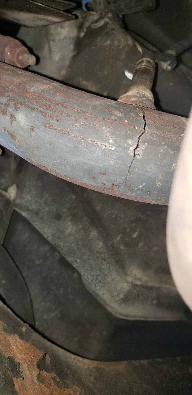

I did not go with magnaflow.. I ended up buying a full bolt in set from flowmaster. looks and sounds great. All the bends were perfect. Did it in my driveway on ramps in a hour and a half. I should of took pictures but.. I found multiple cracks in the stock pipes.. so If your running stock.. Id say go ahead and buy the full bolt up set so you have that piece of mind.
