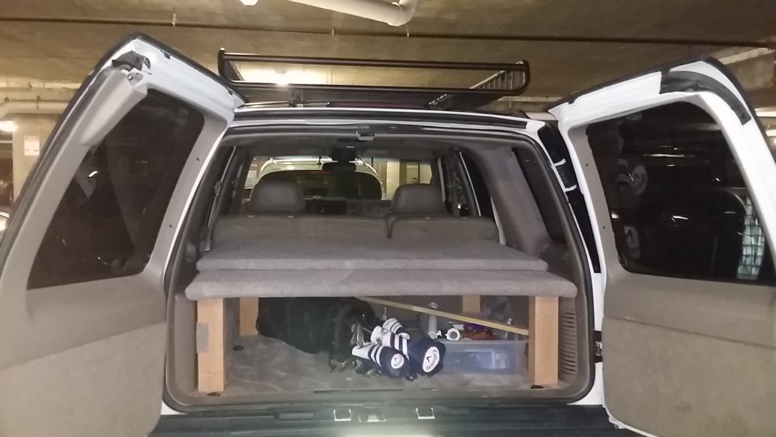

Built a sleeping and storage platform (pictures to follow on this and the other mods)

For the mountains... the sleeping and storage platform. This needs some work but it is a starting point. The top shelf extends to just behind the front seat for 75" of platform when the rear seats are folded down.

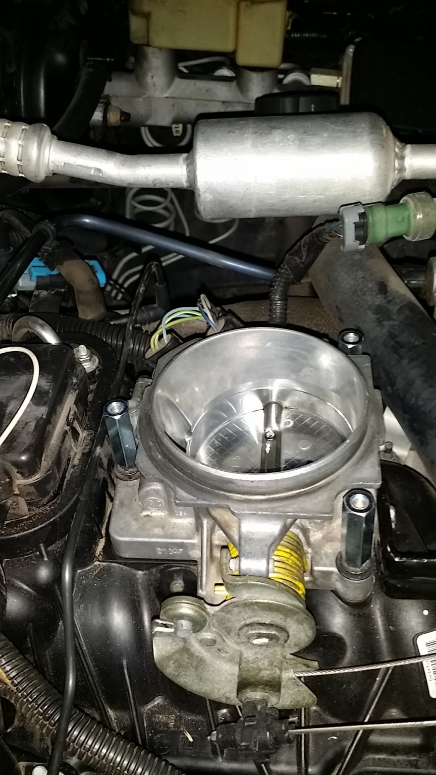

Looks good. With the bottom plate of the throttle body flapper that black, I would suspect your fuel pressure and spider injectors would need to be replaced. When the fuel regulator goes bad, or the injector lines get brittle and crack, the engine runs rich and probably smokes a little. Its a pretty simple job, but would put you back about $300. It made a huge difference on my 99 Hoe.
Thanks for the feedback. After the Dexcool killed my block, I replaced the motor with a crate motor about 40k-50k miles ago in December 2010. Would the mechanics have replaced the spider injectors as part of that? That seems like a big job to lift the top of the motor off to replace that part. I will check the fuel regulator in the morning and see if there is any of the cold start issues like long crank but I dont think I remember any of that in the past. perhaps the build up is from before the engine was R/R'd. Your thoughts?
If you replaced the motor with a long block (block with heads and no intake, i would suspect they used the same injectors. Check youtube for changing spider injectors. There are several videos that are very helpful.
I just checked my old invoices and you are right. They dropped in the long block 350ci and probably just reused the old injectors. I will check out the videos again but the ones that I saw seemed like it took quite a bit of disassembly to replace those. The engine does not smoke and runs smoothly. Is there any way to tell if I really need to replace the spider injectors without tearing into it?
Honestlu, it it runs perfect and doesnt have anybcold start issues, I wouldnt mess with it. I only replaced mine because of my faulty fuel regulator and hard start issues. It seems you were running rich by the black carbon buildup on the underside of your throttle body butterfly, its entirely your call. If you're happy with it, i wouldnt mess with it.
You are right in your last post. The mechanic ordered and replaced the long block so I am sure he just reused the 140K old injectors because I don't see the new spider injectors on the invoice. That makes no sense but I am sure he thought he was saving me some money. How shortsighted. Knowing that, I will replace the injectors in the next few months because it does smoke a bit.
The distributor cap and rotors where changed at the time of the motor swap about 6 years ago. Would it be wise based on the age to replace those as well at the same time? I am not sure the life expectancy of this hardware. Thanks.
If its been 6 years, i would bet its time to change them again. Just my opinion
