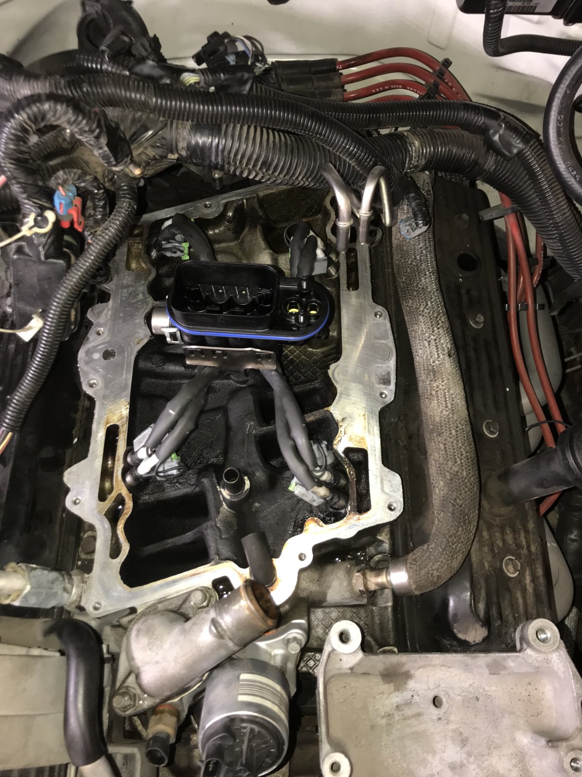

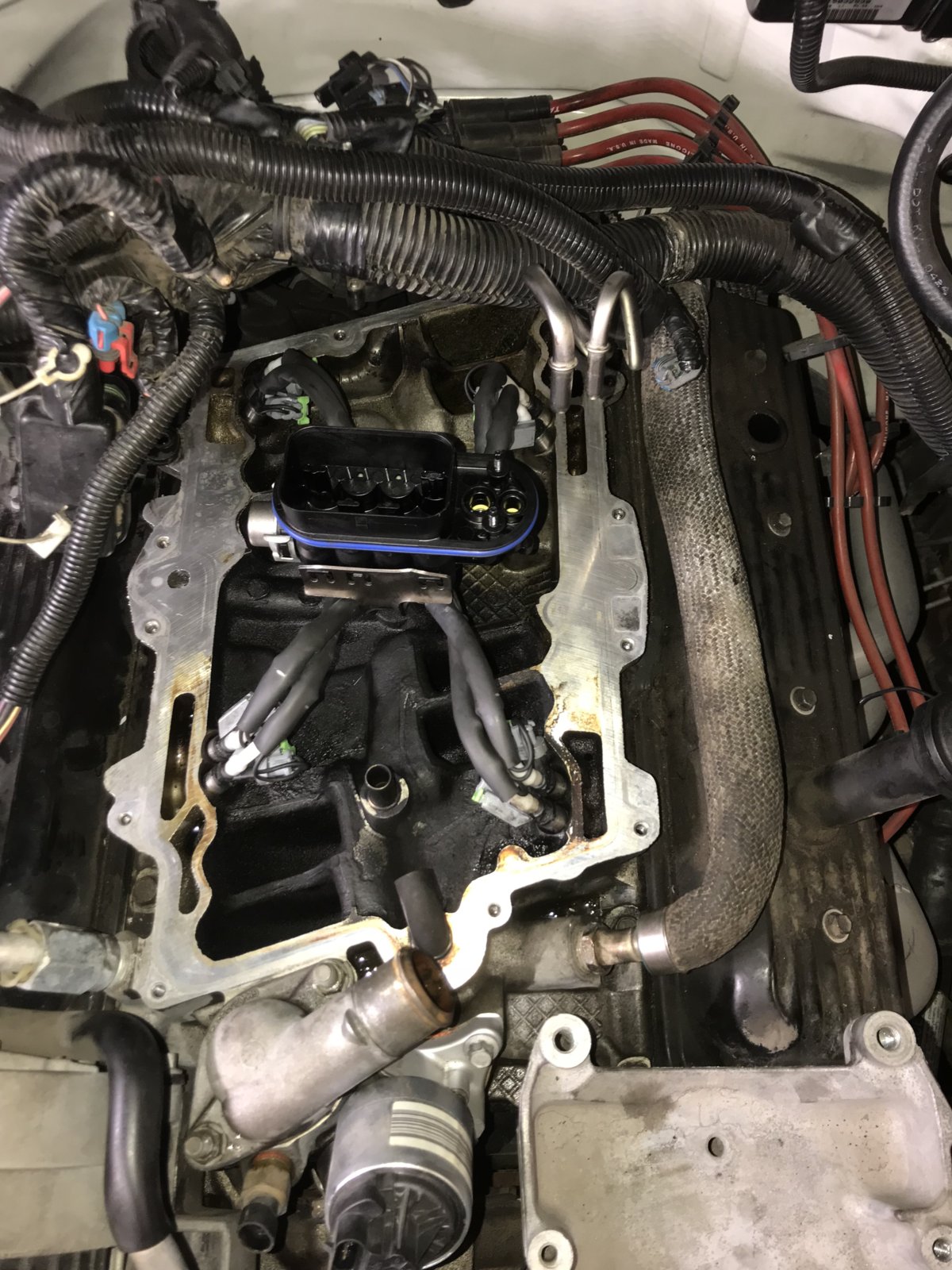

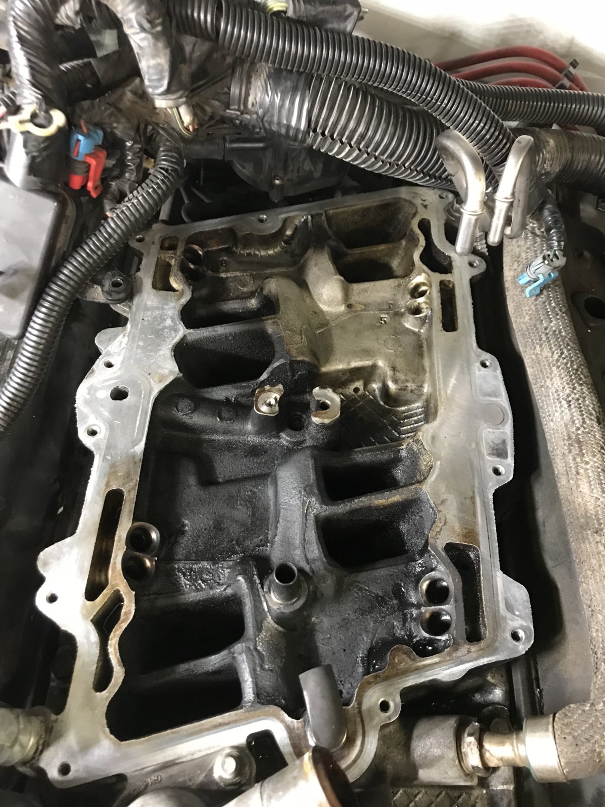

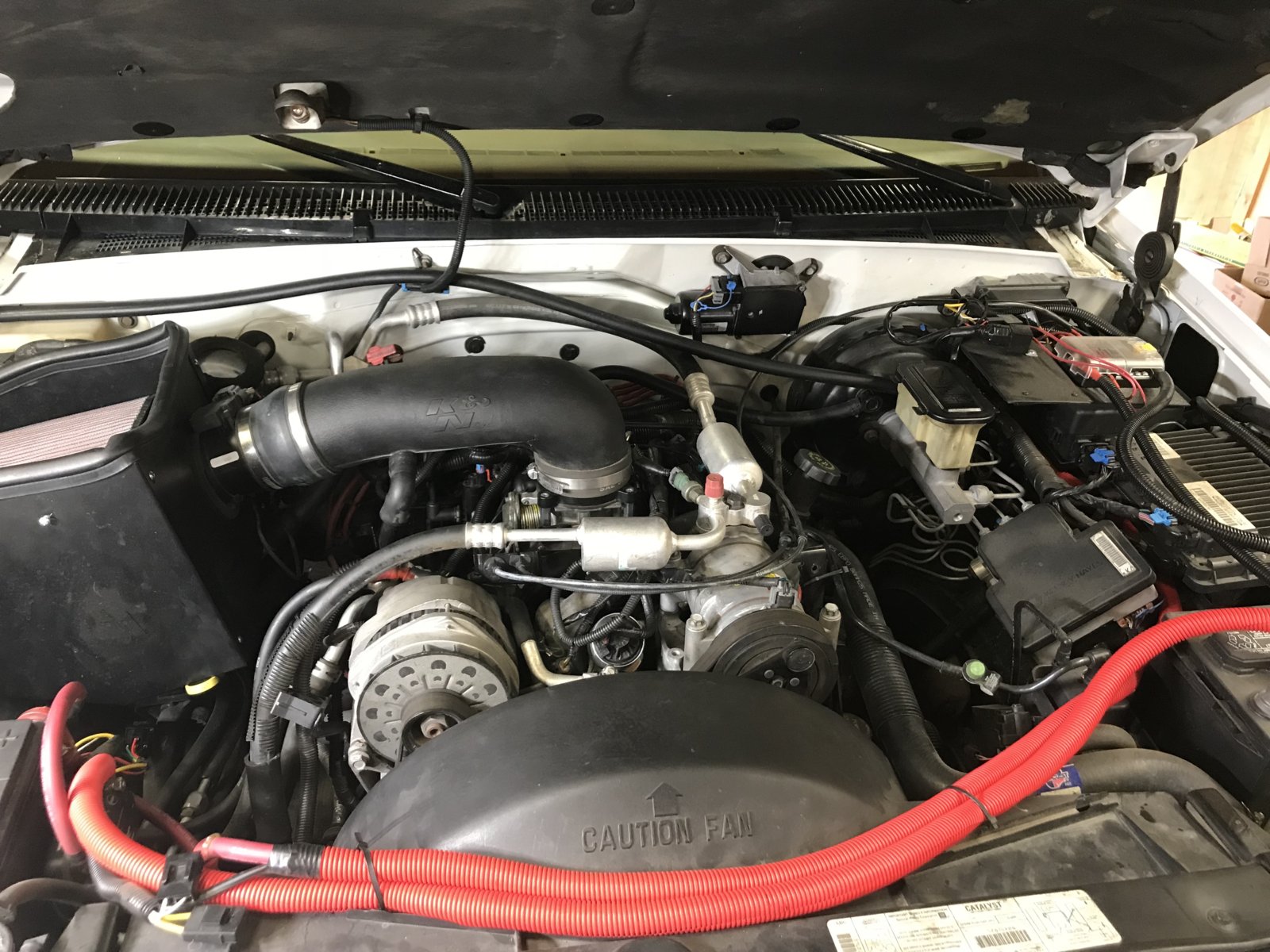

MPFI Upgrade Complete
I finally had the time and space to make the long-awaited MPFI conversion (images at bottom of post). The Yukon was running well but I knew that it had so much more potential, could get better MPG's, more responsive throttle and more importantly, with 199K on the original SPFI, they were long overdue. I knew this long ago when I pulled off the air intake and peered into a black hole of carbon buildup on the butterfly.
The job was about 7 hours from start to finish but much of the time was spent trying to seat the upper intake flush to the lower intake. The spider head unit would simply not slide cleanly through. After a few hours of wrestling, and silicone spray, it seated enough to go through the torque sequence on the studs and complete the seating.
Several videos helped out with the process enormously and I remember Brian on briansmobile1 channel on the Spider Conversion made the comment about "48 or 49 our of 50 still won't make it run right...noting that there are so many electrical and vacuum connections to remove. After I buttoned it up and was proud of my conversion, the first start gave me a P0107 and P1107. I checked my work, reset the codes and tried again. Same result.
This morning, after some research and digging about the MAP sensor issue, I fished under the main hub of wires and discovered that I had missed the MAP Sensor plug. It was hiding from me under that rat's nest of wires. Plugged in and codes cleared, the Yukon drives like a beast.
Post conversion thoughts: More power, smoother pickup especially above 3k RPM...and i expect a solid improvement in MPG which I will post results after the next cross country.
Here are some pics:

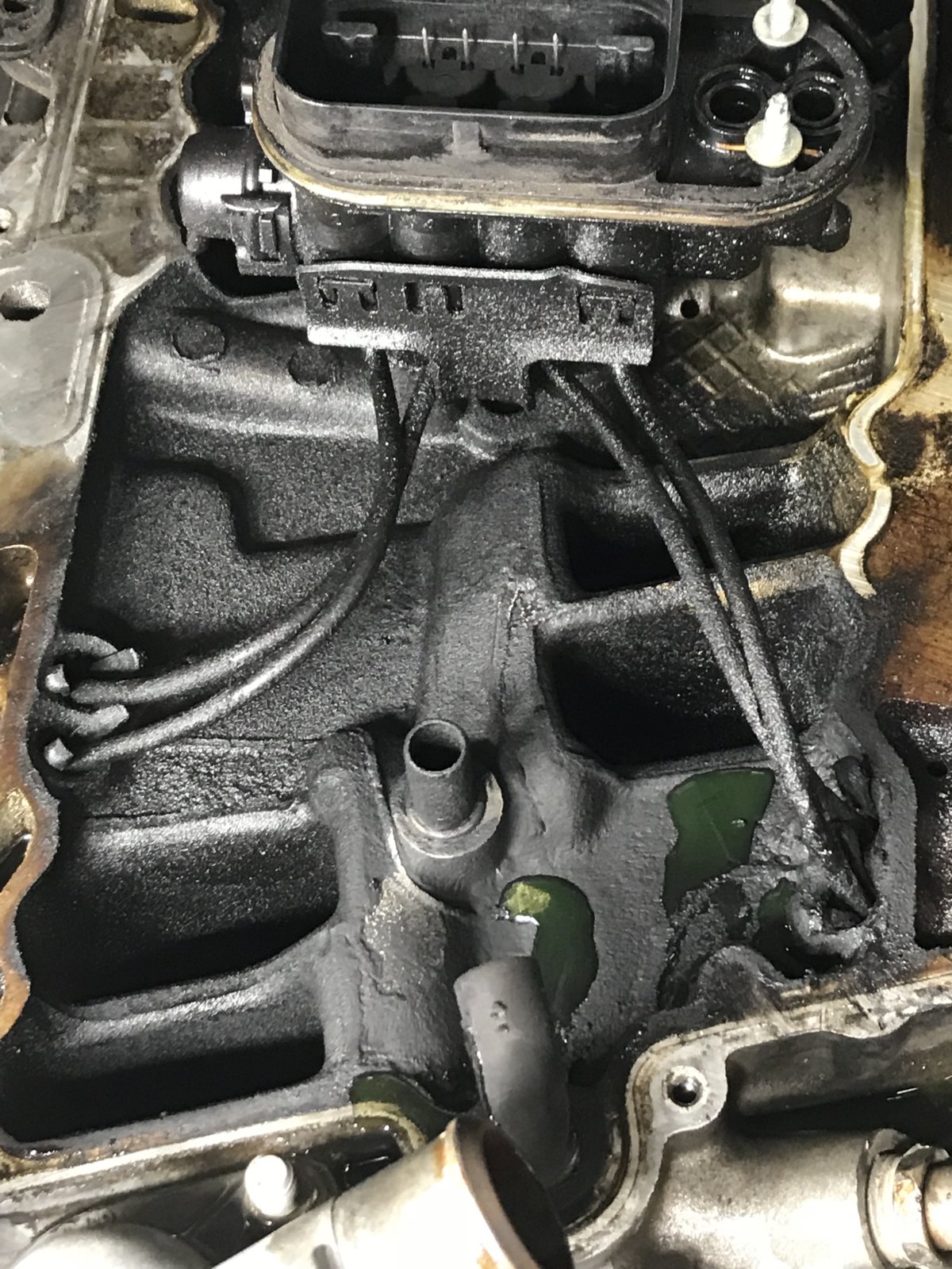

Upper manifold removed
Before MPFI Converstion: The coolant was a bit of spillover from when removed the upper radiator hose. I could not get the upper intake manifold out without removing the hose and I didnt want to drain the coolant.

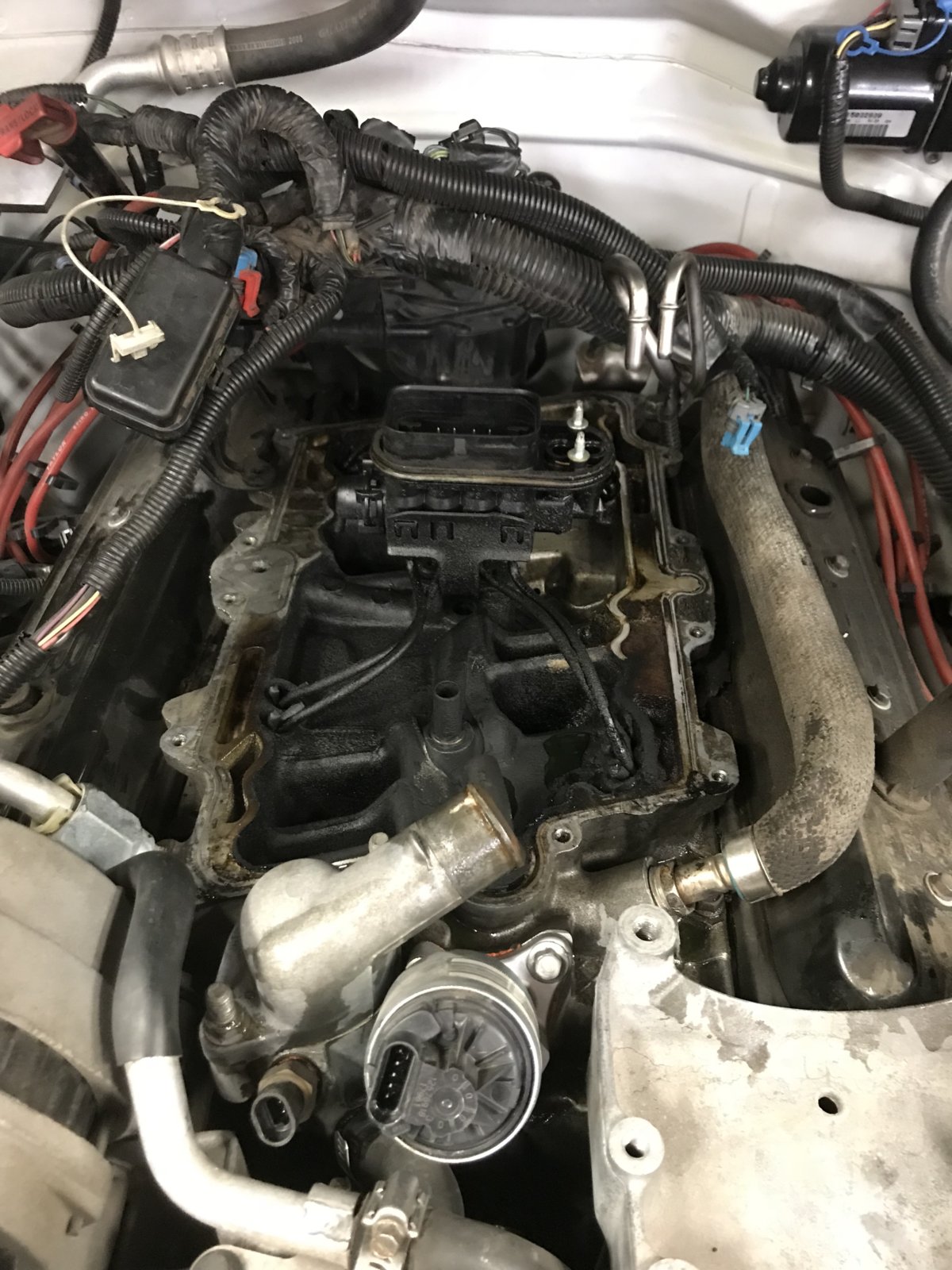

A light cleaning:
MPFI Installed
All buttoned Up:
Final Note:
There are lots of ways to skin this cat with respect to what you have to remove. Taking a few pictures and videos of the engine bay before you tear into is a good idea, especially you have already have some engine mods in place.
Good luck for all those who make the conversion. From my first day of driving with the new MPFI, i recommend it to all OBS owners.
Cheers.
A light cleaning:
MPFI Installed
All buttoned Up:

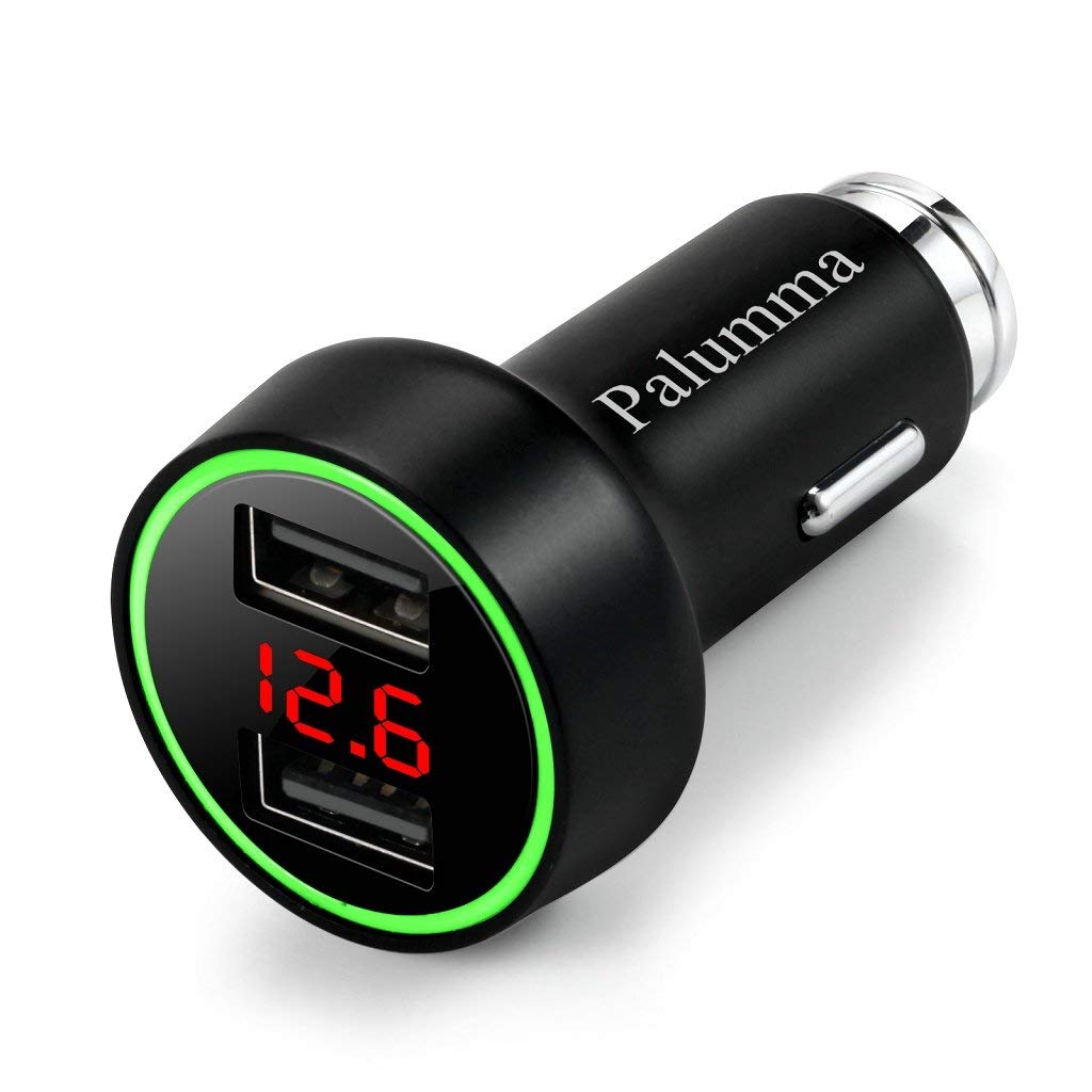

I bought a double USB port plus voltage display dongle. Oddly, it works in the two extra outlets down on the ashtray, but not in the lighter port that's right next to them. I have no need for a lighter, though I won't throw the lighter away, it goes in the console or glove box in case I need to light something and forgot my Bic.
https://www.amazon.com/gp/product/B0773BYS6P/

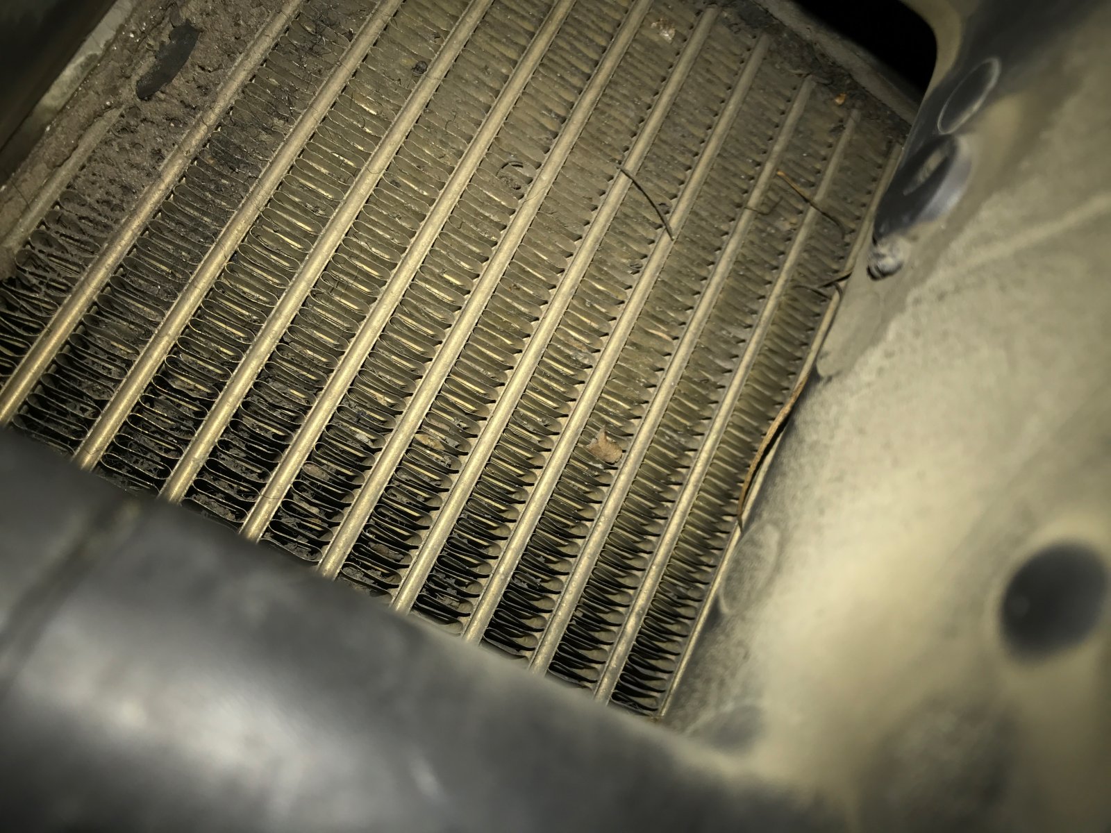

A/C Blower Motor - Blower Motor Resister - A/C Control Panel Switch
It was only 110 deg the other day and my A/C fan decided to stop working. I had replaced the dash control panel just 27 months ago so I assumed that could not possibly be the issue.
The blower motor had been making noise, so I assumed the bearing finally seized. Since I was going to replace the blower motor, I decided to also replace the resistor since they frequently fail.
After r/r both parts, the fan still did not work. I was really trying to avoid spending another $200 on the fan switch but that was clearly the issue.
So $200 later (plus the $90 for the resistor and blower motor), the A/C blows cold again.
At least it gave me the opportunity to clean the A/C condenser! This is after cleaning out the big debris and before spraying the condenser out.
Not sure why there is no prefilter in these rigs. Thanks GM

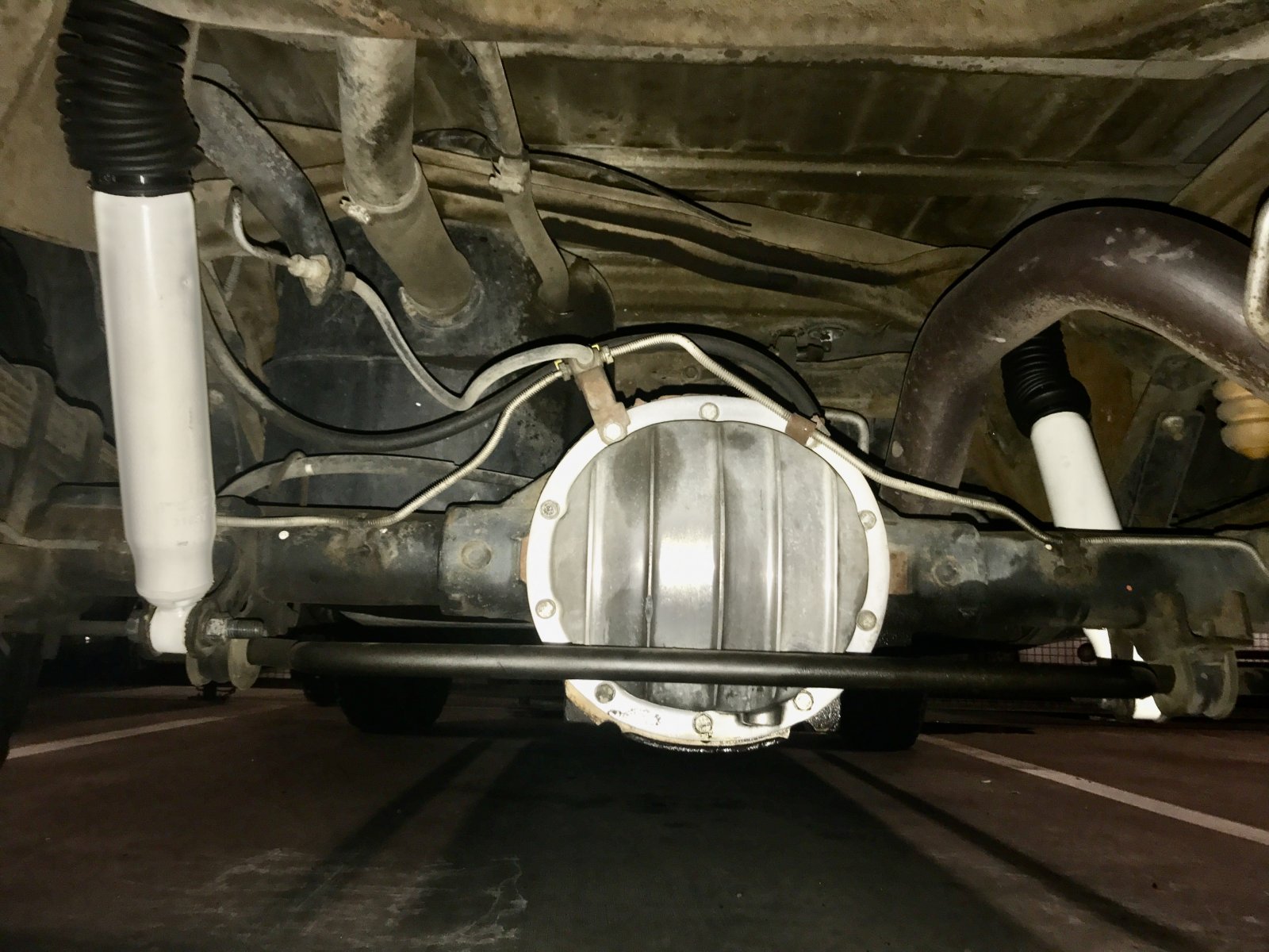

I replaced:
Rear shocks with Explorer Pro Comp ES6000 924509.
Front shocks with Explorer Pro Comp ES6000 918501
Added some Daystar Universal shock boots.
The shocks were due for a swap and these were affordable and gave me some extra length to allow for the slight torsion lift and the extra leaf in the rear.
Replaced front disc brake rotors (AC Delco) and front brake pads (ACDelco 17D369MH Professional Semi-Metallic Front Disc Brake Pad Set)
at the same time I did the shocks.
Rear shocks pics only.

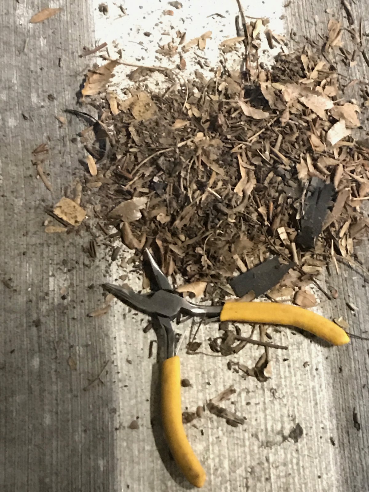

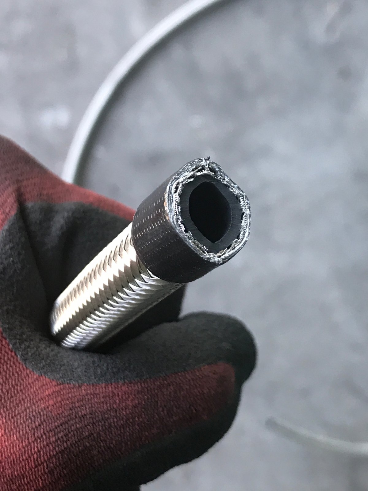

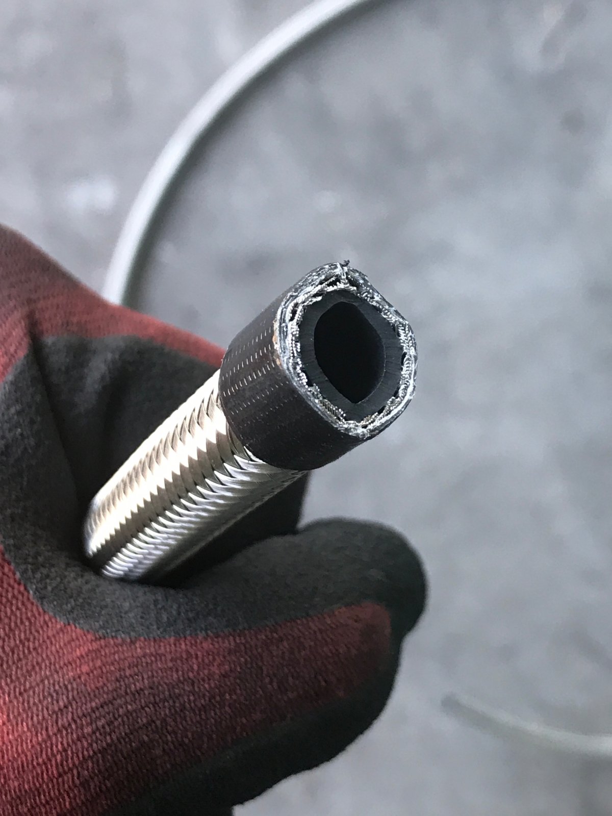

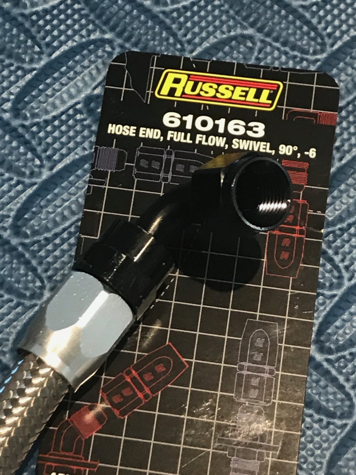

Build the lines:
First, let me say that the amount of fear across the internet over building these lines is unjustified. Having never worked with stainless braided lines, I did way more research than I should have and still, with all the parts laid out in front of me, wondered if I had the right tools to get the job done.
Cutting the lines, according to most pundits, was this incredibly daunting task. Cut off wheel, blah blah...I had none of that. I tried a Dremel with cut off wheels and it sucked and I was not about to buy a $140 line cutter for the project.
I measured the OEM lines at Oreilleys at 53" Upper and 47" lower. I accounted a bit for the additional length of the adapters and fittings by taking 1" off the upper and 1/2" off the lower. I did not want to have the Yukon torn apart without replacement lines but my gut told me they would be a bit on the long side. I was right and could have easily taken 1.5" additional from each line.
My lines: Upper - 52" and Lower: 46.5" (I would take another 1.5" off each line if I could)
I taped the end tightly with gorilla tape, broke out my Stanley 8" Fatmax curved cutter, paused, and with a swift, firm, decisive squeeze, the cut was perfect and you can trim any small remnants with a scissors. Squeeze the line ends with a pliers if you have any distortion so the end is round again.

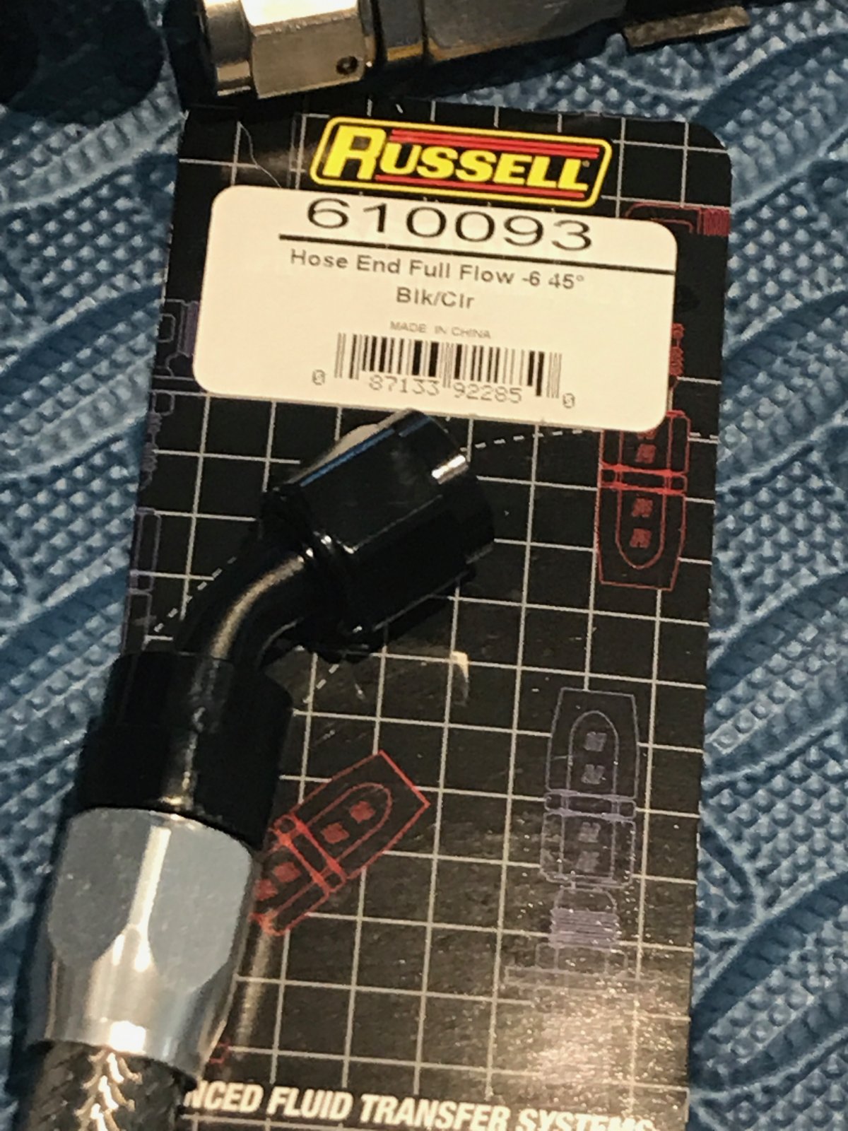

The Oil Cooler ends:
1. Work the line adapter onto the line and twist clockwise until it is mostly seated. Grab some large pliers or vice grip, squeeze the coupling to finish a few more turns while you press down on the end with your palm until the hose is fully seated.
2. Place the line adapter into a vice ( protect the aluminum with some magnetic nylon vice attachments)
3. Thread the line fitting until snug. I used an open end wrench to snug the two parts until they were flush and the faces were aligned.
4. I used a 45 deg (lower) and a 90 deg (upper) coming off the oil cooler

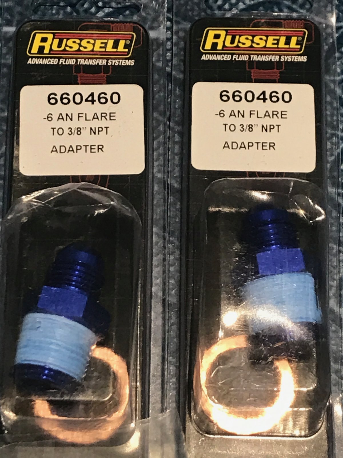

Filter Housing Line Ends
1. Same process using the adapters listed above
Filter Housing Inserts
1. Once you remove the filter housing, you can remove the old clip adapters. I found it easiest to pull the entire housing, place it on a bench and do the work off the vehicle. You will have way easier access and it is not a bad time to replace the gasket.
2. I prepared the fittings to save time in the garage.
3. I found I had to put the assembly into a vice to properly seat these. I just used a crescent it was perfect.
4. Couple the hose AN fitting to the housing. Again, the vice came in very handy.

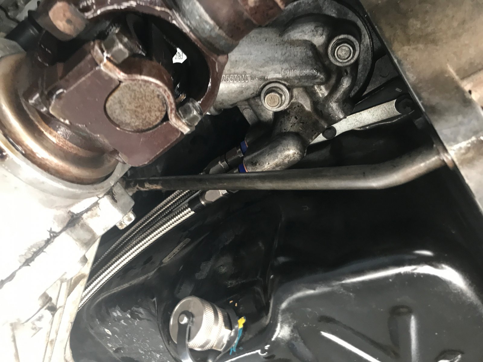

1. Remove lines from Oil Cooler and pull the fully disconnected lines through the front of the frame.
2. Install the 20x1.5 fittings into the oil cooler
Install Filter Housing
1. Since the lines are now installed onto the housing, I followed the path of the original lines and maneuvered the housing into place.
2. place the gasket onto the housing interior with some oil to keep it in place.
3. run the bolts through the housing and gasket to keep it aligned.
4. Tighten the filter housing

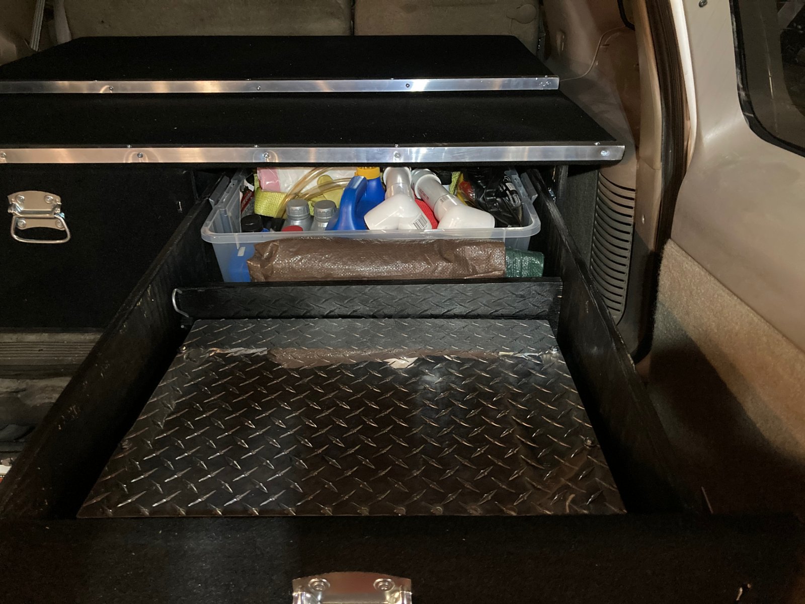

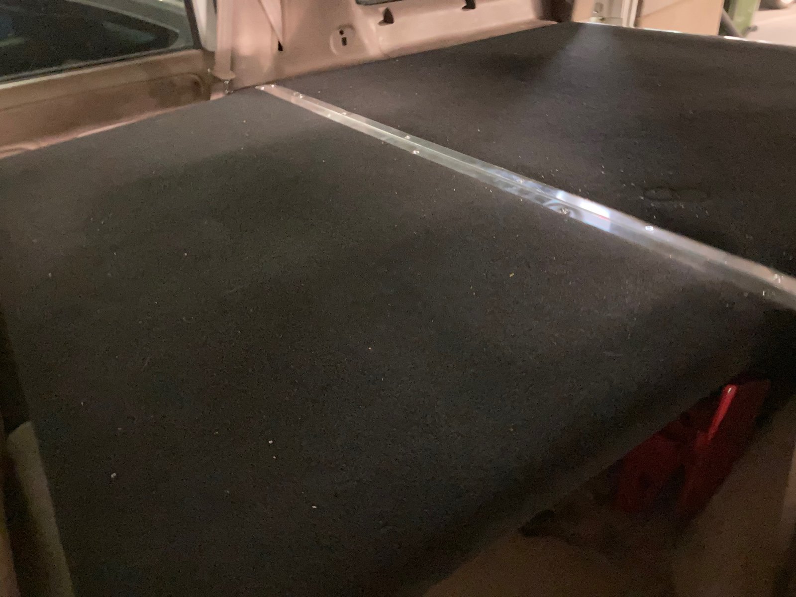

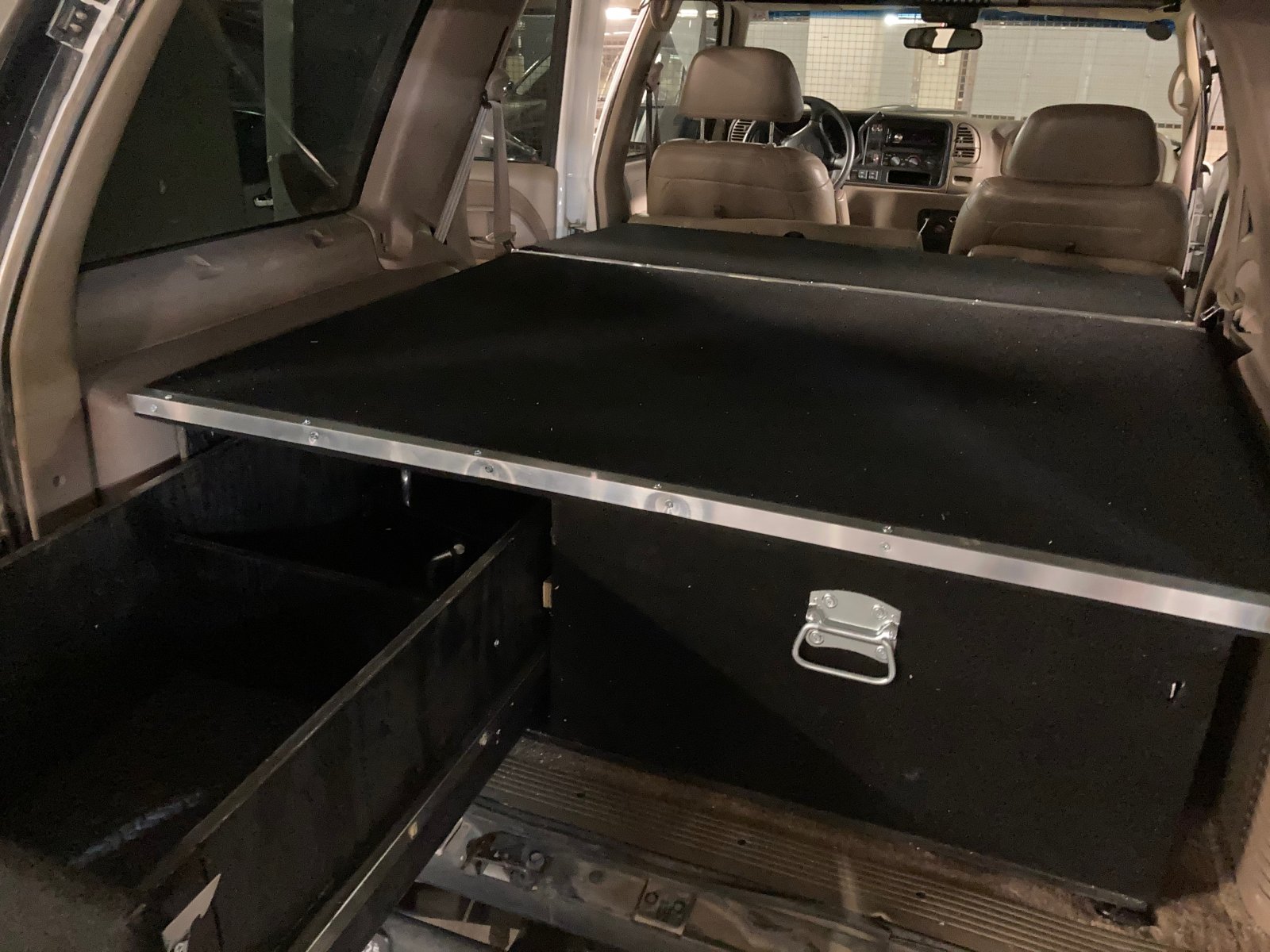

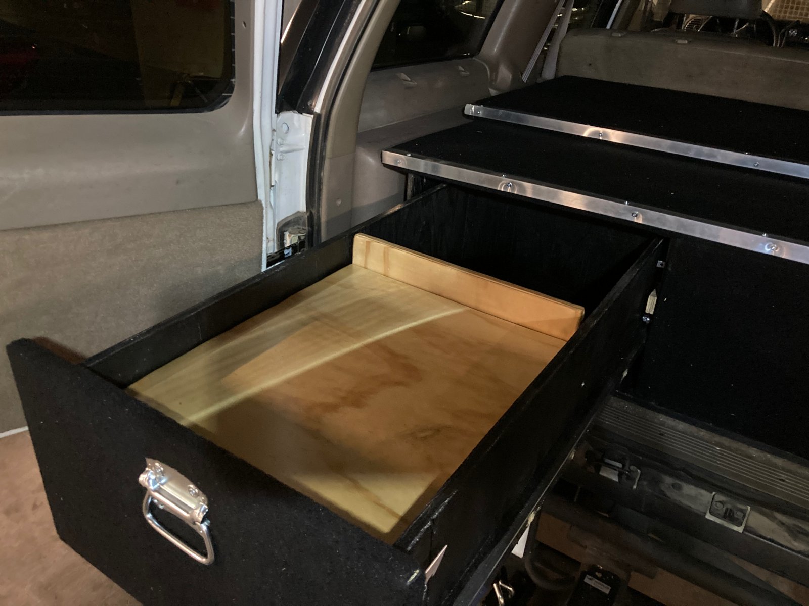

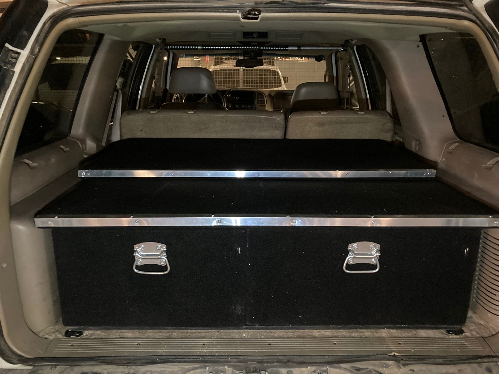

Sliding Truck Drawers
Ahhh... my much desired sliding drawers. Back in 2015 (or so), I built a fast-built sleeping platform and storage solution. It was solid but left me with precious little space after I added a thick sleeping pad. Plus, who doesn't want some pull out drawers?
My real goal was to have (a) a sleeping platform and (b) a convenient kitchen that did not require a huge setup time but with the desire to also keep the back seats in place.
The sleeping platform drove the concept with 12" high drawers to maximize sleeping space but no question it minimizes the storage space for additional items.
I spent a few weekends overhauling my sleeping platform and thanks to some YouTube ideas, I built the following:
The upper platform slides out to complete the sleeping platform.
Drawers are not of equal size to allow for different storage sizes.
The food prep area and custom cutting board are on the left. The right side is the stove platform, recovery gear and essential fluids. Many of the tools and hi-jack are between the back of the platform and the back seat. Pics of this coming soon...a work progress.
The metal platform is on coffee table hinges to allow it to lift up for more room and to access the gear below.
So there you go! More pics to update the build, the sleeping platform and the stove installed.
