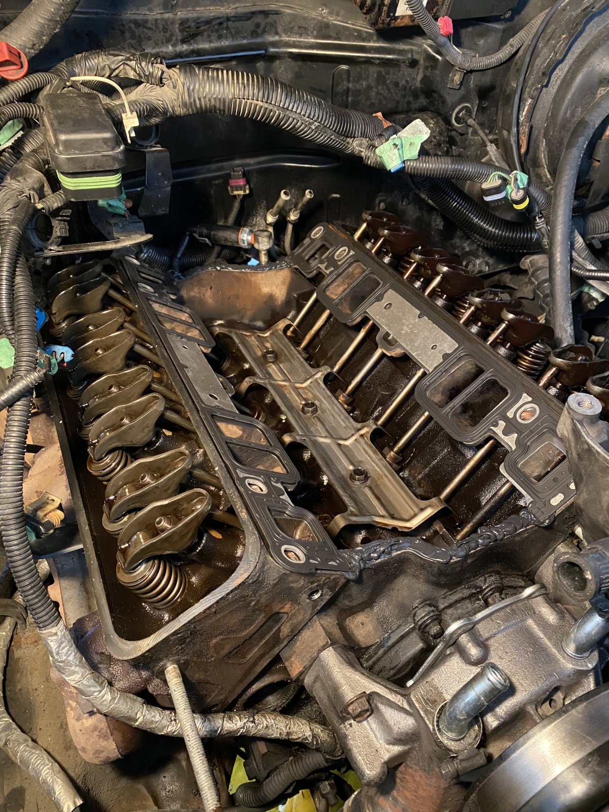

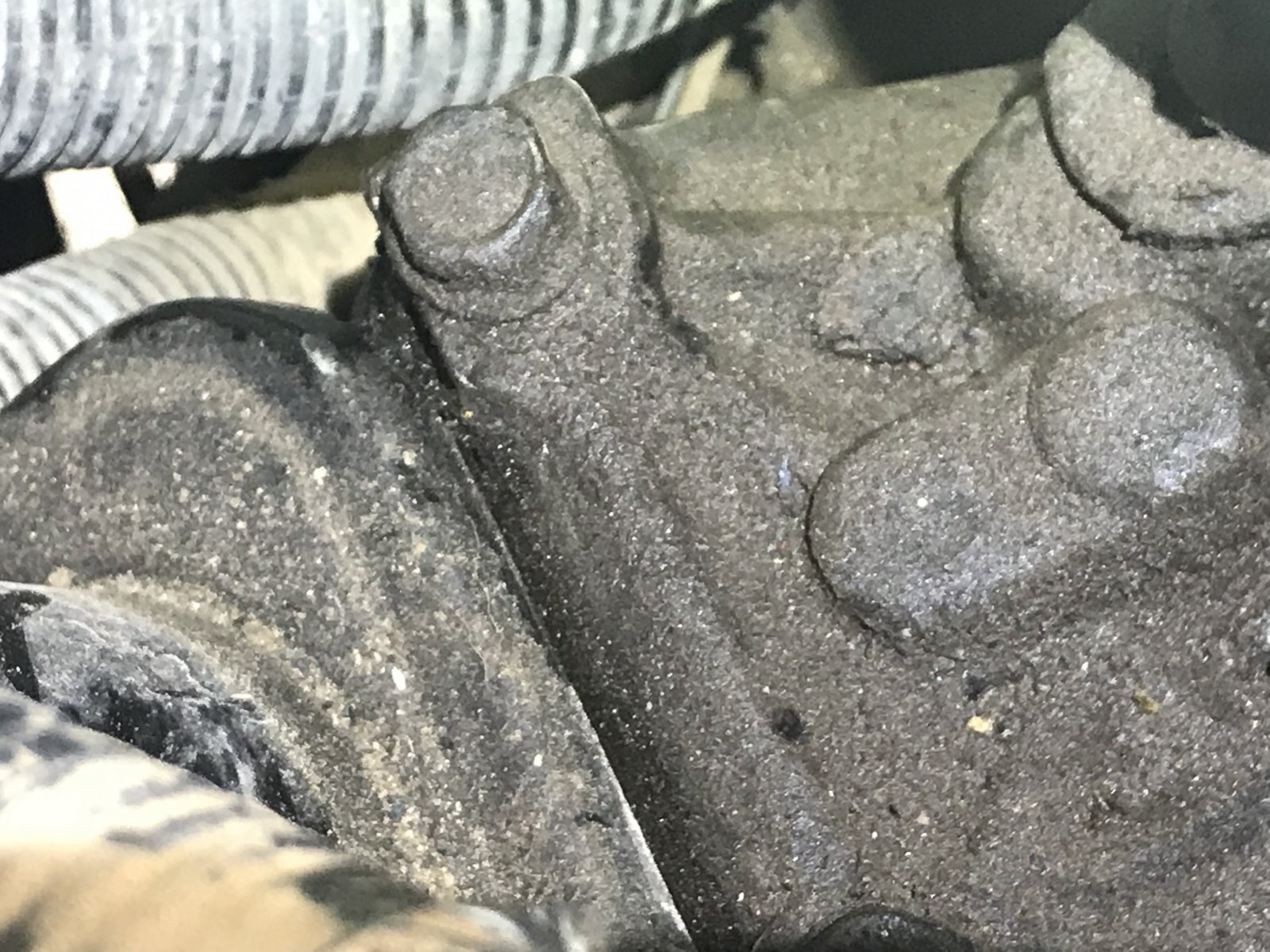

Hey guys, Question time. I have a 5.7 Vortec I need to do the intake manifold gaskets on, never done it before. On the left side of the picture is the valve cover, right side is my manifold. Leaking pretty hard too! I do think I need to reseal my oil pressure sending unit fitting, because it does look like some's coming from there, but there's three different spots on this manifold that I can see oil seeping out of, so it's got to be done, (Both valve cover gaskets are replaced.) I wouldn't have known really about this if some very friendly folks didn't help me out on this site.

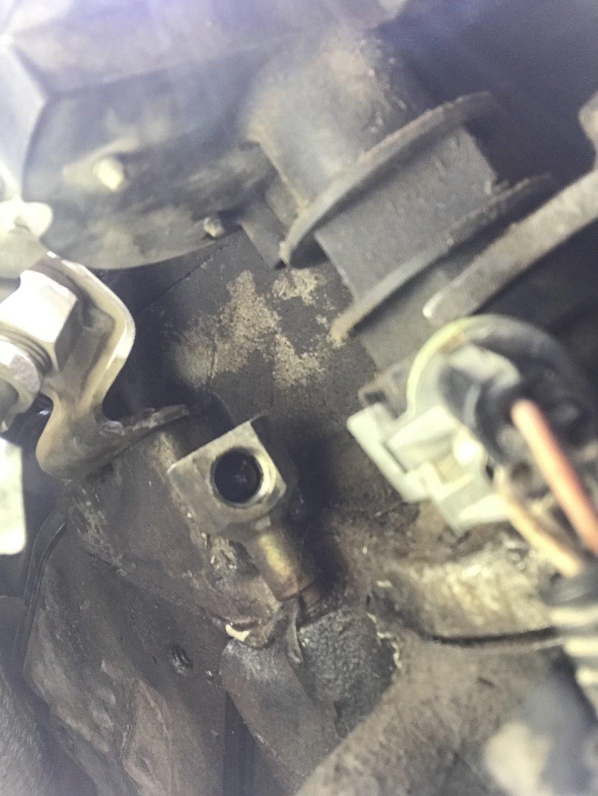

The second image is my Oil pressure unit fitting, at first glance I thought it was Teflon tape that was hanging, but it looks like its RTV from the intake manifold. If I didn't have multiple spots away from this fitting, I'd just take it out along with the distributor and reseal it really well and test it throughout the days. Unless oil can travel upwards, Gaskets need to be redone.

Check spider bracket not bent,Use felpro gaskets, maybe a little more RTV than comes in tiny tube with kit, order the 10 mm upper intake studs and nuts, almost always overtorqued and stripped. Every chance you get, take pictures for you. When you think you are ready to install lower manifold, Double check everything, bolts in proper order, necessary tools ,everything organized,then clean it again where gaskets and sealant go. Wash hands, Rtv in corners, intake gaskets, RTV in corners again with front and rear squirt, then intake goes on.Torque intake then take break and plan next steps. Good Luck!
When lower is off, look at cam and lifters as best you can. Be very careful with injectors.

I can’t remember what type of RTV sealant I used on the front and rear walls. Hopefully one of the members can chime in. Lay it on thick, and run it up to and under the edge of the corner of the new gaskets. Let it rest and skin over before bolting it down.

I can’t remember what type of RTV sealant I used on the front and rear walls. Hopefully one of the members can chime in. Lay it on thick, and run it up to and under the edge of the corner of the new gaskets. Let it rest and skin over before bolting it down.View attachment 378133
I like that RTV to be a bead laid on the outermost half of that flat metal surface you show in the pic. The reason is that when that is all bolted down and torqued, that RTV will spread front and back and if the bead is more toward that outer edge it has less chance of getting dropped in to the valley there and mixed with oil and then clogging the oil pickup tube screen. Again, only IMO.
