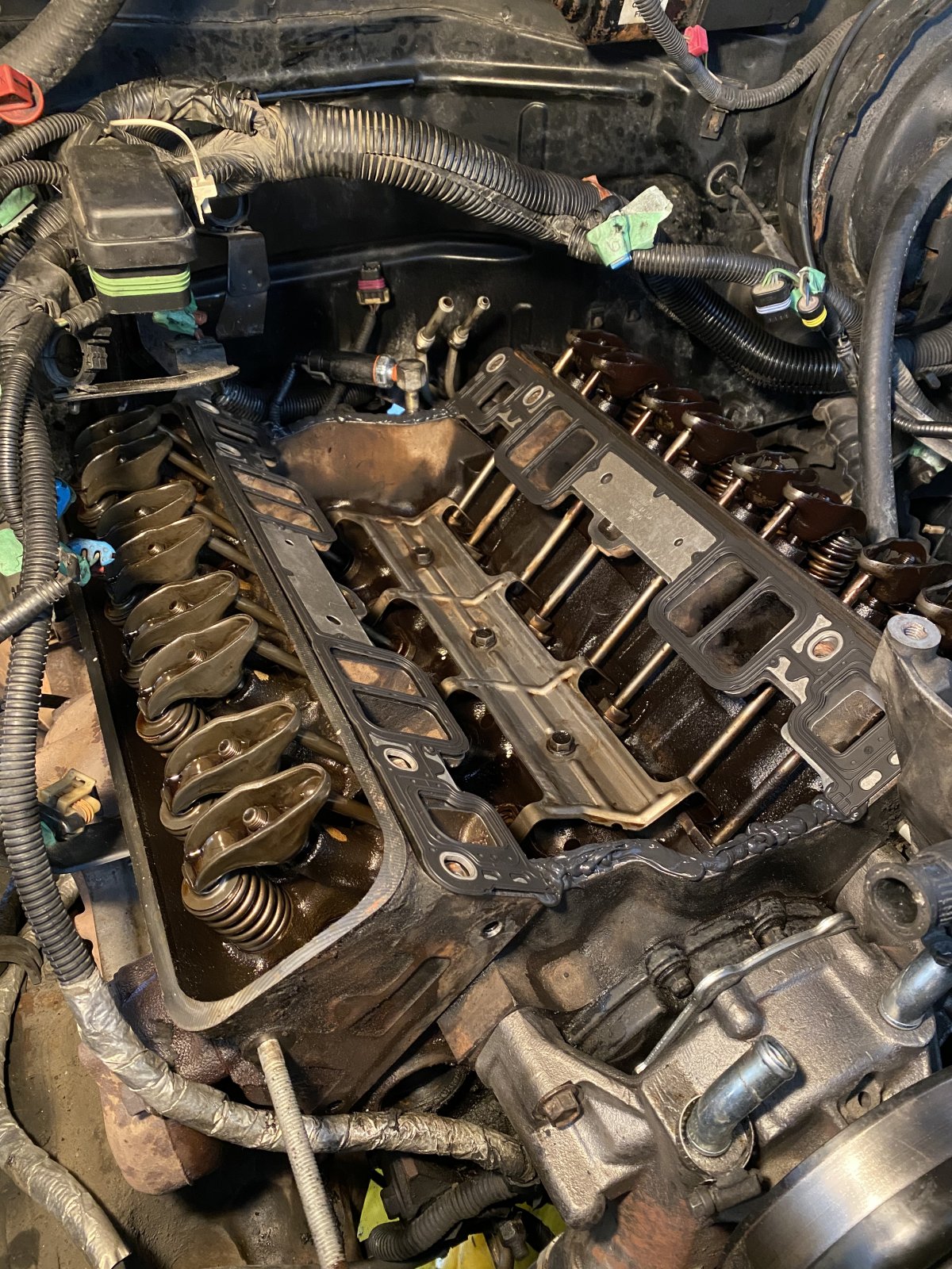

YukonGTmaster
2 Door w/ Barn Doors Club
Mar 18, 2021
601
1,273
I would suspect the rear wall as well. When I did my lower intake gaskets the Youtubers recommended carrying that sealant bead up the wall and just under where the edge of the manifold gaskets squish down. Have you considered adding some dye, and checking with a UV light? I would also look at the warranty on that motor.
