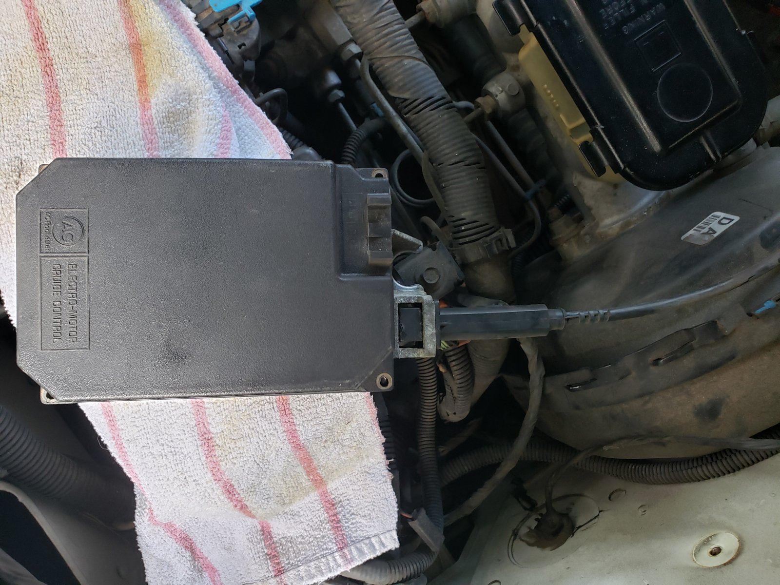

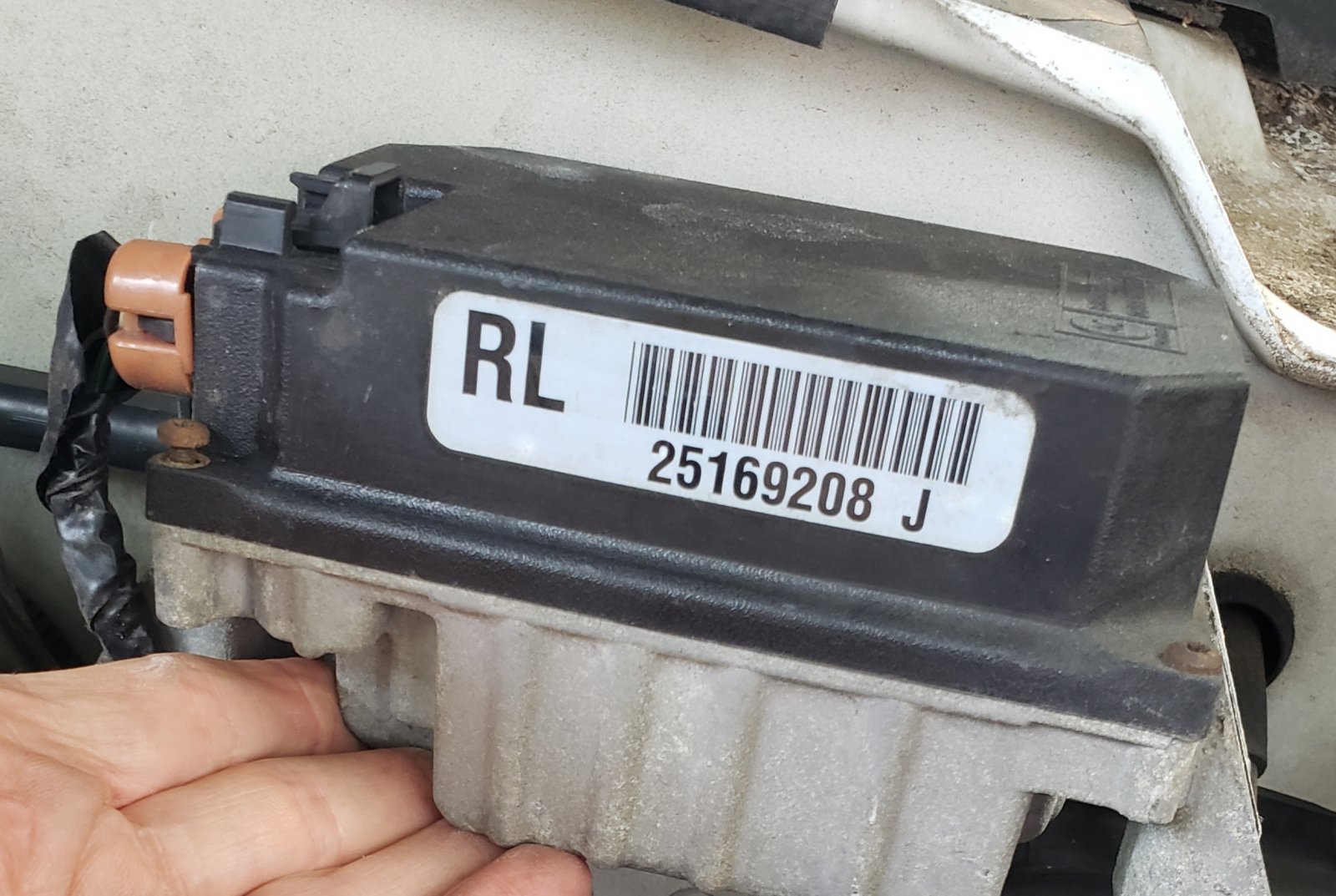

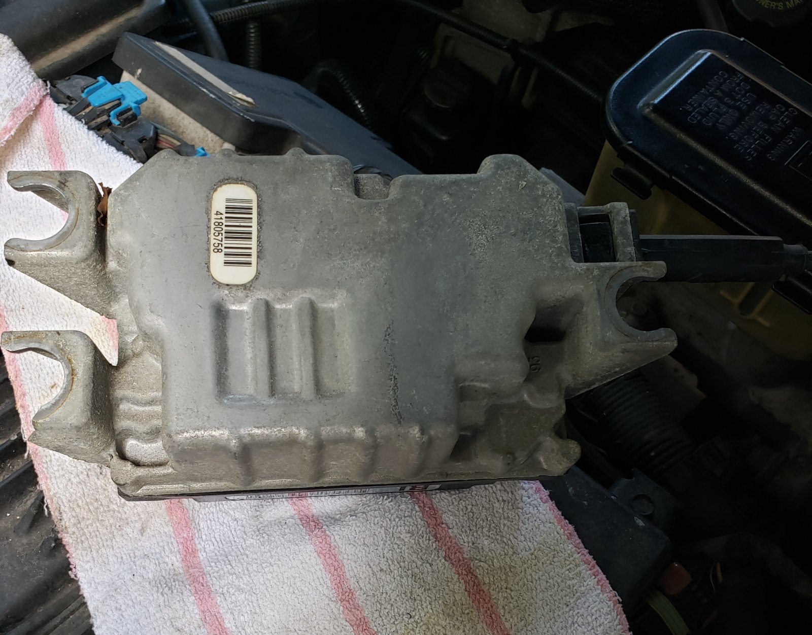

Hello forum friends. Back here with another issue with my 97 Tahoe 4x4 5.7. This weekend while crusing along at around 65 mph with my cruise control engaged, the gas pedal suddenly released from its holding position and the cruise control was no longer holding my speed. I was unable to re-engage the cruise until about 20 or 30 minutes later on the trip when I was able to set my speed and the cruise would hold. This engage followed by unexpected disengaging continued through the weekend and seems to be a new issue. I am assuming my Electro Motor Cruise Control module is failing but I suspect a brake pedal cruise disengage switch malfunction could also be the cause. Any guidance here is greatly appreciated. Pictures of the cruise control module are attached. Thanks

SOLVED: Replaced the cover/control board inside the Electro Motor Cruise Control module with a used cover/control board of the exact same Electro Motor Cruise Control model # purchased off E-Bay and the cruise now works properly. So it appears that the issue was a failed control board.
