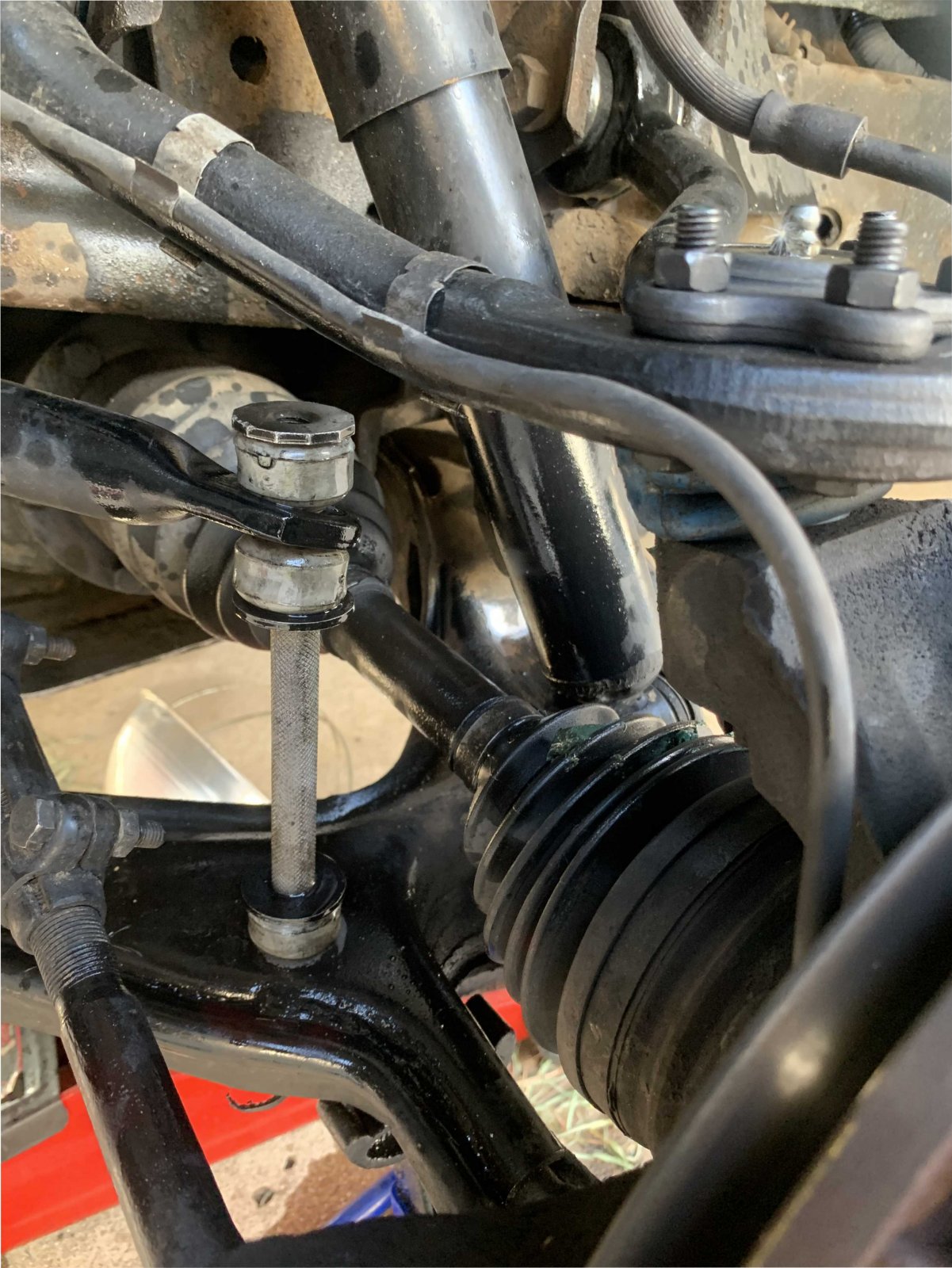

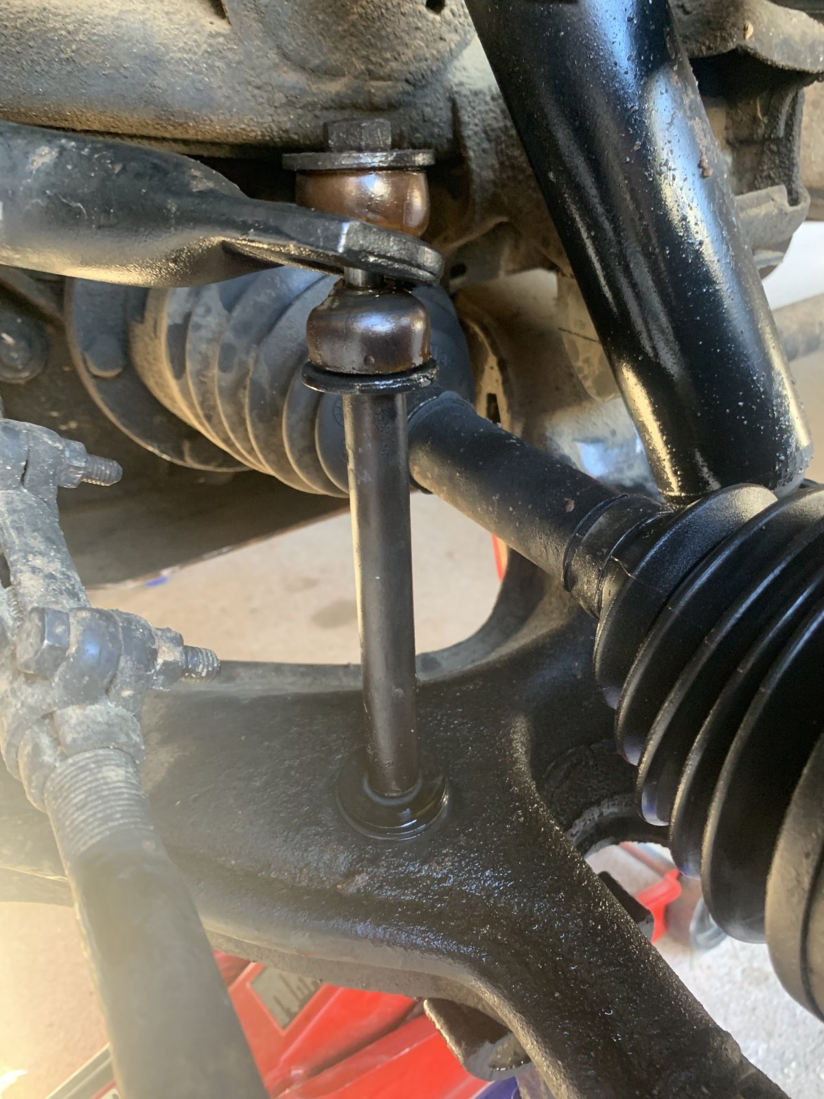

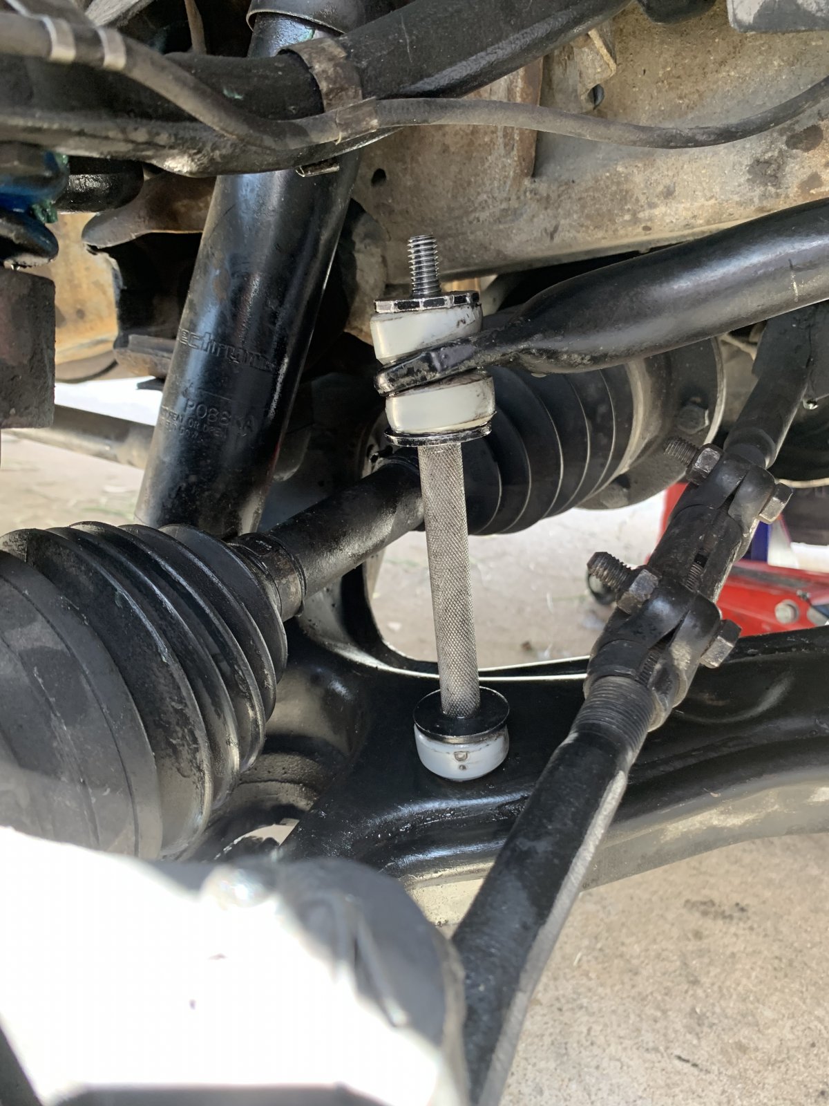

Well straight forward and simple haha. I got it installed did not bust any knuckles but the underside of my ride needs some major degreasing
So here are a couple questions - I had already purchased and started installing before I got your suggestions- I bought this one Dura Last Gold .
1. It said to install it a certain way to make sure you put the part with the barrel nut through the sway bar, I never assume anything so I looked and relooked and to me that was the top- and the bottom part is what goes through the hole in the lower control arm (the one with the plug in it) . Is that correct ? I am terrified of screwing this up.
2. Getting the torque correct. I have not used a torque wrench before I bought a click one and set it and all to what the package said but not knowing exactly when or how it clicks is stupidly a mystery to me. If someone could clarify it. It seems that it is way way too tight if I try to wait for it to click. I do not want to squish my bushings before i get started. It also feels tighter at the top than the bottom. There was a sleeve at the bottom that goes between the two bushings inside, then the middle sleeve and at the top the barrel nut acts as a sleeve - but even though it is tightened from the bottom it seems to me its tighter up top If I dont tighten it then the washers are loose.

On the torque wrench, you’d hold the top hex of the bolt still with a wrench and tighten the nut in the hole in the lower control arm. You’ll hear when it clicks, try on some spare nuts/bolts to get a feel for it. Hold the wrench at the knurled end (don’t choke up on it) and go slow. Going by memory, these are set at around 30 ft-lbs (double check that) so you aren’t going completely animal on it.
GM installed the end links with the bolt head on top and nut at the bottom through the lower control arm. It’s a pain to get it back into place unless you loosen or take off the sway bar brackets, so some put them in with the nut on top feeding the bolt through the bottom.
If you do, just make sure the exposed threaded portion of the bolt isn’t hitting the upper control arm at full suspension travel. Cut it down shorter if you go that route, but I’ve always just dropped the brackets off and saved the neighbors the bad language.
Here’s one video that shows the stock configuration…
And a re-install at 26:20 into this one…
Good luck, I hope this helps.

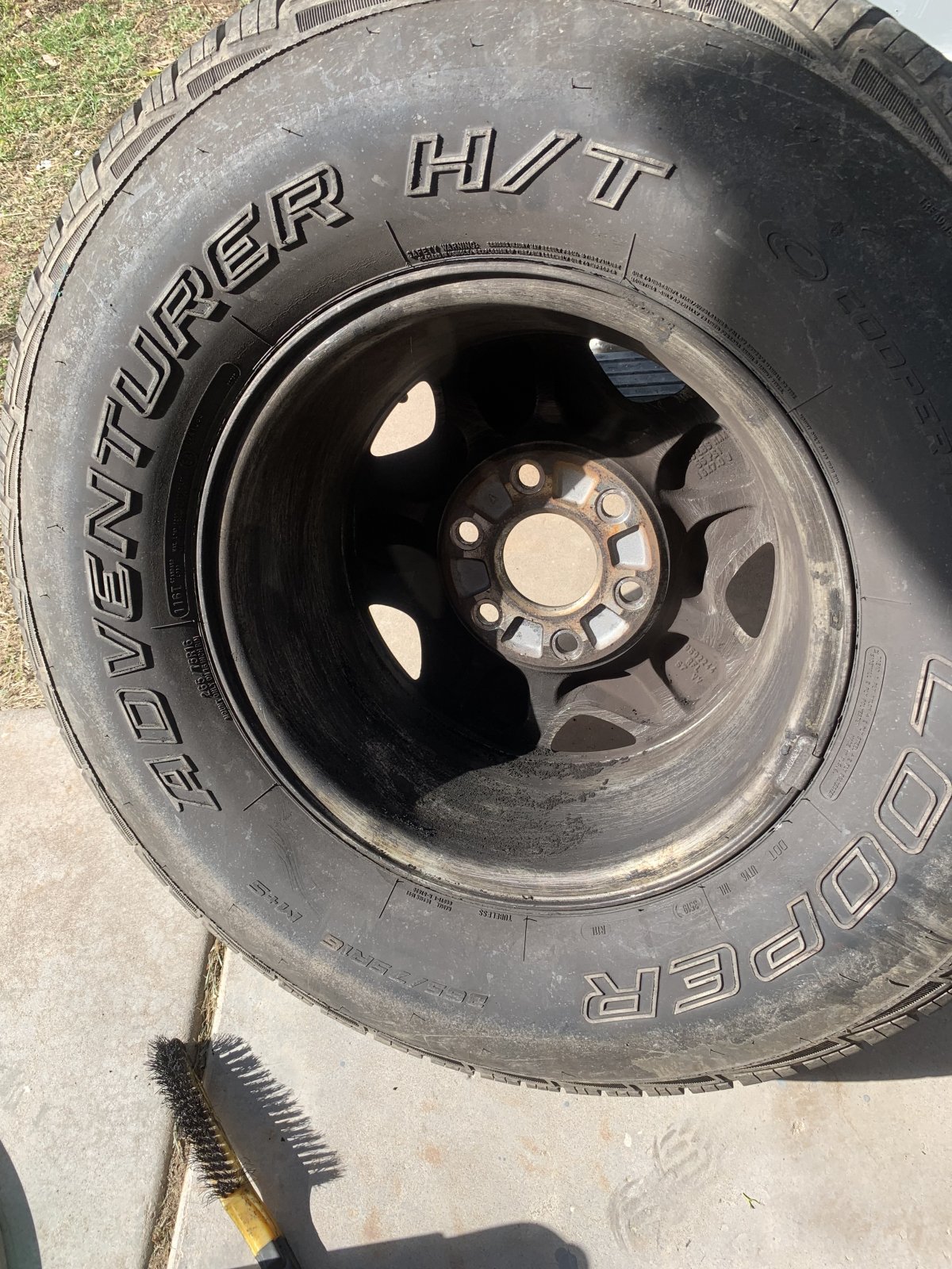

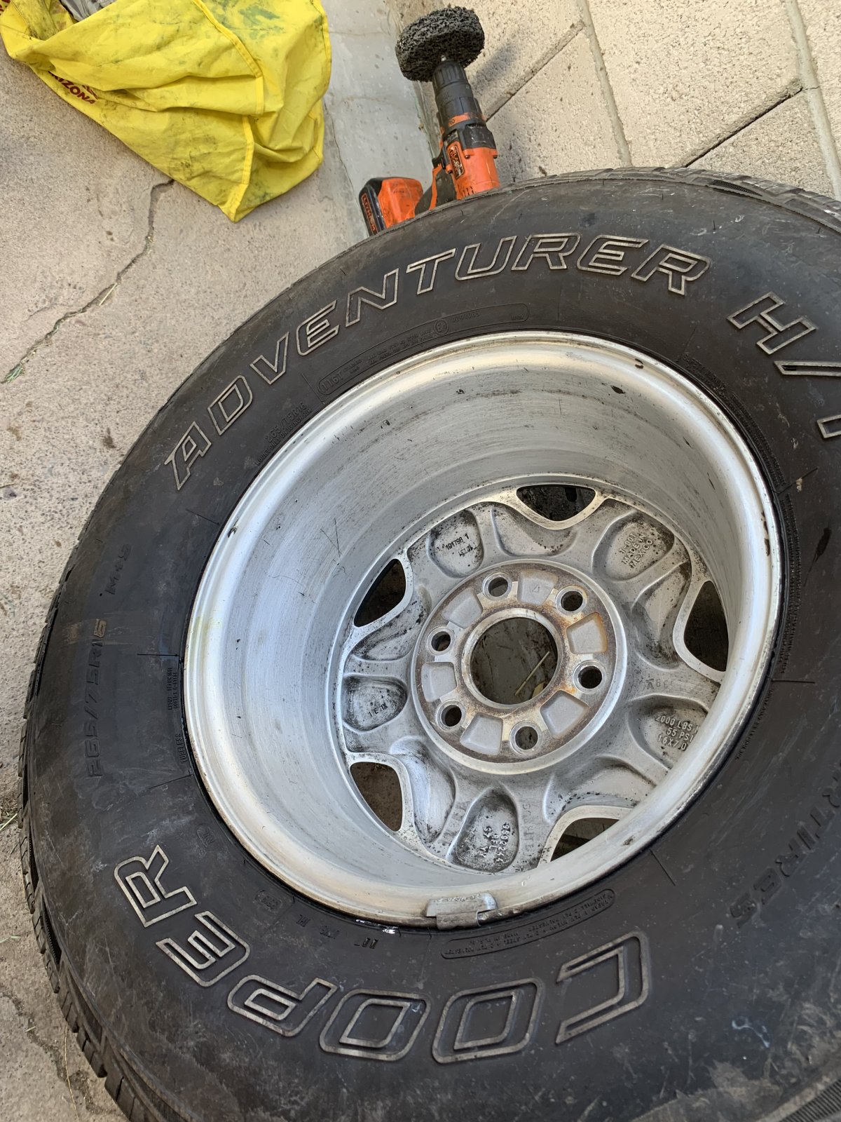

Finally got both sides done, took it for a test drive tonight. Made me rather nervous to think I had put this back together. However, it ran smooth, stopped straight, drove straight, and did not make any noise. This is the first time that I have driven it without it sounding like it was coming apart! The only noise I could detect was the bit of the rattle that the stock caps make on the wheels (the ones with the plastic nuts ).
I survived having to do this with jackstands and my hydraulic jack - I am always nervous under the vehicle. Somehow I think it must be much easier to do this with the vehicle on a lift!
Thank you by the way here is the passenger side, and a couple shots of before and after of the disgusting front wheels, (had no idea till I removed them)IMG_2980.JPGJCTY5557.JPGIMG_2940.JPG
