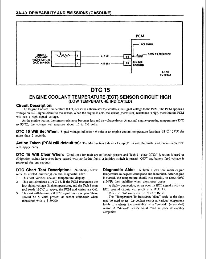

Here is the diagnostic for DTC 15, maybe it will help. I’d also check that resistance when the engine is hot (194-F on the table) - I assume the 3750 was observed when cold.

Thanks for the manuals I had some of those but not all of them. I am still leaning toward an out of range after market sensor. As per the chart at 15C temp it should be 4450 but I got a reading of 3750 this was in the truck. I pulled the sensor and tested it to see if the values went up and down with different temp water which it did. But when I tested the sensor using different temp water samples the readings were out of range leading me to think the non OEM sensor is skewed. I tested it out of the truck in 10C water and got a reading of 4600 and it should have been 5670.
I have an AC Delco sensor and new connector arriving tomorrow so we will see. In the diagnostic aid it says "the temp sensor resistance value scale may be used to evaluate the possibility of a skewed (mis-scaled) sensor" I think that may be the case here and so when I go to restart it is hard to start because pcm is getting the wrong value from sensor giving it a rich fuel mixture. Holding the peddle to the floor works to start it and after idling for min it runs okay again. It keeps throwing the dct15 code which at least to me indicates a coolant sensor or sensor wiring issue. I am going to back probe the yellow wire once all back together and up to operating temp and see if my voltage has dropped from 5 volts to 1 or less volt like it should.

Yeah, the resistance values do look suspect. I’d wonder how they compare in hot water to simulate a warm engine. If you had access to a scanner I’d guess that the computer is getting a completely off reading from that sensor.
