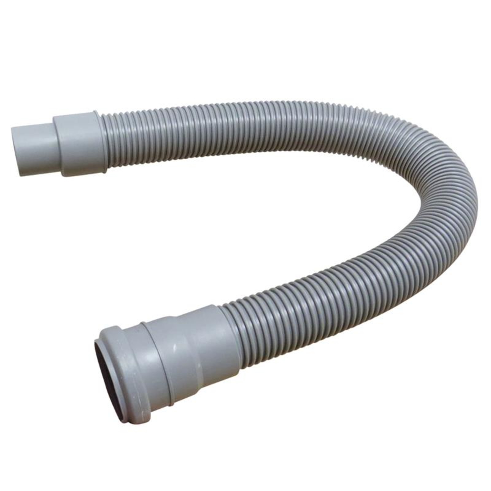

I've been using something like this for years.
You stuff something into one ear, hold the pipe to the other and use it to go through the engine compartment. This means you can hear very clearly where noises are coming from.
Better than using a stethoscope, which is more suitable for finding sounds that take place deep in a solid material, example the engine.
But for finding noices outside the engine, for example in the beltdrive, this is very suitable.
