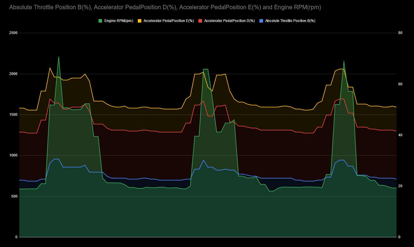

Welp I finally go to starting the truck up and logging some data, I have a complete CSV file if anyone wants it. idk any good CSV viewers so I slapped a terrible one together in google spreadsheets, idk if any of these graphs are useful at all. I noticed my oil pressure gauge displays 80 psi and goes down to like 60-70psi once warm but the ECU was displaying about 34 psi. I also noticed if I rev'd to around 2000rpm for a couple seconds and let off, it'd stay at that rpm and maybe even gain a little rpm and then go down and the idle would fluctuate around 400-700rpm
