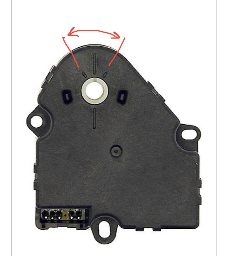

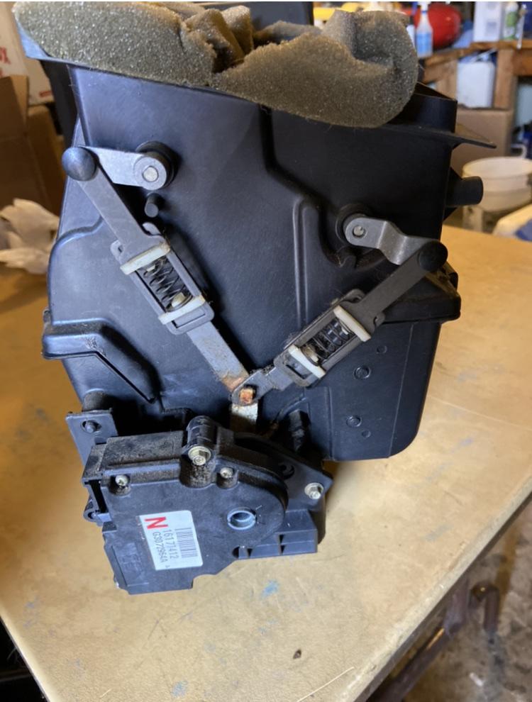

Vent selection actuator is the one by the gas pedal. Going by memory, I think it controls three dampers in the box to control defrost, panel and floor vent distribution.
Look and see if the two linkages are intact. Also watch the silver notched dial as you change the vent position. It should rotate between the two lines imprinted on the actuator.

With the actuator in place, turn the panel dial from defrost to vent and see if the actuator linkages and/or the silver dial rotate. That would confirm that the panel is sending a signal to the actuator.
The silver dial should rotate between the two lines, smoothly without jumping back and forth.
If you have some movement from the dial, pull the connector and put a probe across the two pins. Rotate the panel dial and see what your voltage range is. It should change smoothly, not erratically.
If the actuator is removed, you should be able to manually rotate the dampers to check for air flow.

My memory stinks since it’s been a while since I had the box opened, but I think the defrost damper is up high toward the back.

Defrost is I think on upper left. The one in the middle (where the links meet) is I think the floor vent. Upper right is panel.
I think that’s right, lol.
